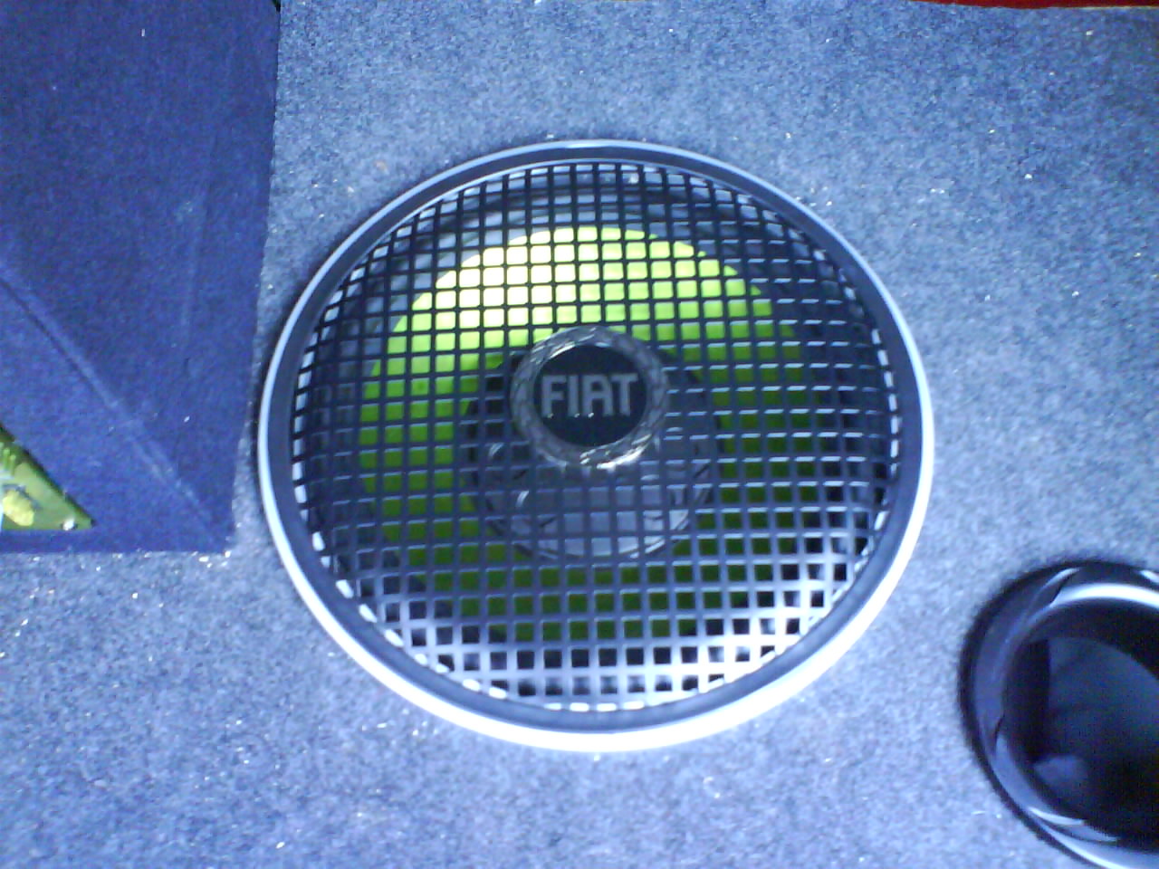

there you go mate

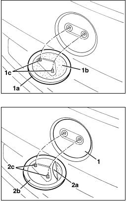

The front is very simple, just take the top grill out and undo the one bolt that keeps the badge.The back one....you have ( i think) to take the inside plastic cover of your boot out.
Its easy peasy(y)

1. Using a plastic blade, remove the badge (1a) unsticking the double-sided tape (1b) around the perimeter and releasing the centering pins (1c).
Refitting ( Removing )
- Check that the badge is not damaged.
1. Clean the housing for the badge, removing the residual adhesive and degrease with heptane.
2. Remove the protective film (2a) for the double-sided tape and place the badge (2b) in position, engage the retainers (2c) and fit it.
Removing ( Refitting )
- Remove the upper grille.
1. Undo the nut.
2. Remove the badge (2a) by releasing the centering pins (2b).
- Position the badge and do up the locating pins.
- Tighten the nut.
