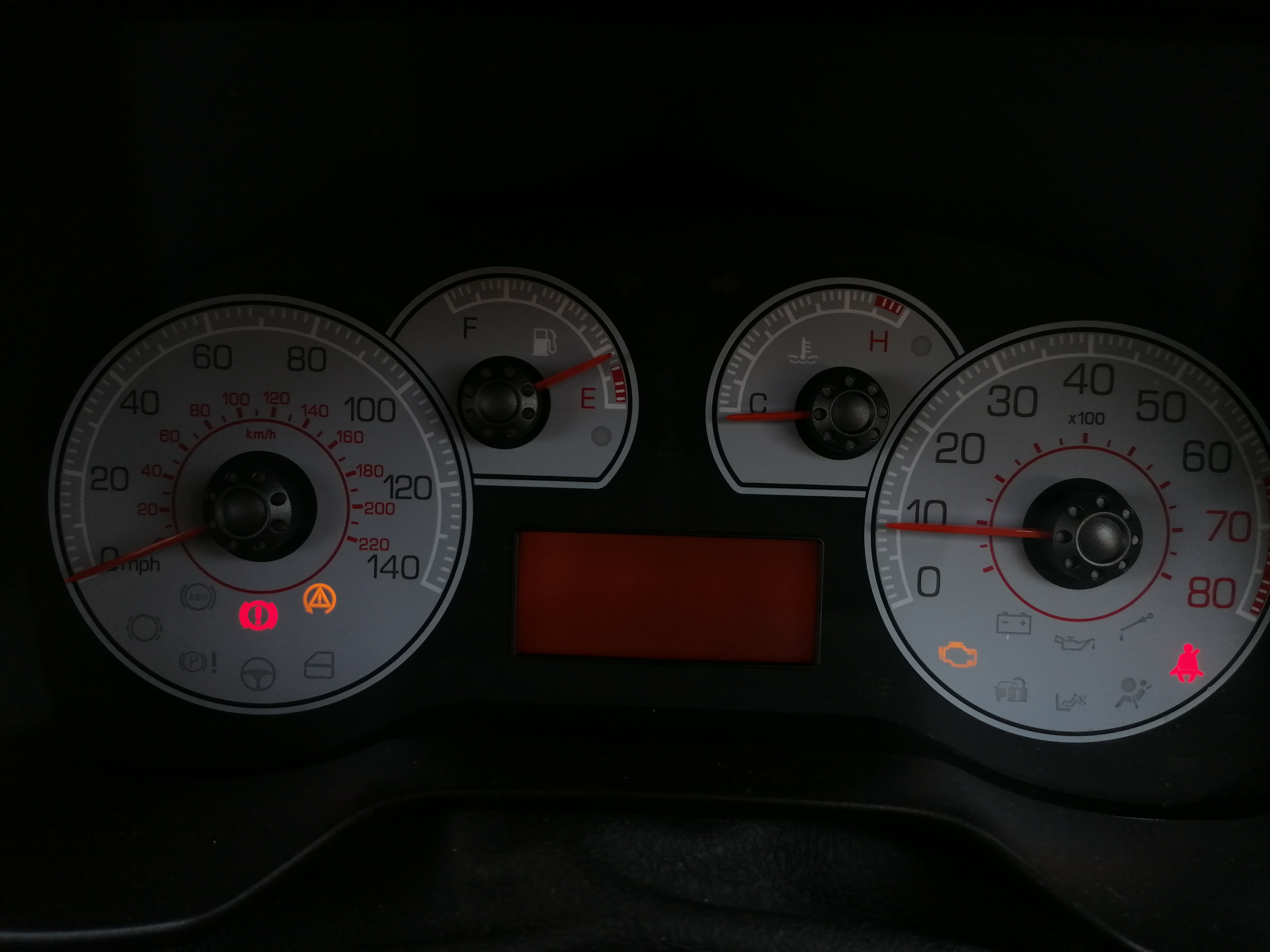

Does anyone know what the one on the left is the triangle one

Generic warning
Could be anything from failed light bulb to bad battery
It should say on the LCD screen what the error is in for
Okay what can you do if the led screen does t desplay it lights up the the walter pump has gone and the thermostat is wide open could that be why it's on?
If you are referring to the orange triangle light, it refers to ESP electronic stability program.

Okay thanks as you seem to know them better than I do and don't get me wrong I love my punto I have a 2007 plate 1.4 16v the water pump has gone and I think the thermostat has gone due to the engine over heating as the fan cuts in as soon as you start the car the engine management light is on now and the stability control light is on do you think changing the water pump and timing belt and thermostat with make the eml go out or will I have to get and obd reader the turn it off as the car is currently in limp p. S I'm not driving the car ?
It's a thirteen year old car, main question is, are you going to keep it? if so, get the water pump etc done. then get the codes read & take it from there.
