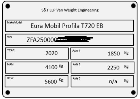

Simply incorrect; my current van is plated at 4100Kg with 1850 front and 2250 rear. 1850+2250=4100.
Many thousands of Bailey motorhomes leave the factory plated at 3850 with 1850 front and 2000 rear. 1850+2000=3850.
Nobody, least of all me, is saying that you can use all of that plated weight but the vehicle can definitely be plated to a GVW/MAM that equals the total of the 2 axle maxima.
