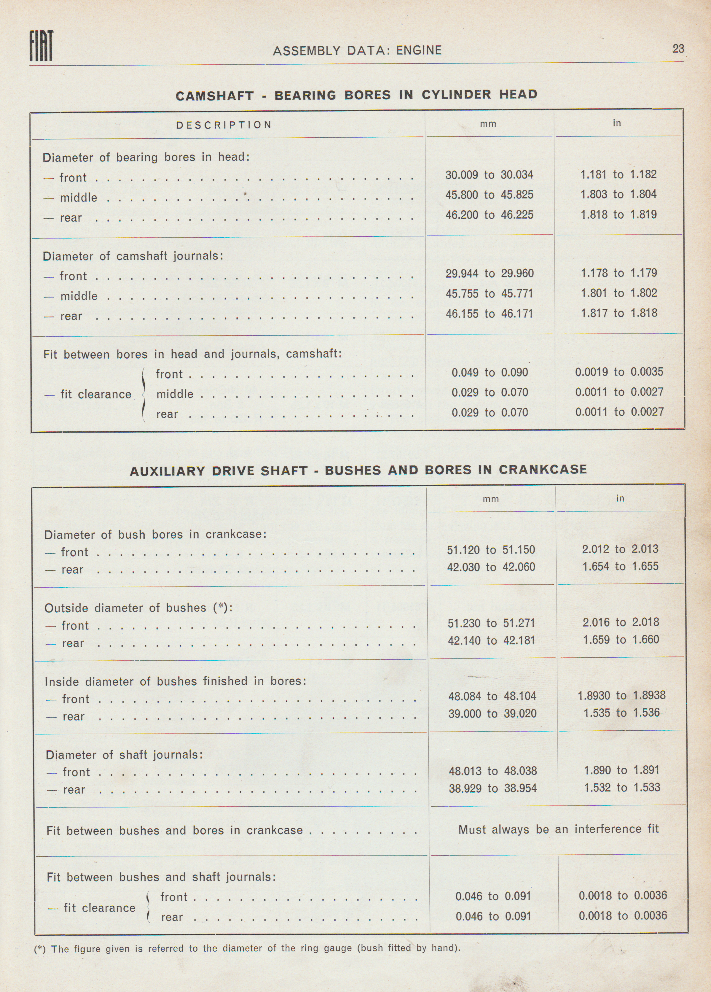

i have a 71 124 spider, attempting to rebuild. machine shop says my cam bearing journals are .002" over spec. book says to replace if excessive wear. How much is "excessive wear"? can i run these cams , or do they really need replacement?
Here's the factory specs:-
