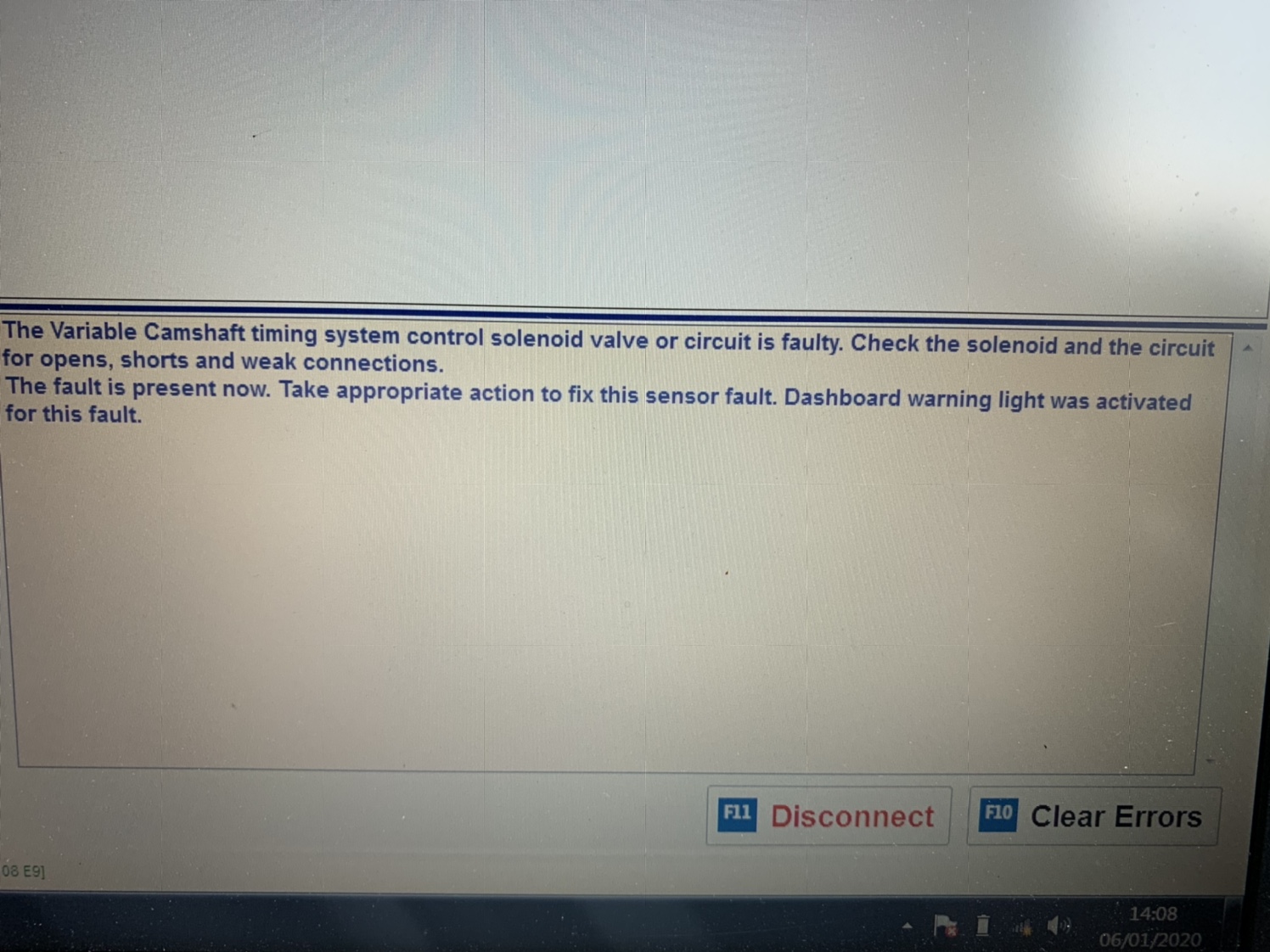

I’ve just had new cambelt fitted and I now have a camshaft sensor error. Nothing was disconnected.
The electrical connection from the camshaft sensor joins a loom which goes into the top of the case covering the cambelt. Anyone know where that goes. I’m assuming it’s a coincidence and that the sensor itself is faulty. But could it be something more sinister? MES screenshots below. IMG_3703.JPGIMG_3704.JPG
Well all the marks lined up. Would that do it?
You did use the locking kit? If so it should be a case of just doing the phonic wheel relearn, if not personally I wouldn’t do the relearn until I’ve made sure I’ve timed it all properly.
The 1.2 69ps is an interference engine.
sounds like it isnt advancing the timing corectly when running or at least i thinks it isnt
is there a sensor for the variable pulley position ?

Just a thought, the timing IS correct, ie not a tooth out?

personally I wouldn't want to run anything or try a phonic wheel relearn until I'd verified 100% that the valve timing is correct.
He didn’t have a locking kit but he improvised. He is a professional mechanic if that makes a difference? He works for Caterham building their cars.
The car seems to tick over Ok and drives ok until you put your foot down and it doesn’t accelerate away. That’s been pointed out that it’s a safety thing.

That's a classic sign that the timing belt has been refitted a tooth out.
He didn’t have a locking kit but he improvised. He works for Caterham building their cars.
Sounds to me like a good reason not to buy a factory-built Caterham.
Did the car run okay before the cam-belt swap (if it arrived on a trailer for example, you may not have noticed)... although the error light is on now, which it wasn't before, so I'm only asking.
If the light is on, then the performance might be sluggish to protect the engine. The 1.2 is pretty simple to time up without tools so the fella ought to have a better than decent chance that it's actually okay.
But best to check before proceding... either with a locking tool or just by TDC marks. It's too much of a coincidence that it's happened just now.
