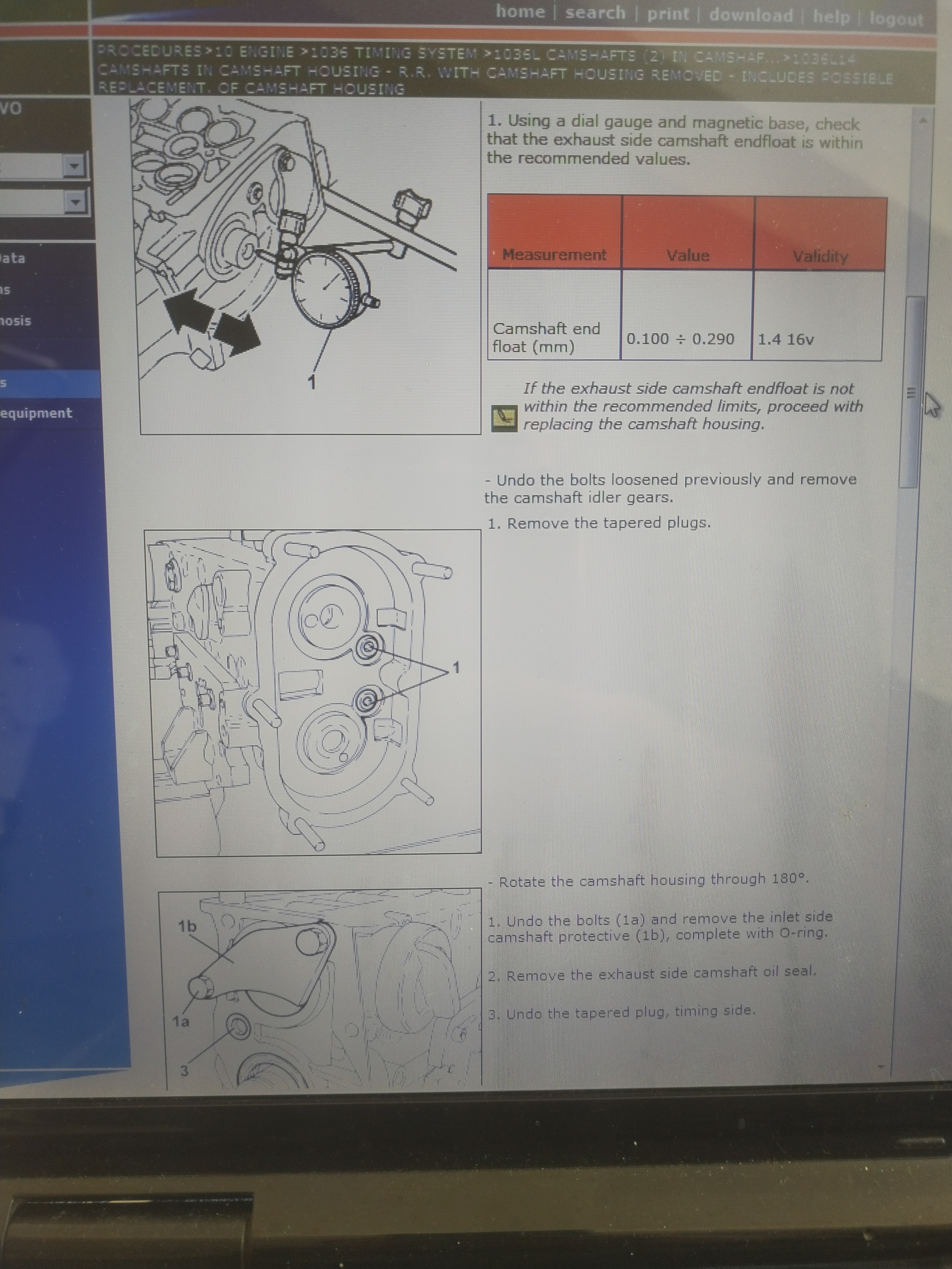

E Endri New member Joined Jan 3, 2021 Messages 8 Points 3 Nov 9, 2022 #1 I need to put the camshaft in right position for a fiat bravo 2008 tjet. Anyone has a scheme how can do it
OP OP E Endri New member Joined Jan 3, 2021 Messages 8 Points 3 Nov 9, 2022 #2 I have check this but is unclear how to put back all and 5he number 1) tapered plugs what they do Attachments IMG_20221109_105100.jpg 5.5 MB · Views: 53
