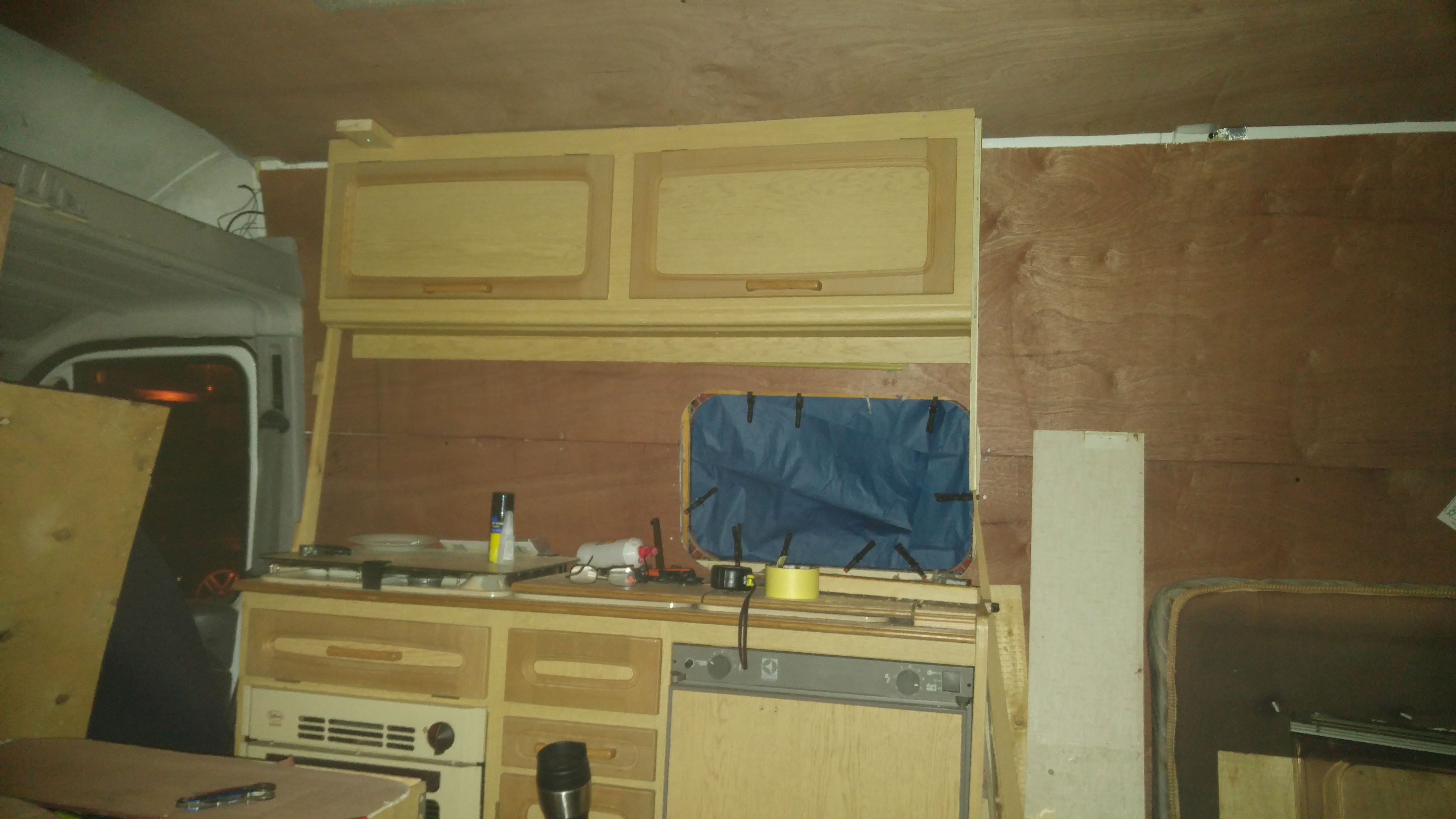

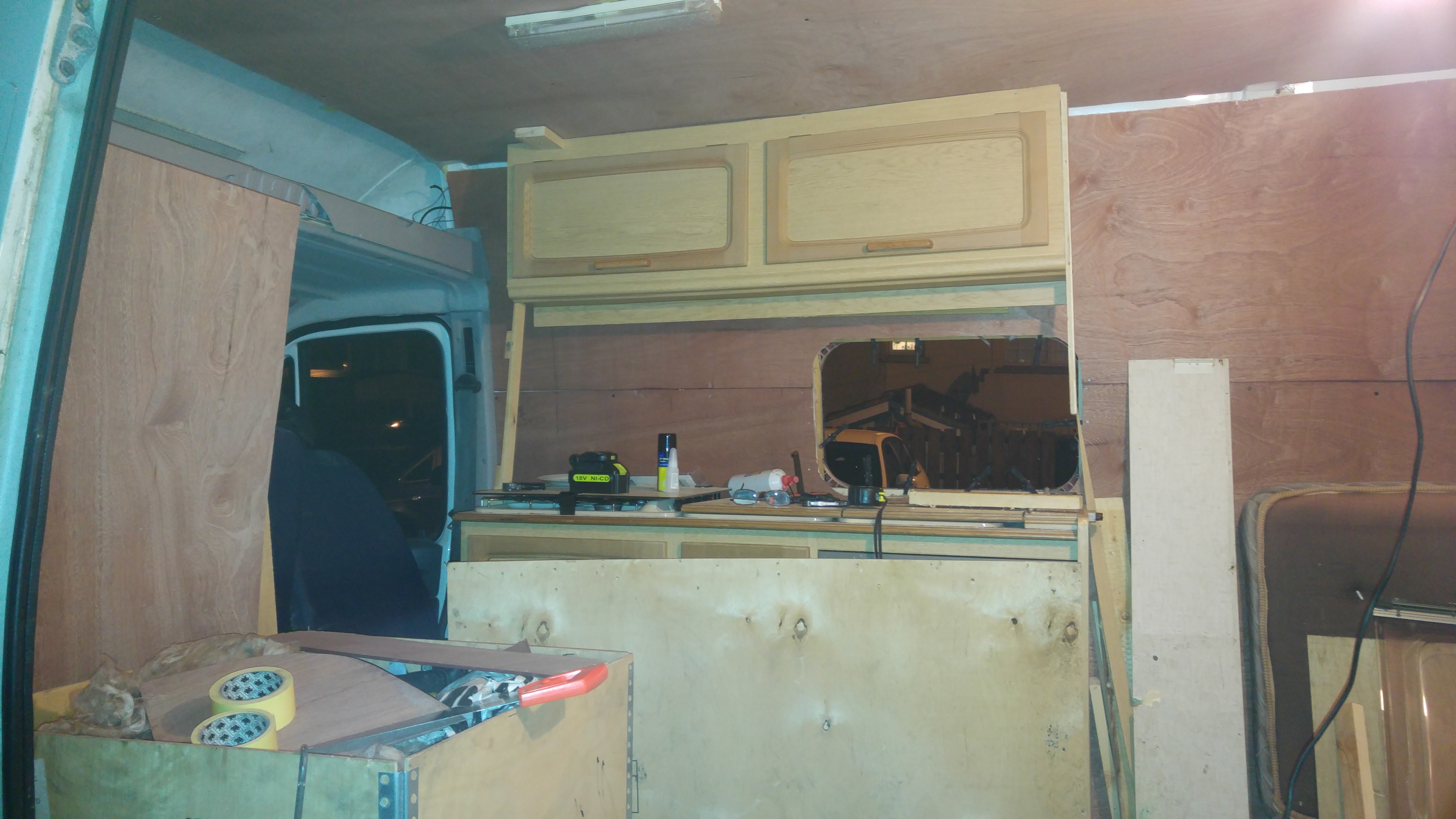

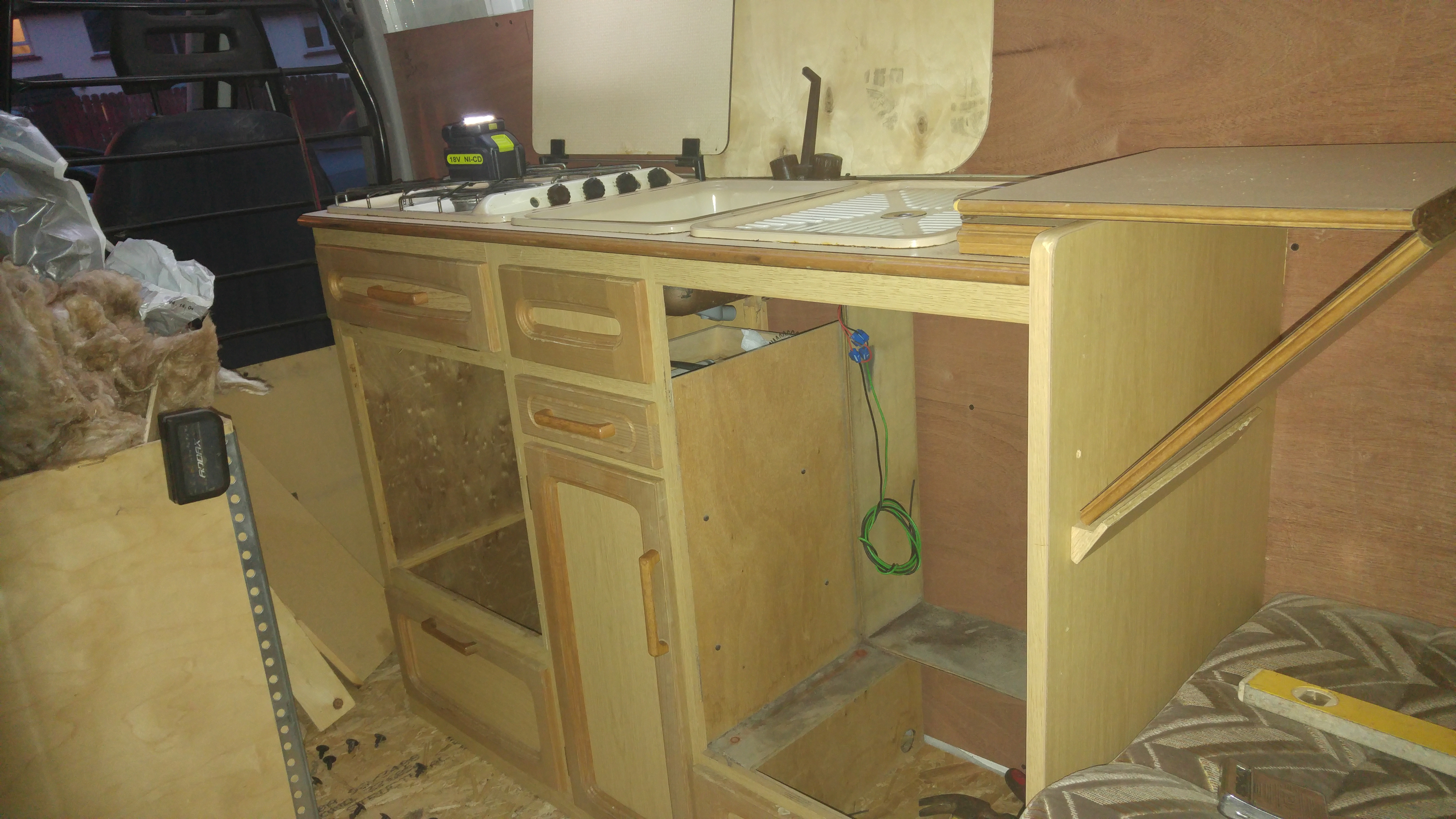

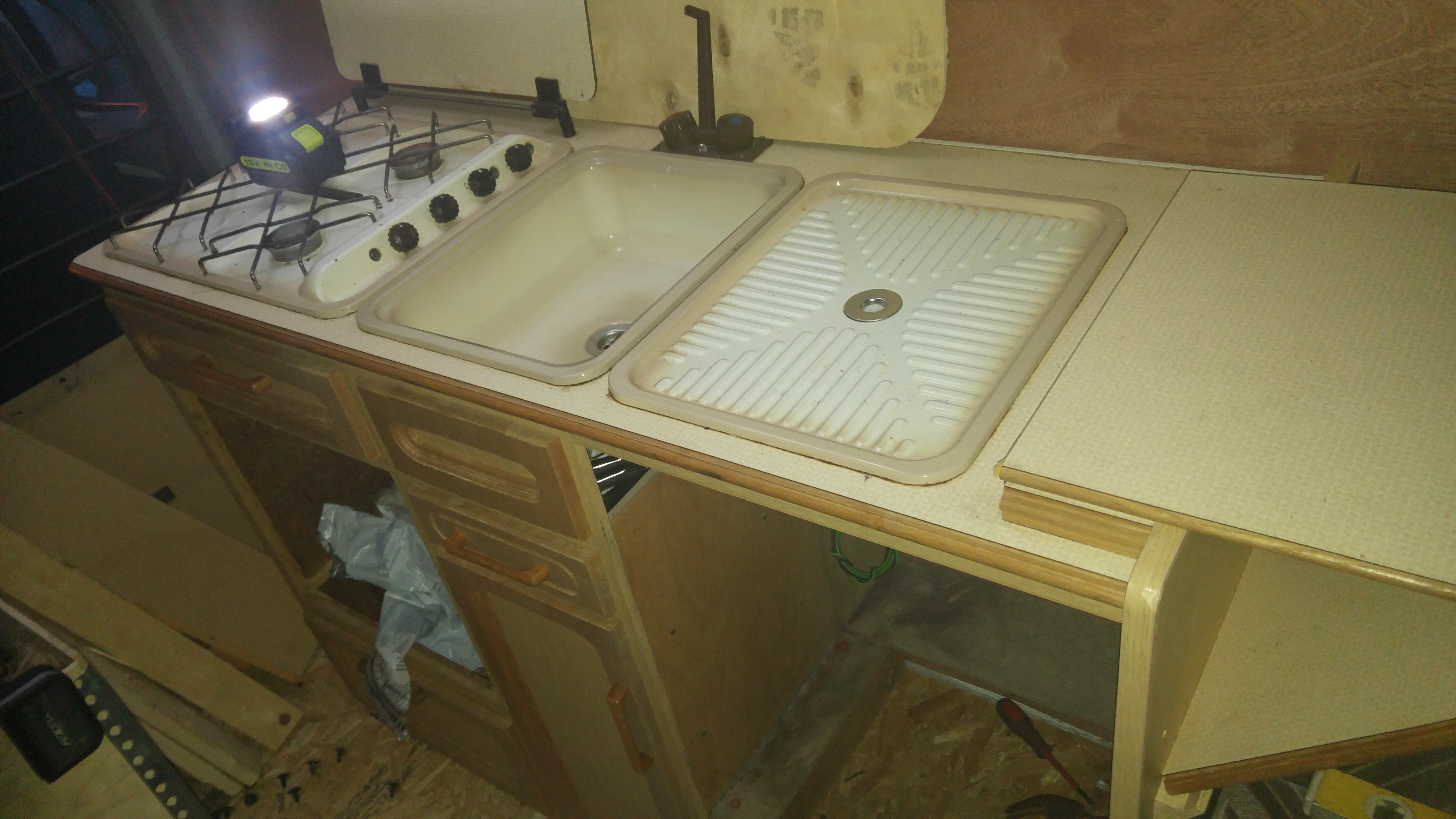

a few picks of my progress this weekend

thanks Andy
a long way to go yet..but that was done in a couple a days...buying an old caravan is the way to go as it saves so much time...
i will keep posting as things move on
Nice fitting, i have a swb low roof self conversion. Looks good in there with the kitchen n all. Always have to duck a little.
What are your plans for windows? I got a spare driver seat frame out the scrappy so its 2 in the front with a walk threw. Also got captains seats out of an old toyota people carrier, gives a lot more room when they're turned round. Keep up the good work an im happy to show n tell haha, Al.

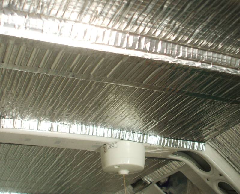

sorry i havent been on for a while and didnt expect my project to get such comments...now as for insulating my van i got some foil covered bubble stuff from homebase..£30(3 rolls) covered the whole van which seems to work realy well in sound proofing as well as the heat side of things.i didnt use glue but an aluminium tape that we use at work for covering exhausts that we put on our crushers.as for moisture/damp there was a gap of about 4 weeks before i started with the timber and there was no damp anywhere.i live in N.Ireland..rank weather and all seems good..Now getting round to the windows i hope this weekend but finding it hard to get a local supply of window rubber and dont want to use ebay as its rather expensive..bear with me i will update pics if i get any more done..

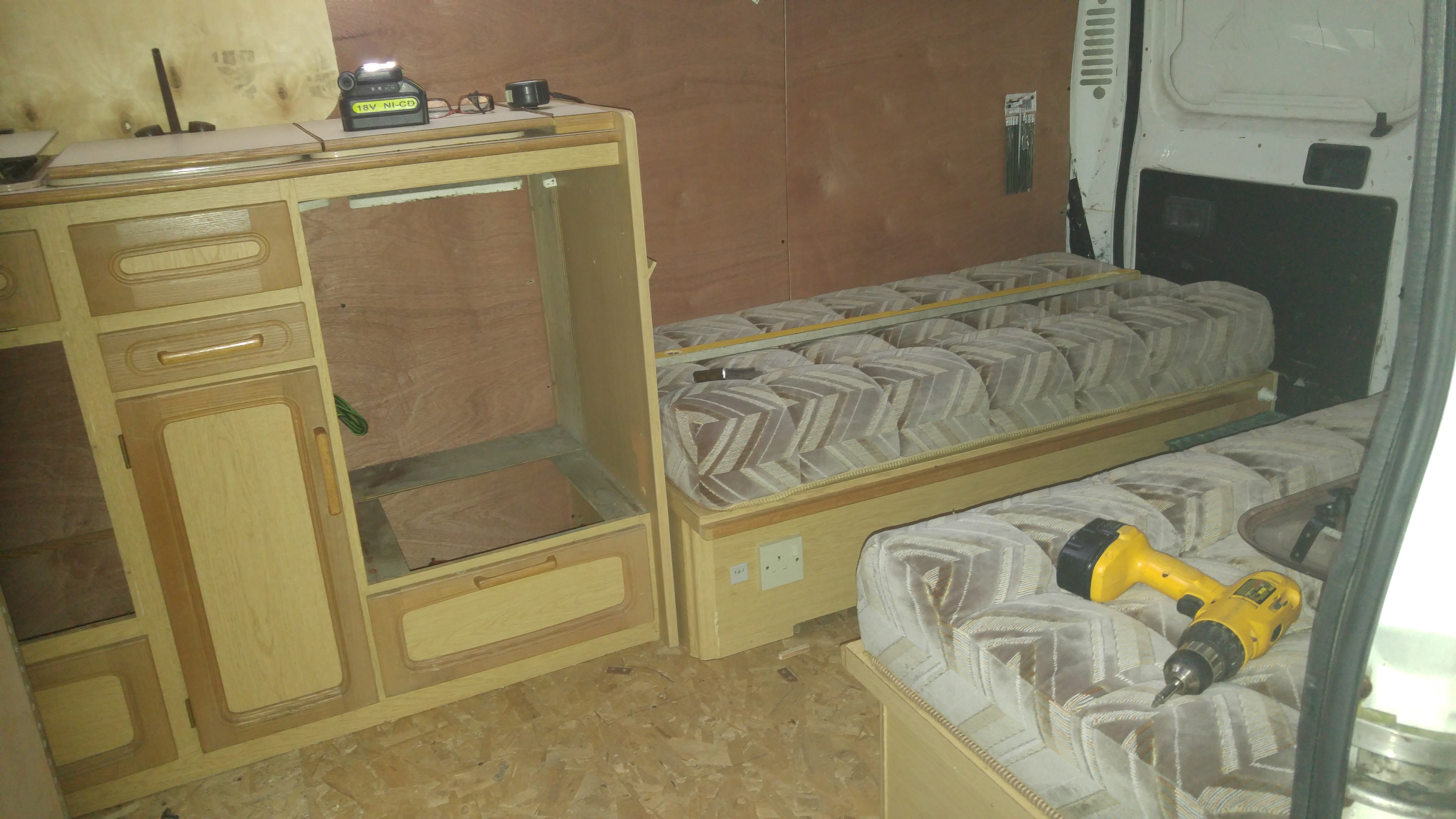

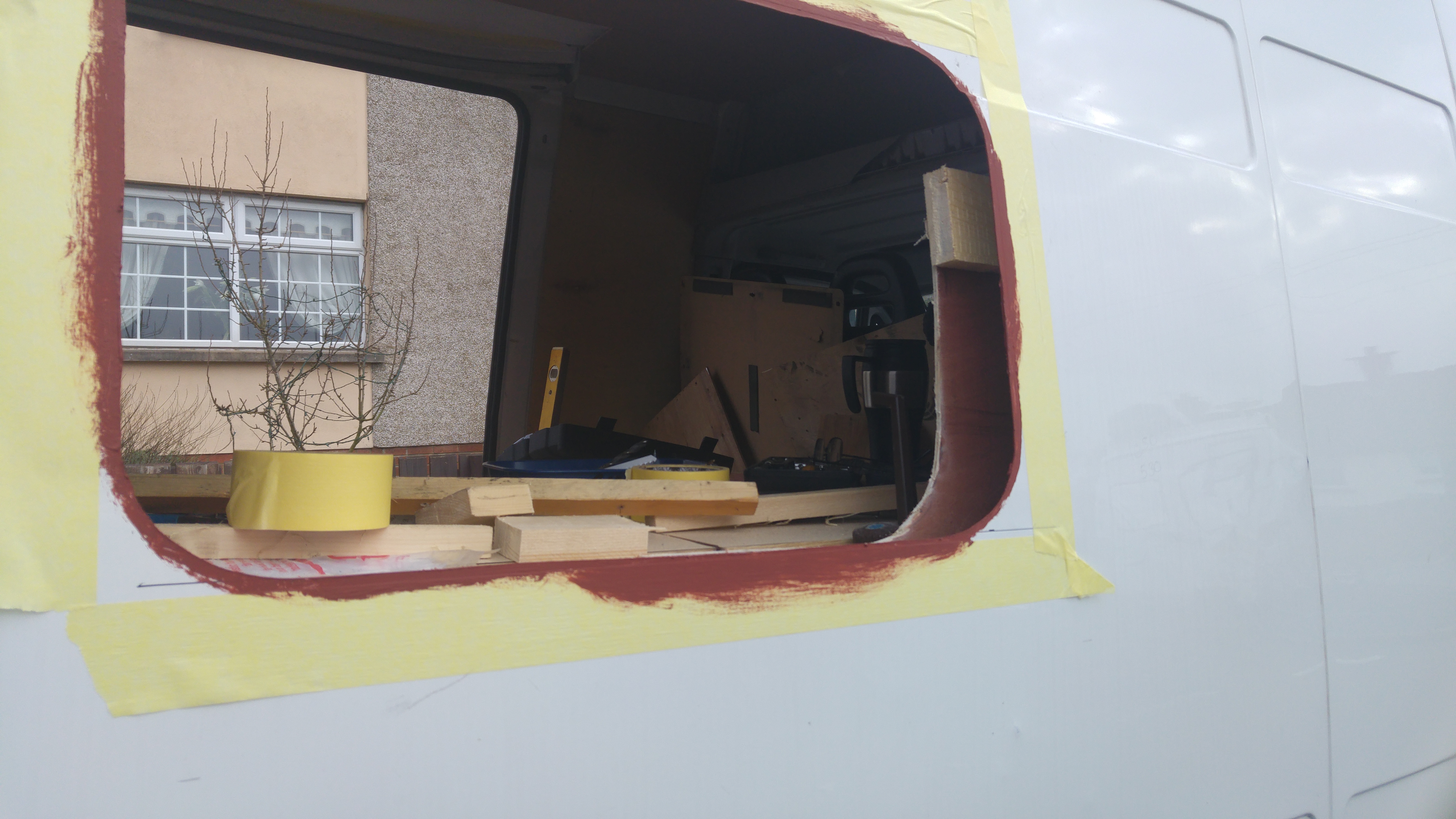

got a wee bit more done today

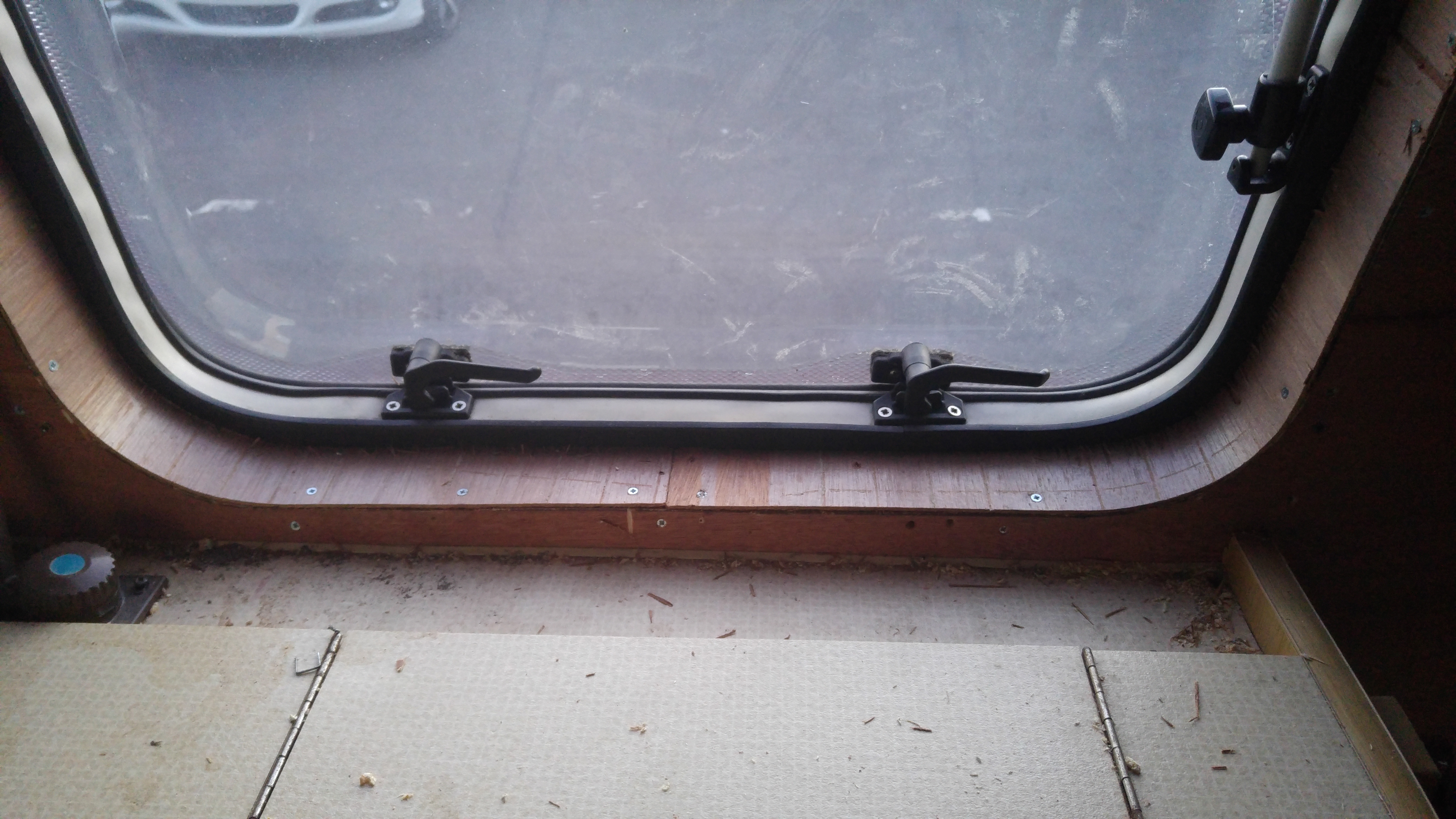

first window done and trimmed...quite happy with that one

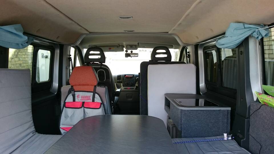

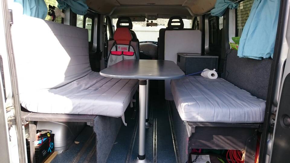

Hi. So will find some construction pics but this is it. Kept the panel on the ceiling thin for headroom. The table sits on shorter legs to make the double bed. We sleep across the width of the van it matches my 6 foot :). Our little girl sleeps across the front seats on a board big enough for a cot mattress. You can see them both held behind the drivers seat. Will be a few years before she needs much more.. . The sink unit has water and waste accessible via that side door. A simple gas burner stows away and will sit next to sink. Also a small fridge slides out from under sink unit. Solar panel bonded to roof too.
