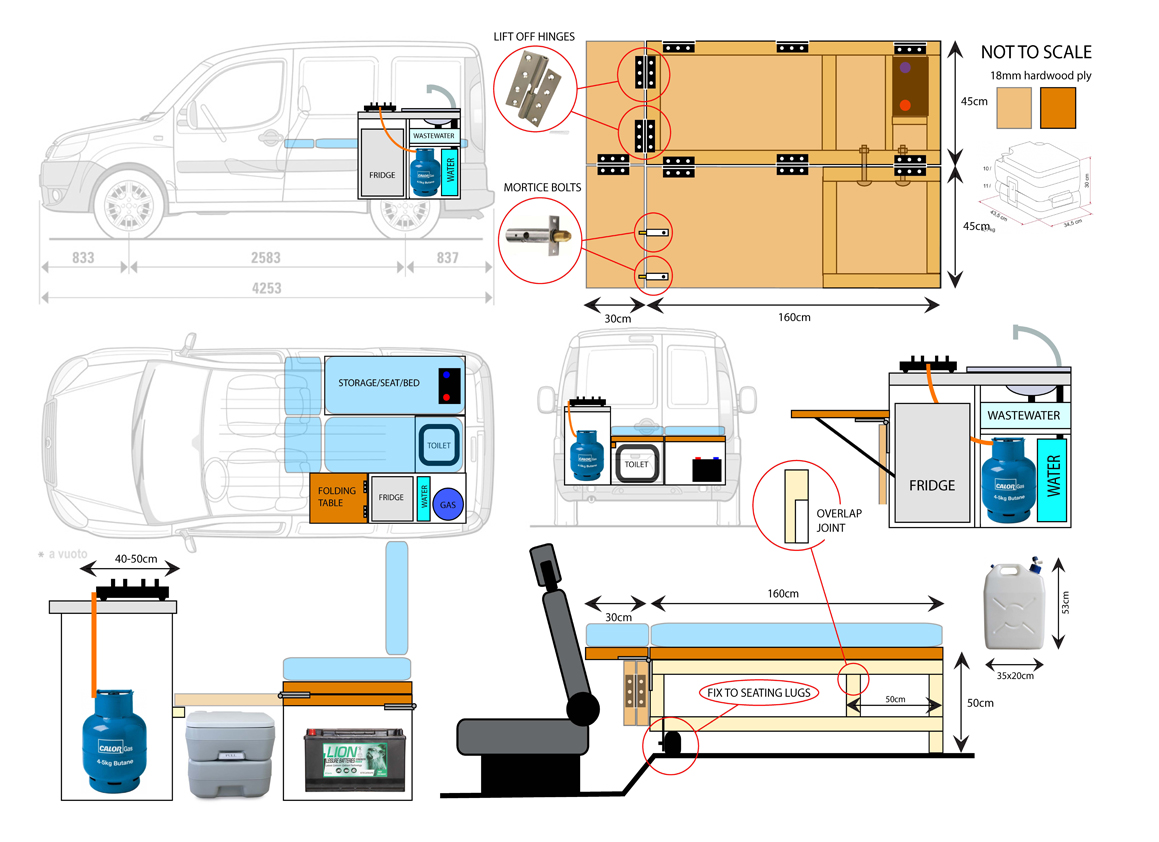

W Woolpack New member Joined Jan 6, 2015 Messages 30 Points 6 Jan 7, 2015 #1 Hi just got myself a 1.3 2006 Doblo to convert into a camper van, any advise welcome. Have a look at my plans. Attachments DOBLO.jpg 378.8 KB · Views: 2,470

500e Member Joined Aug 19, 2009 Messages 238 Points 126 Location Uk Jan 7, 2015 #2 Don't forget the gas should be in a box with a vent at bottom to allow any leak to vent outside
OP OP W Woolpack New member Joined Jan 6, 2015 Messages 30 Points 6 Jan 8, 2015 #3 Did not know that, thanks
andydiver Patron member Joined Mar 17, 2014 Messages 610 Points 176 Location Thetford Jan 8, 2015 #4 Hi, have seriously considered similar before, like it. But have you allowed for the wheel arch under the fridge/gas?
OP OP W Woolpack New member Joined Jan 6, 2015 Messages 30 Points 6 Jan 9, 2015 #5 Not yet, should have room for the gas but the fridge, may have to be a ice box, but have around 40-50cm to play with, its all based on the basic single bed of 90cm. See new layout Attachments DOBLO.jpg 410 KB · Views: 216
