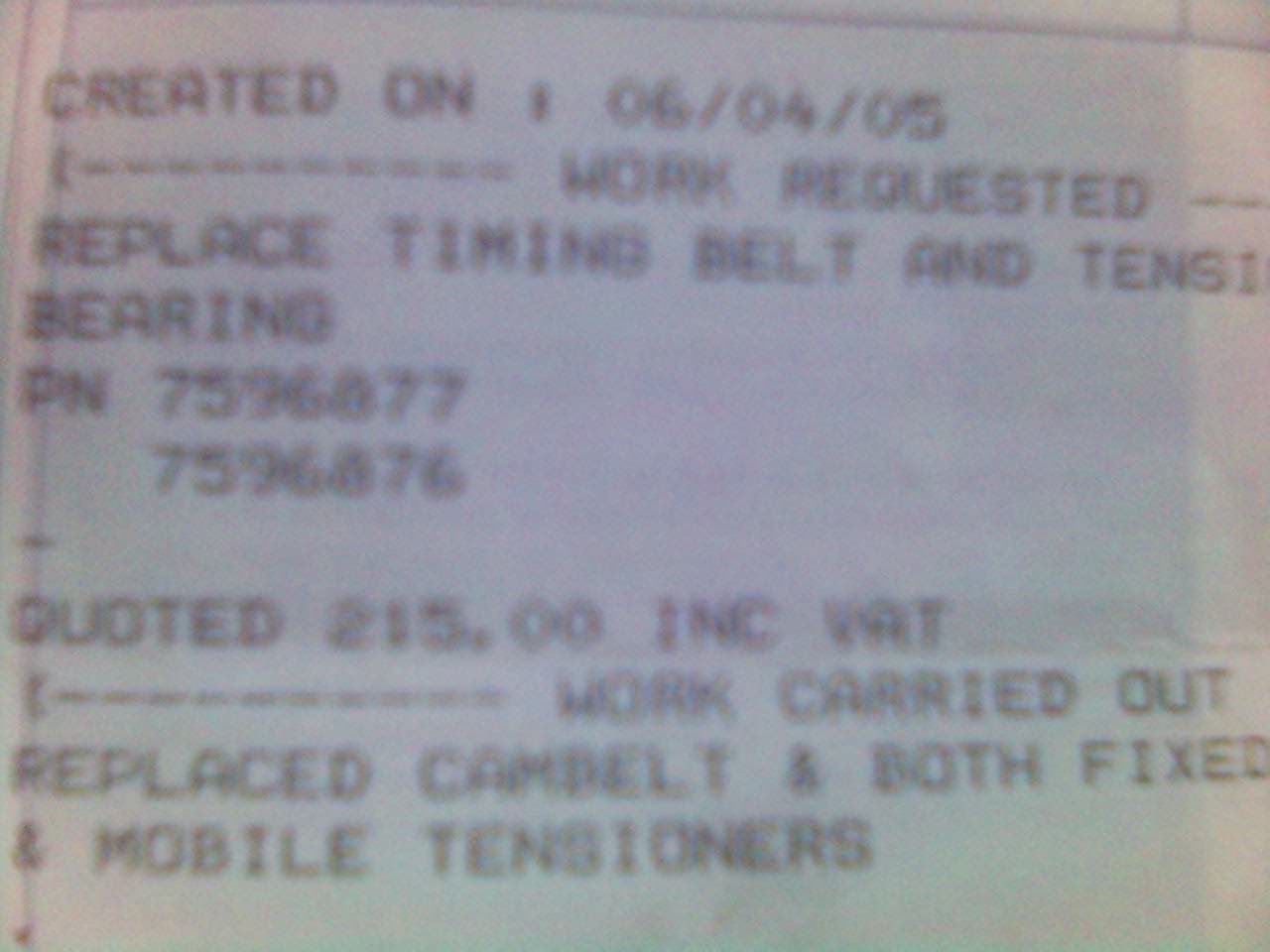

Fiat say the cambelt repair is out of 1 year guarantee and say it could be a jammed waterpump. :cry:

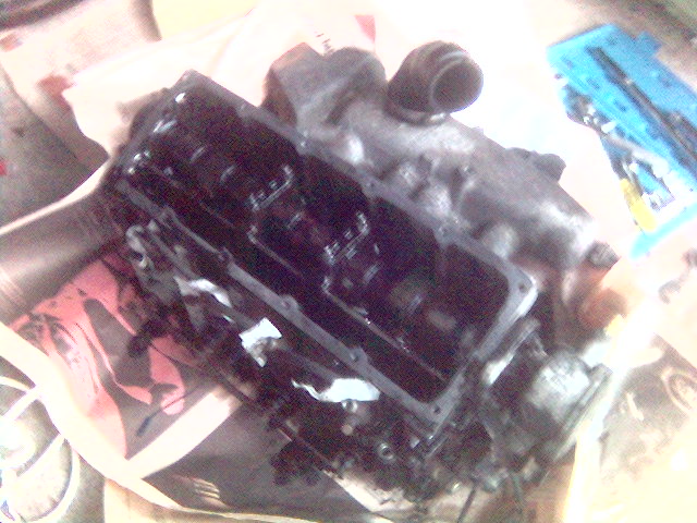

The waterpump, steering pump, alternator run freely. And as the pistons go up and down ok I suppose that means the're ok? So I'm wondering what caused the cambelt breakage. :confused: The cam pulley won't move but whether the head jammed or was broke at the time I don't know.
I'll take the head to a specialist :cool:
