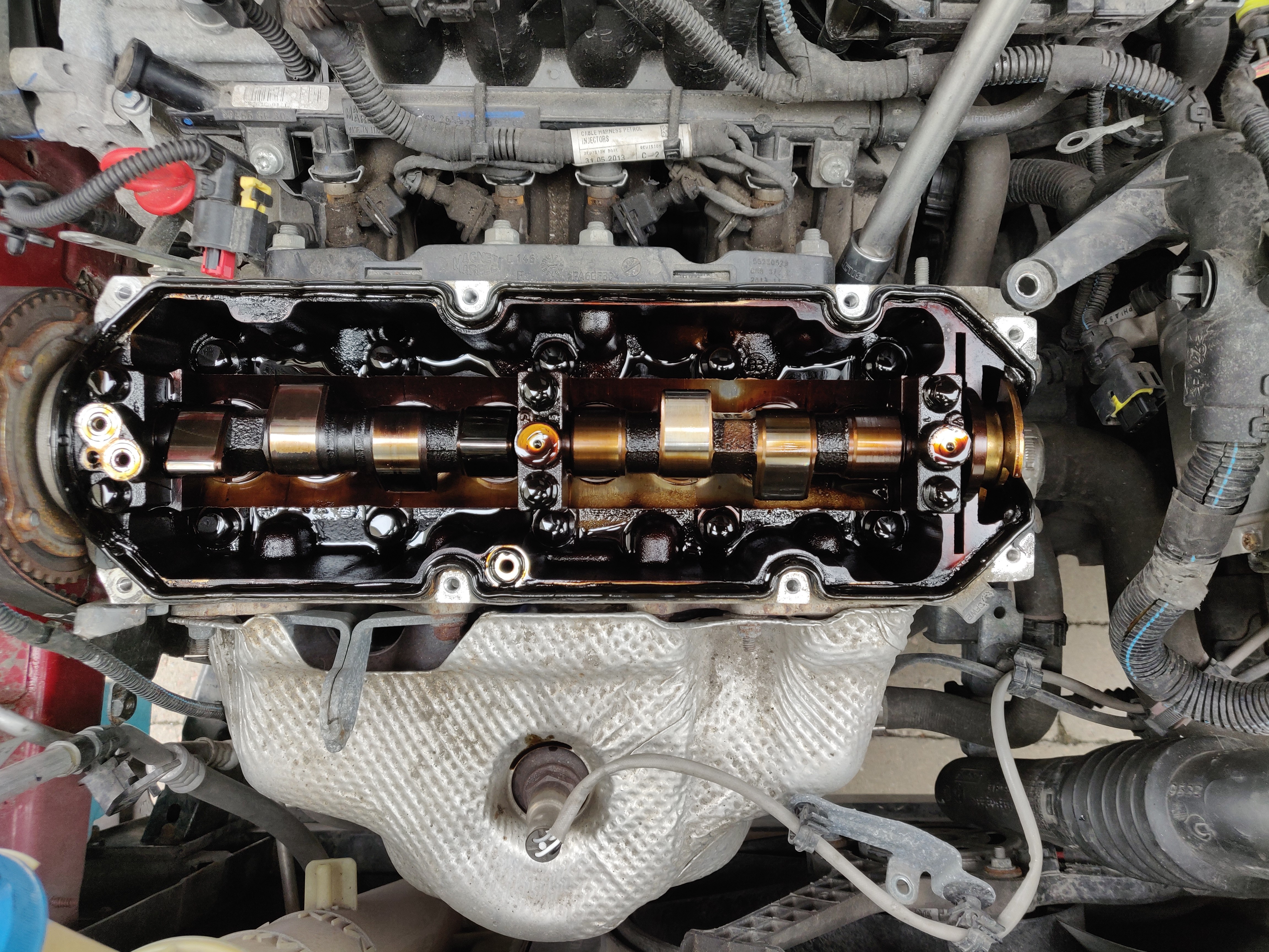

Got the tools! I removed the valve cover. I just removed all the screws holding it and the ignition unit and a couple of cables. (posted images if anyone want to learn :) )
Should I nowgently turn the camshaft (making sure no valves hit the pistons) until the tool "edge" can fit in the groove of the camshaft?
I cant tell from the images in the link if the "edge" fits in the groove or not... I assume its the case... :)

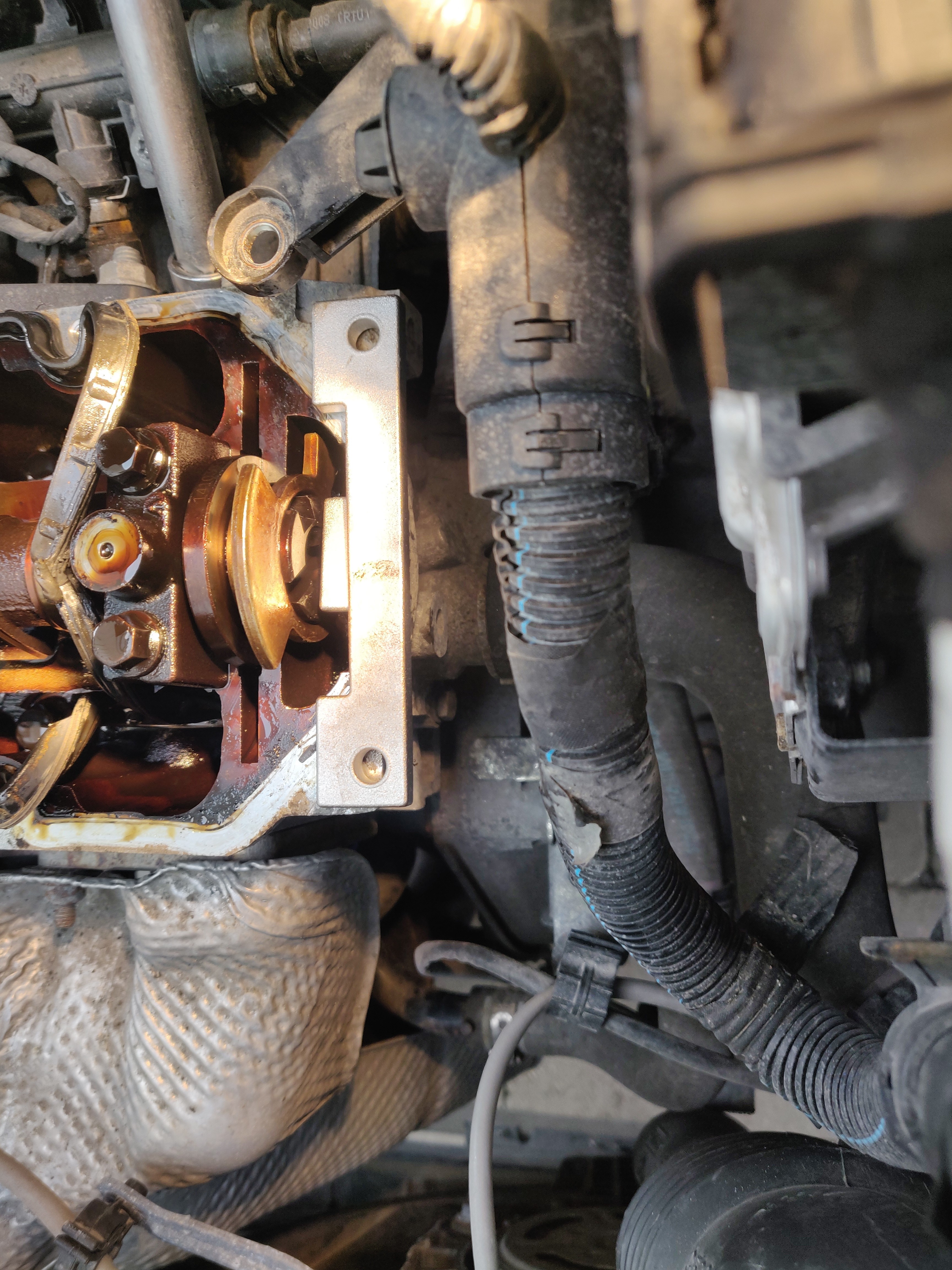

Hi josa, Yes you need to get the cam turned till the tool fits in the slot across the back of the cam. Is the belt still fitted just now? If not, traditionally the advice is always to set the pistons all halfway up/down the bores before trying to turn an unconnected camshaft. That way the valves can't possibly touch a piston.
However looking at your picture of the end of the cam I can see the wee slot - not the slot the tool will engage with - is sitting at about 2 o'clock relative to the cylinderhead. If that's not understandable here's a picture of my Panda with the tool fitted in the slot where you can see the "wee" slot I'm talking about:
The end of your cam looks slightly different because you have that large disc but the cam itself is the same. The position of this little slot would seem to indicate that your cam is almost in the correct position (just needs to be turned on by a few degrees to allow the tool to slot in) so I think you will probably be able to just gently turn the cam that slight distance and get away with it.
Of course then you need to be careful lining up the crankshaft just in case a piston touches a valve as you move the crankshaft without the belt connected.
Hope that helps. Maybe I could have described it better? If I can clarify please do just ask
Regards
Jock
Ps when you put the cam cover back on check the little rubber seals are still there for the oil drillings to the cam. I don't think they could drop out, mine didn't, but maybe best to check.

I can see from pictures you need to turn cam pulley about 6 teeth clockwise , obviously after removing cam belt, to fit special tool.
Yes the notch in camshaft should be roughly vertical then the edge of tool fits in slot cut across end of camshaft

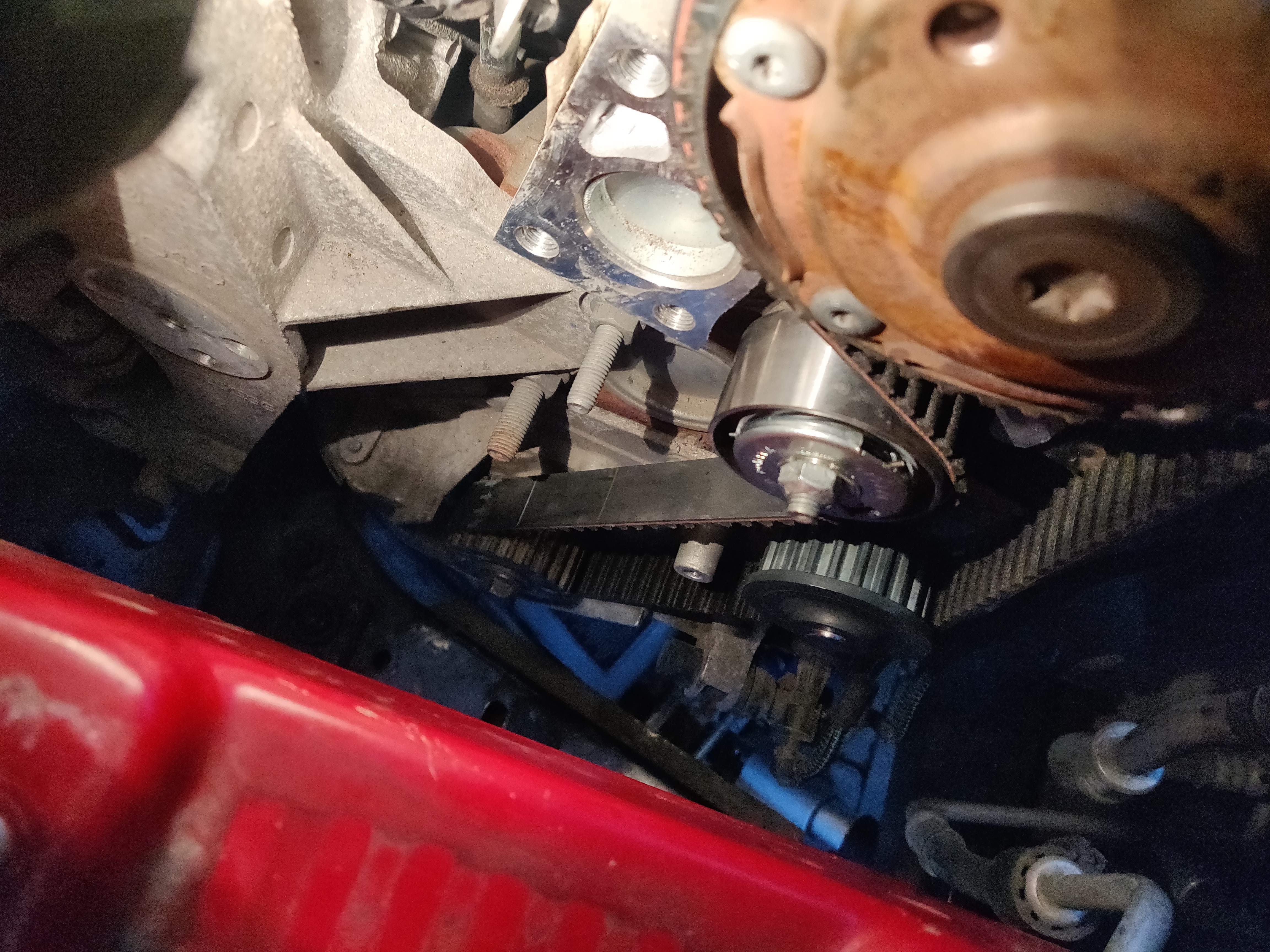

You really need to remove belt first , set the special tool on the crankshaft , which as jock points out sets the pistons halfway in bores out of the way of the valves. Then you can rotate cam shaft.

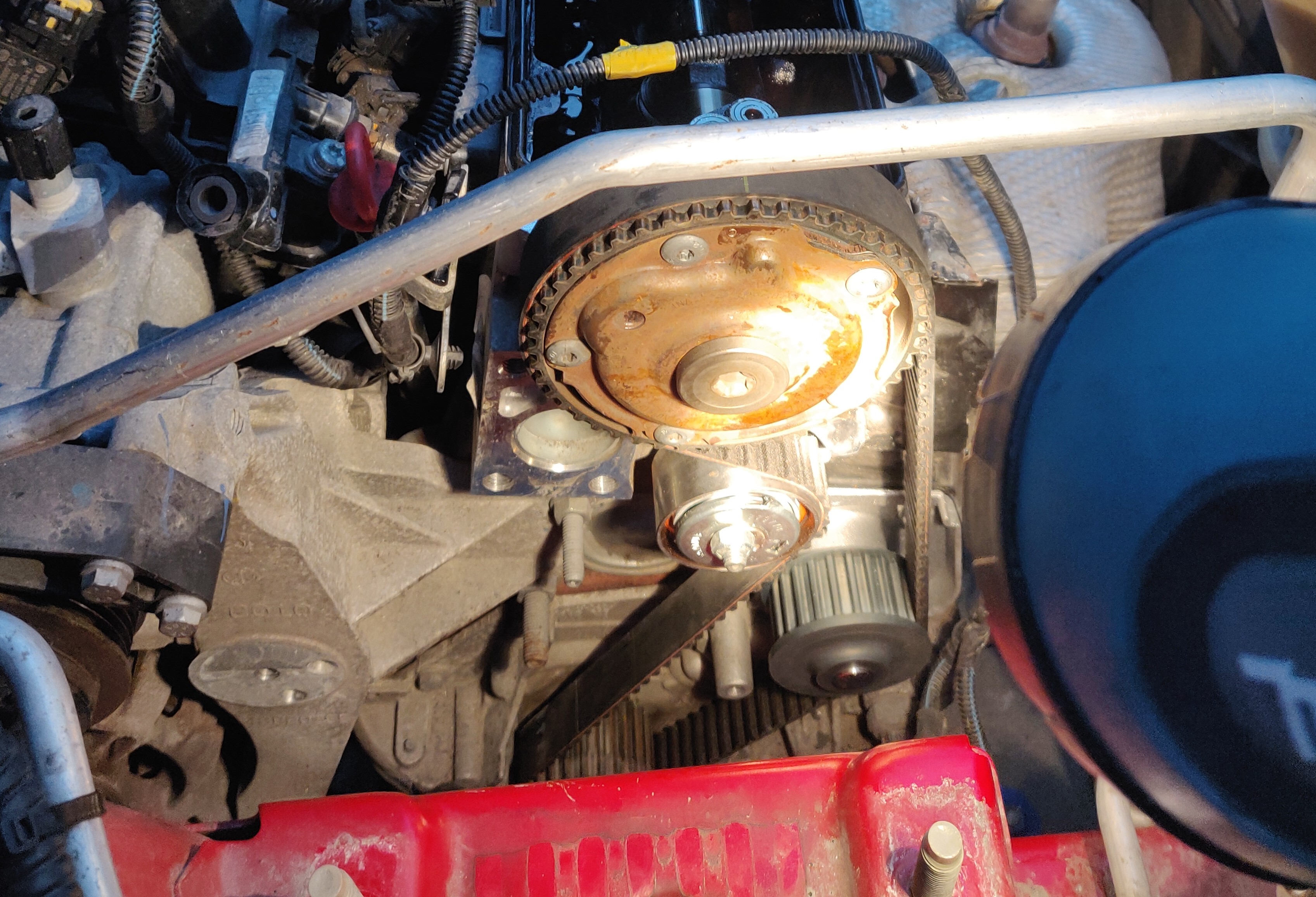

Ok Ill lock the crankshaft first with the tool. Then the camshaft. Then the belt. Then the tensioner.
Now the belt is intalled. It seems it worked. I turned the engine tww full rotations. Felt nothing special.
The marks on the belt doesnt line with marks on the sprockets (even though i placed the line at the C on the camshaft it doesnt line with the marks on the crankshaft). However it doesnt matter. I adjusted the tension roller to max rotated the engine two rotations. Then I lowered the tension so the indicator aligned. Then I tightned the nut with 20nm.
Should be 25nm.
But everything else sounds good.
The c on the cam shaft pulley is not a timing mark and means nothing.
Wherever you set lines on belt to start with as soon as you rotate crank those lines won't match their starting points again for about 100 revolutions.
Well done.
If you thinking about what happened on your first attempt, turn crank till it is in the position in your very first photos and take picture of cam pulley and post it on here.
If you now not bothered that's fine.
Turned on the car and everything seems fine. Thanks for the support!

I think your brain melt down was trying to get old lines on old belt to match pulleys it's a near impossible task and would require turning crank hundreds of times and totally unnecessary.
I tried to do the maths to work out how many times a 23 tooth cog has to turn a 129 tooth cog before teeth aligned at start align again , I gave up after an hour with a headache.
