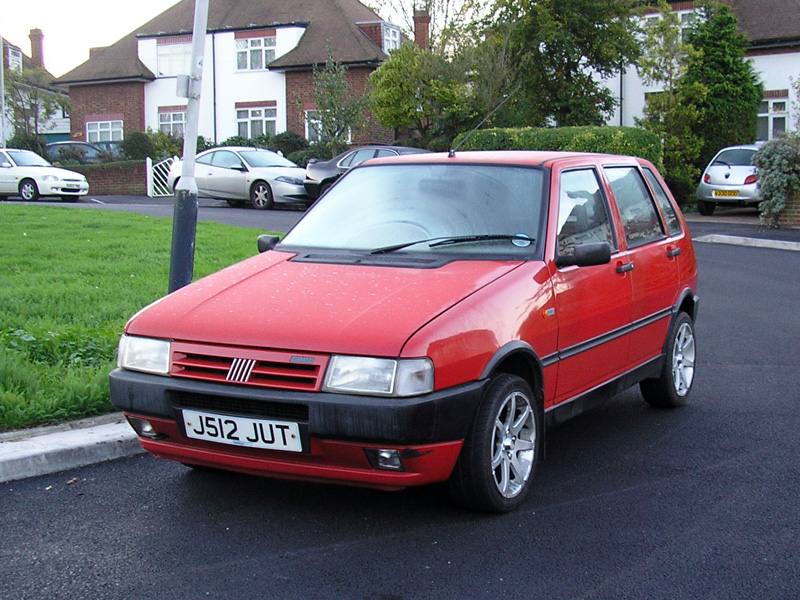

Chris, DON'T scrap your SX! It's in really tidy condition and it would be a real shame to break it.

I know Louie will have me up here for suggesting to keep it on the road as me and Turboned broke up a mk1 SX back in the summer :eek:, but yours is WAY better condition! At least give it a chance to continue living before breaking it!

also, its not in that much of a great condition now, after having to break into it before ace, a few of the panels now have little dents in it (trying various forms of breaking in) and the bootlid lock andparts are buggered.

it is a shame.. it was so much fun to drive too. but even if its fixed, it will just be sold on for very little money due to the dents and other bits etc.
