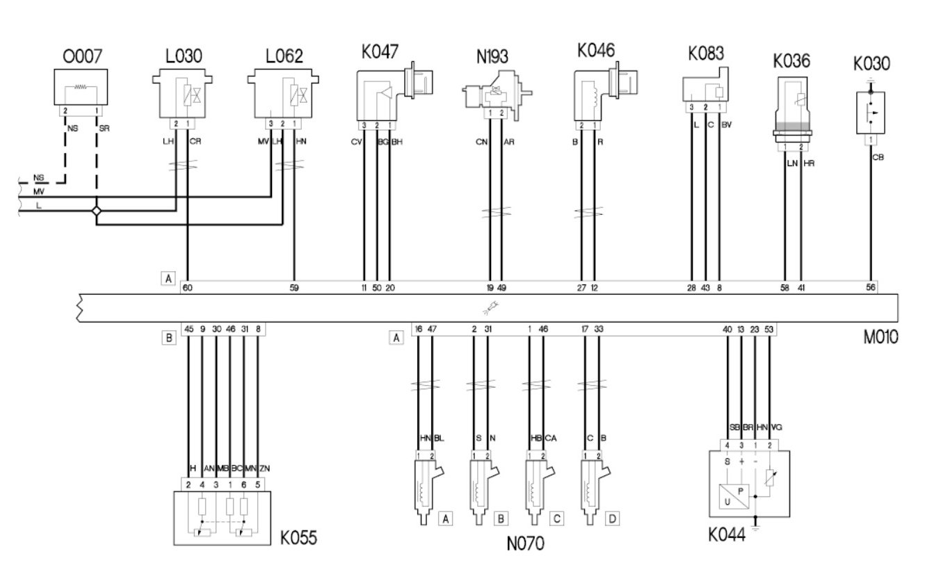

Hi, Does anyone know where the cable from the Oil Pressure switch runs to, I just want to find the other end to check it. Ducato 2014.
Hi ninian
This information is dated 2006, but may still be applicable to your vehicle. Bear in mind that Fiat were fond of changing wire colours as time went on.
There is an Orange/White cable from the Oil Pressure Switch K030 to Pin 56 of the Engine Mnagement ECU M010. See Diagram Attached.

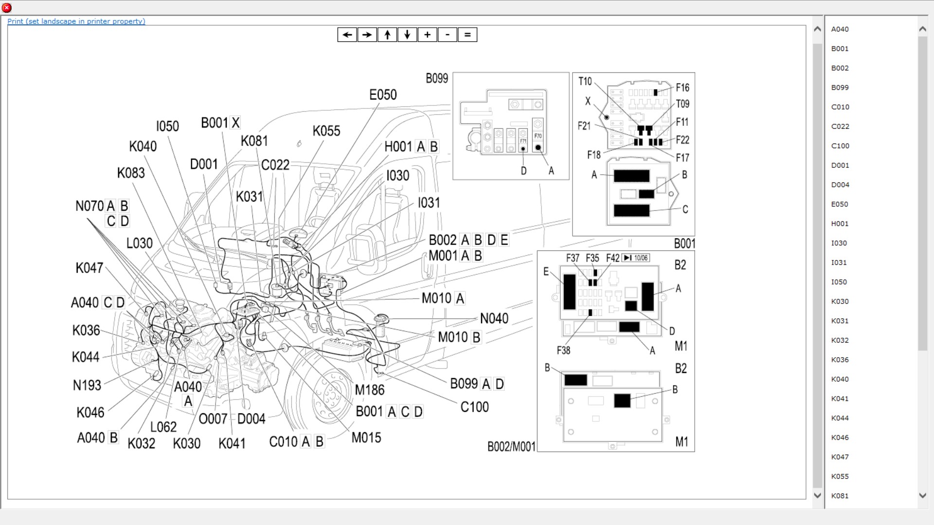

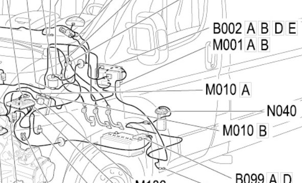

Hi
The ECU (M010) is in a diecast metal box about the size of a thick paperback book, with 2 large multi-way connectors. It's in the engine bay on the right hand side as you look at it (UK passenger side) near the fusebox and air filter housing.
