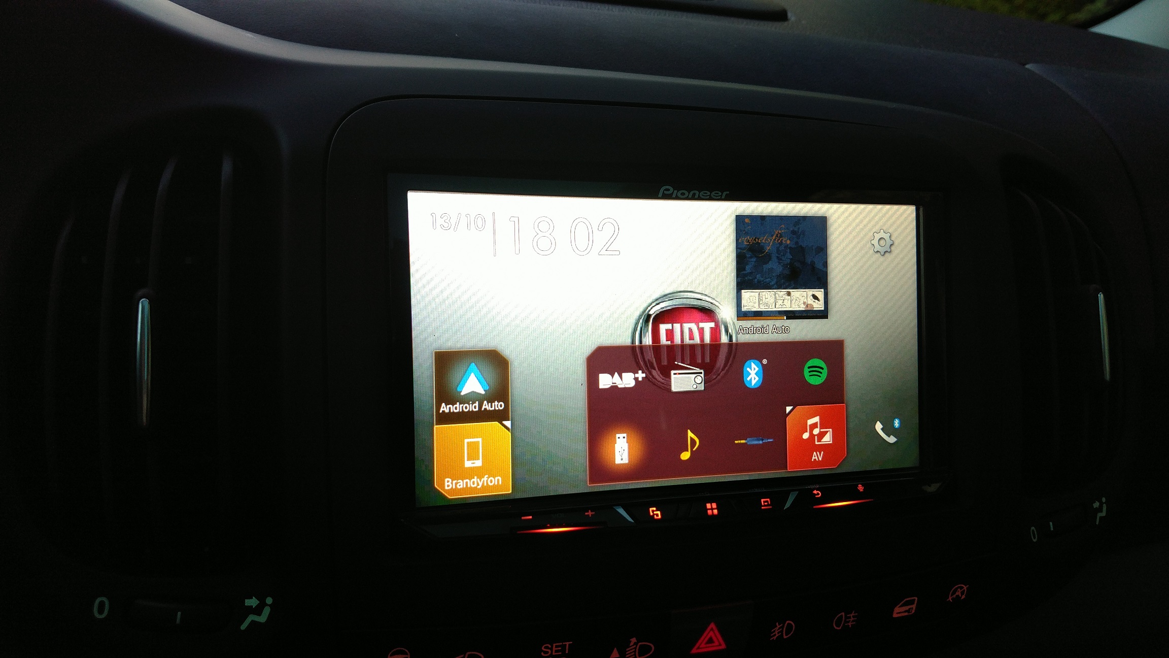

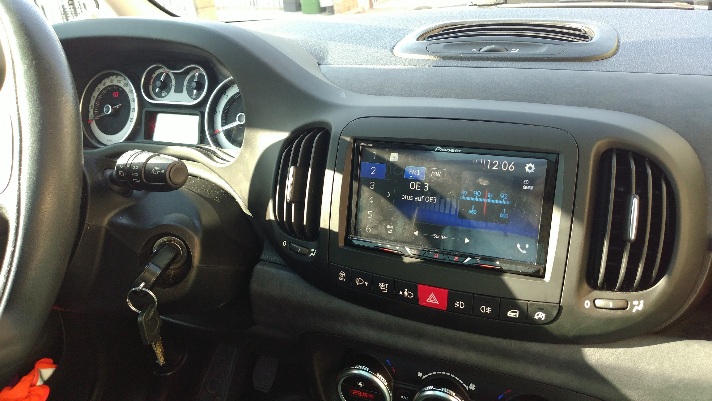

Hi,

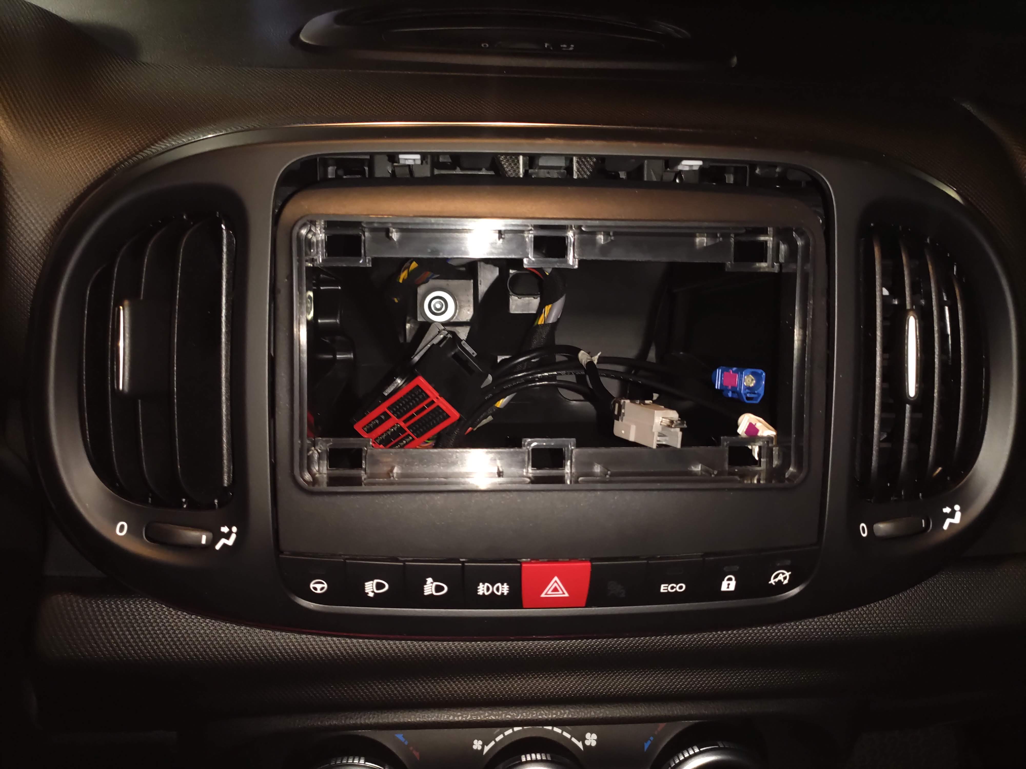

today I finished the bigger part of the radio conversion. New radio is in place, original microphone is attached and works fine, now all I still have to do is to install the 'Connects2 Infodapter' steering wheel control cable as soon as it arrives (it was missing in the kit I received in the first place), and to connect the rear view cam to the reverse light.
New radio works fine, looks good IMO, only issue is that the bay of the 500L is not really fitted for a full size 2DIN radio and I had to cut away some plastic. Still the radio is not sitting 100 % perfect and there is a 2mm gap on the upper edge of the fascia.

At least, after some more work on the radio bay, the radio and fascia sits perfectly without gaps.

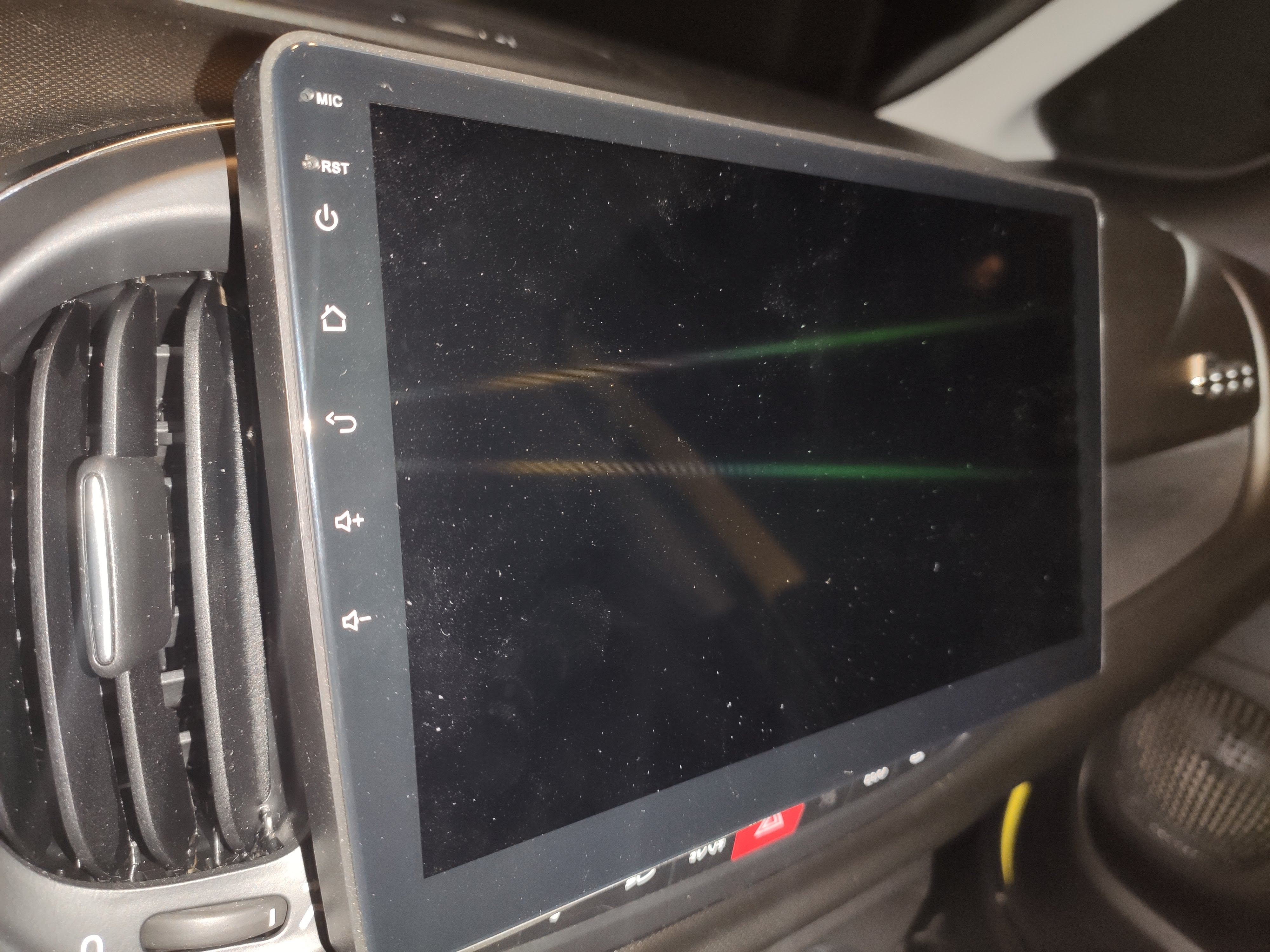

I dislike uconnect, and bought an android head unit with a built-in 360 panorama system.
I tried to install it. Fascia from Aliexpress does not fit 2018+ models but nothing can stand Dremel :)

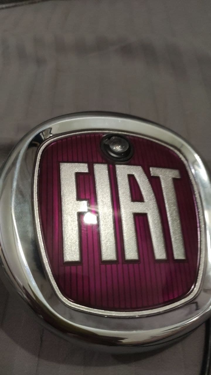

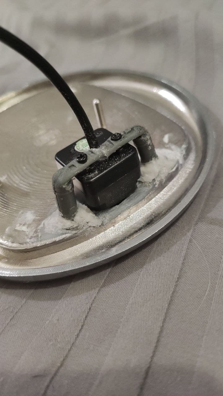

Now I trying to install all four cameras. For the front camera, I bought a cheap logo, drilled 18mm hole, and attached the camera stands made from wall plugs with soda+superglue.
So I have a question. How did you connect the original microphone?
p.s. The canmodule shipped with the unit is perfect. Everything just works - camera (I'll replace it though with 4 panoramic ones), steering wheel controls, door sensors, even wheel trajectory! Sound just perfect with a TDA7850 chip. Fascia is not fitting and need some work with a Dremel, but when the unit is attached everything fine. A Unit can take the internet from a phone via Bluetooth. And a built-in 360 system is just the greatest thing ever (I tested an app and connected cameras but didn't install cameras yet). Everything just for $300 (or even less - $230 for unit and $55 for cameras set)
