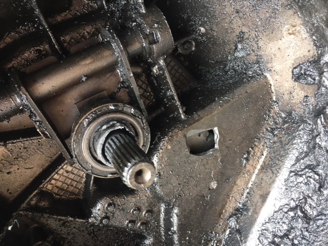

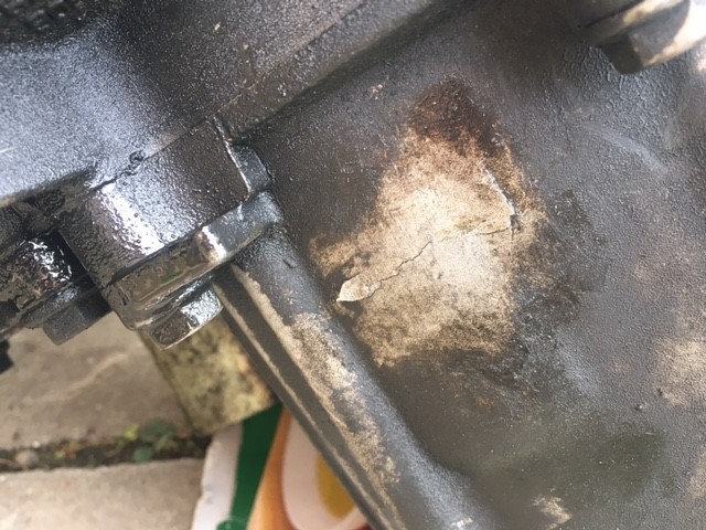

The gears have tried to smash their way out of the housing.
there is a small crack and hole in the casing at different places
Heres the damage. Oh dear. Off the gearbox heaven.
I know it failed after the clutch was change while over 100 miles from home. We can only speculate. It looks like it was refiled with oil.

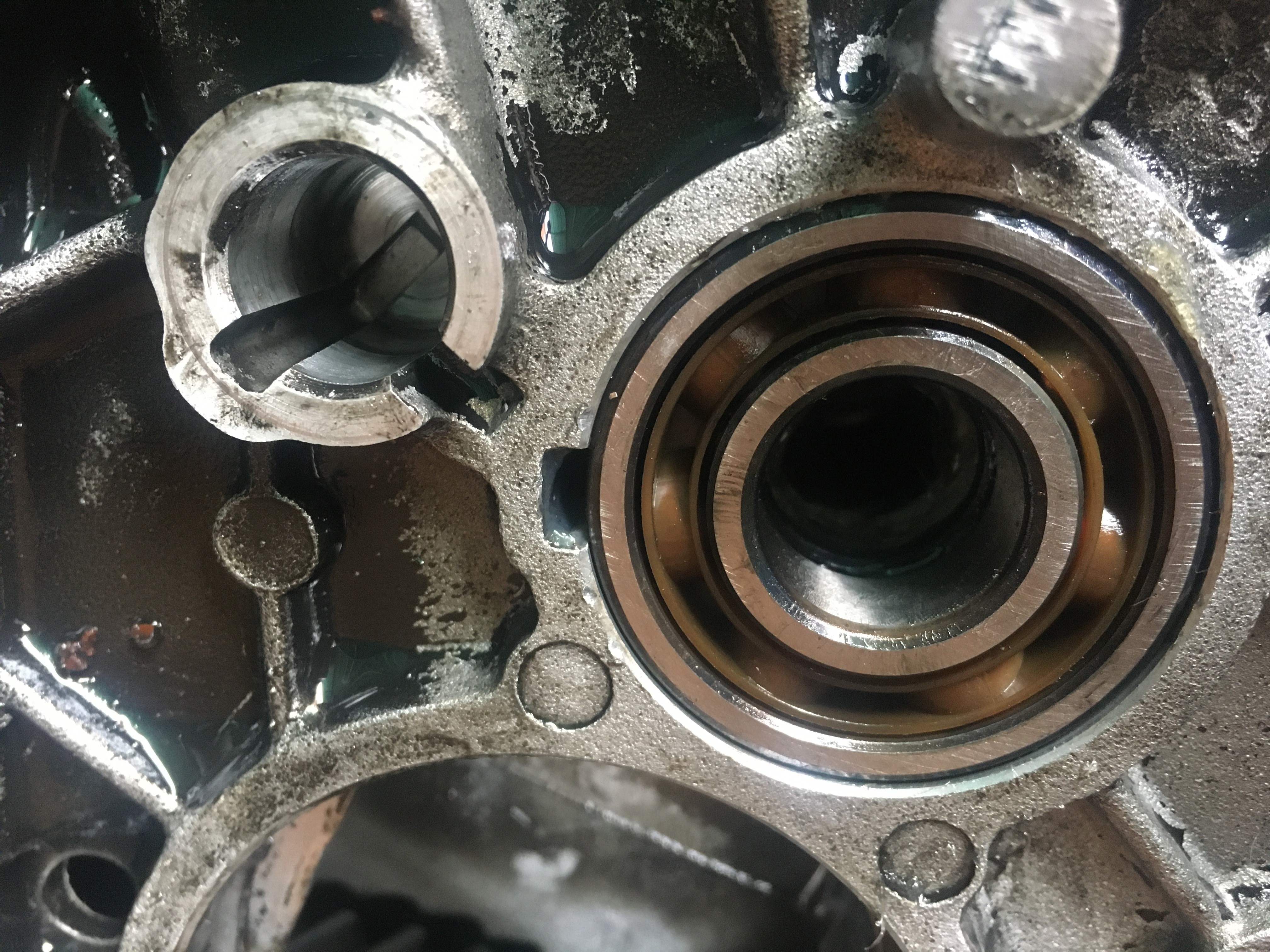

Good job I am fitting a new input shaft bearing. The bearing has over heated, gone straw coloured and the cage disintegrated. All 7 ball bearings were there hanging at the bottom.
New input and drive shafts seals are now in place

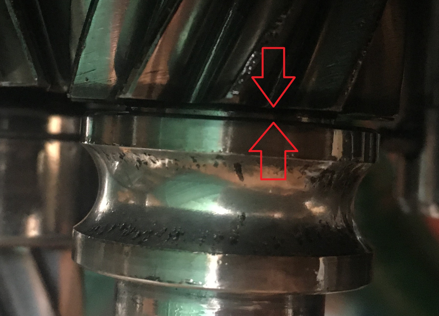

Just a quick question
there is no collar for it to slide up to, there is a small gap between the bearing and the First gear.
I have the broken gearbox and its replacement. The gaps are slightly different.
the inner race isn't that tight on the shaft. The outer race is a sliding fit in the bellhousing. I am thinking of using the bellhousing to seat the bearing
both gearboxes have a similar gap here
the bearing is a slide fit into both bellhousings

Presumably, the old bearing was pressed up tight on the shaft shoulder. Maybe the bearing radius is too tight for the shaft radius. Regards the casing, some bearing fit Loctite may solve the issue.
there's no radius I have knocked of the inner race from the broken gearbox
been on elearn they show the bearing being knocked on with a special tool which is basically a pipe. However its not clear if the bearing should be fully home or if the tool stops the bearing just short of the gear.
I would be very surprised if the bearing did not sit up against the shoulder.. If it's fitted too short the shaft will probably bind in the crank needle roller and 4th gear might not engage properly.
Does the "Mr Wild" thread in the Punto section give any clues?
This search threw up an interesting point about how NOT to fit the output shafts. And of course Mr Wild's excellent input bearing "how to"
