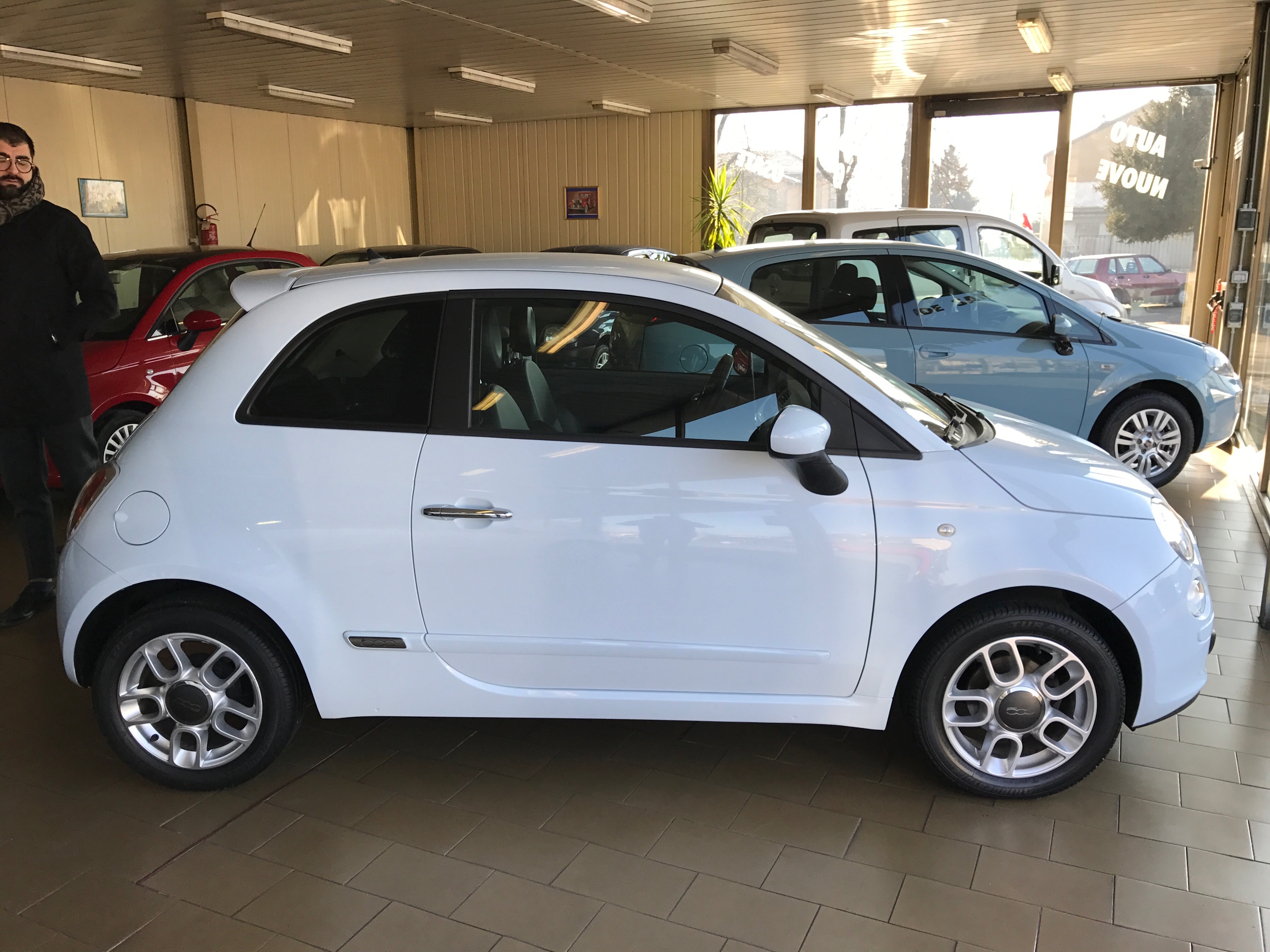

Hi there,
New to the forum. Just picked up my first 500 (cute little 1.2L "sport" in Azzuro Cuor Leggero). On my first drive to work I noticed that whenever there is even the tiniest amount of bass in the music I'm listening to, the rear speaker panel (and i'm guessing the whole panel) vibrates and makes a buzz sound. It sounds like when you max the volume on a cheap car and the whole thing vibrates (remember back in the day when "systems" in the trunk was a thing and from outside you could hear the trunk vibrating and falling apart).
It's driving me insane. I'm tempted to rip apart the side panel and see if the speaker is loose (which it's not, because it's both) or if I can move the speaker back or something.
Is this common? Maybe because its cold out and the plastic doesn't want to be flexible? Oh there's also a tiny squeak from the right rear area above the seat (sounds like a bad shock, but its not because i had it checked), so i'll just throw that in the mix of squeaks and rattles that accompany me to work every day.
Thanks in advance!! :slayer:
