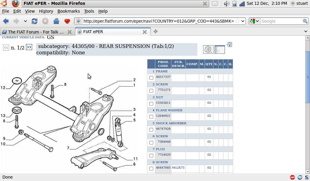

Hi, I thinking of buying a marea S Wweekend ELX, but I have to replace the front bushing in the rear suspension, both sides.
So, does anyone know a place where I can buy this cheap?
they costs a fortune in norway, about 1000 british pounds:eek:
hope to hear good news :D
Do you mean the part that joins the subframe to the body, or the swingarm to the subframe?
The subframe to body bushes are not available and the only option is to buy a full subframe, or have some bushes manufactured to fit. Easier (or maybe just cheaper) to find a Marea/Bravo/Brava with good condition bushes and swap them.
If you mean the swingarm pivot bushes they're about £30 each.

Not quite sure, but it's the bush who is mounted closest to the front of the car in the rear suspention, and there are one on each side.:eek:
sorry for my english, not easy to find the right technical terms when I only use english while on this forum :p
It might help if the part shows on this picture, you can just tell us which number it is and we can try to help further :)
