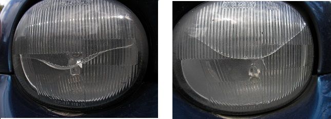

I kept the Headlight units from my old Multi when I scrapped it.
The lenses are cracked . . .
. . . but the reflectors are fine.
Went through at least one MOT like that.
Not sure if it's feasible to swap lenses . . .
Edit; Ooops, scrub that, just realised you have the later type :p
