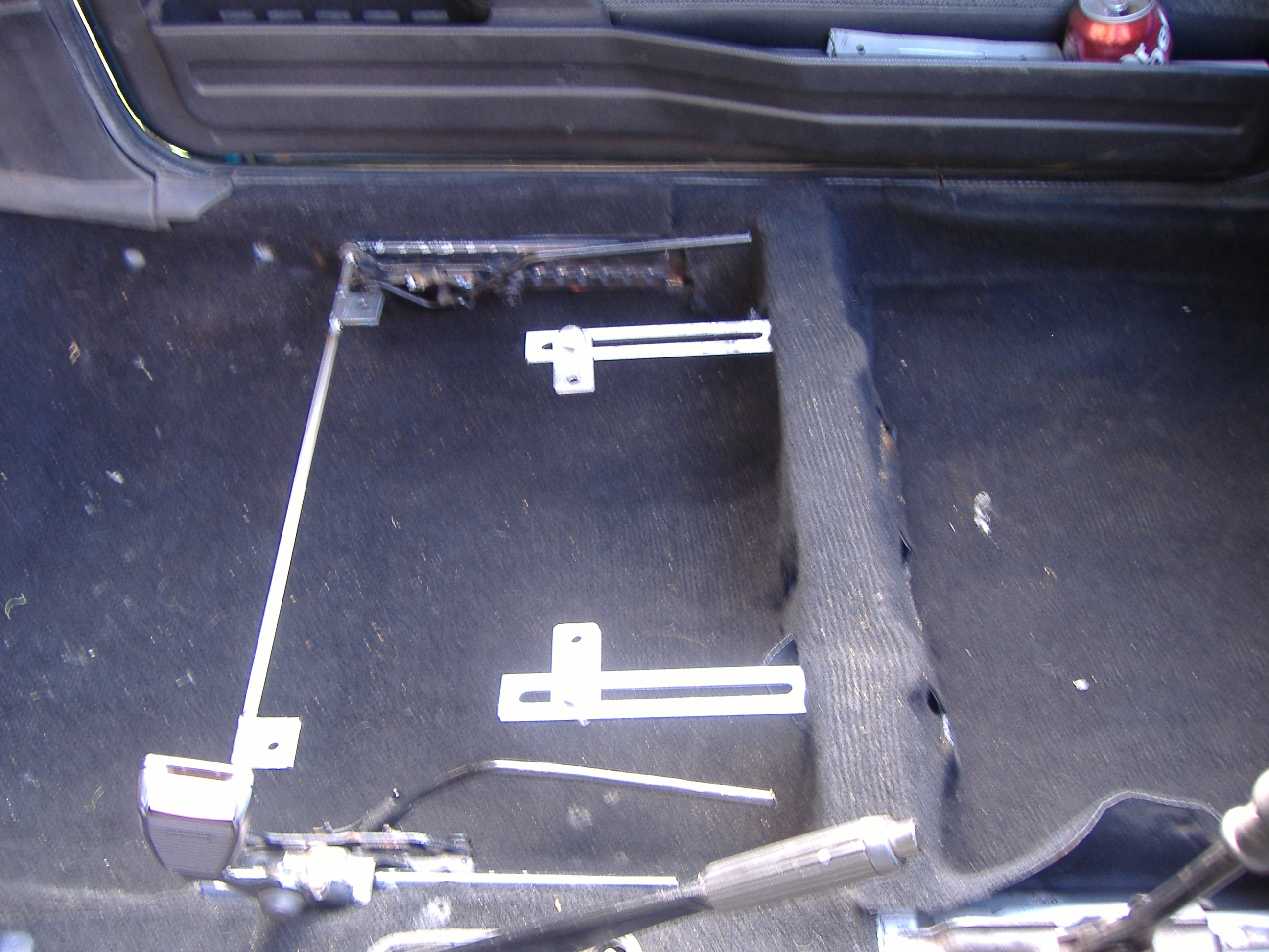

anyway so making _slow_ progress im afraid,
next pic is of seat with mounts bolted into seat - also shows the "runners" which are to be welded in place tomorrow - i can then sit in them and drive the car to get an MOT! woop woop!
i will let all know how well mounted the seat is and how it slides shortly (to be continued):eek:(y)

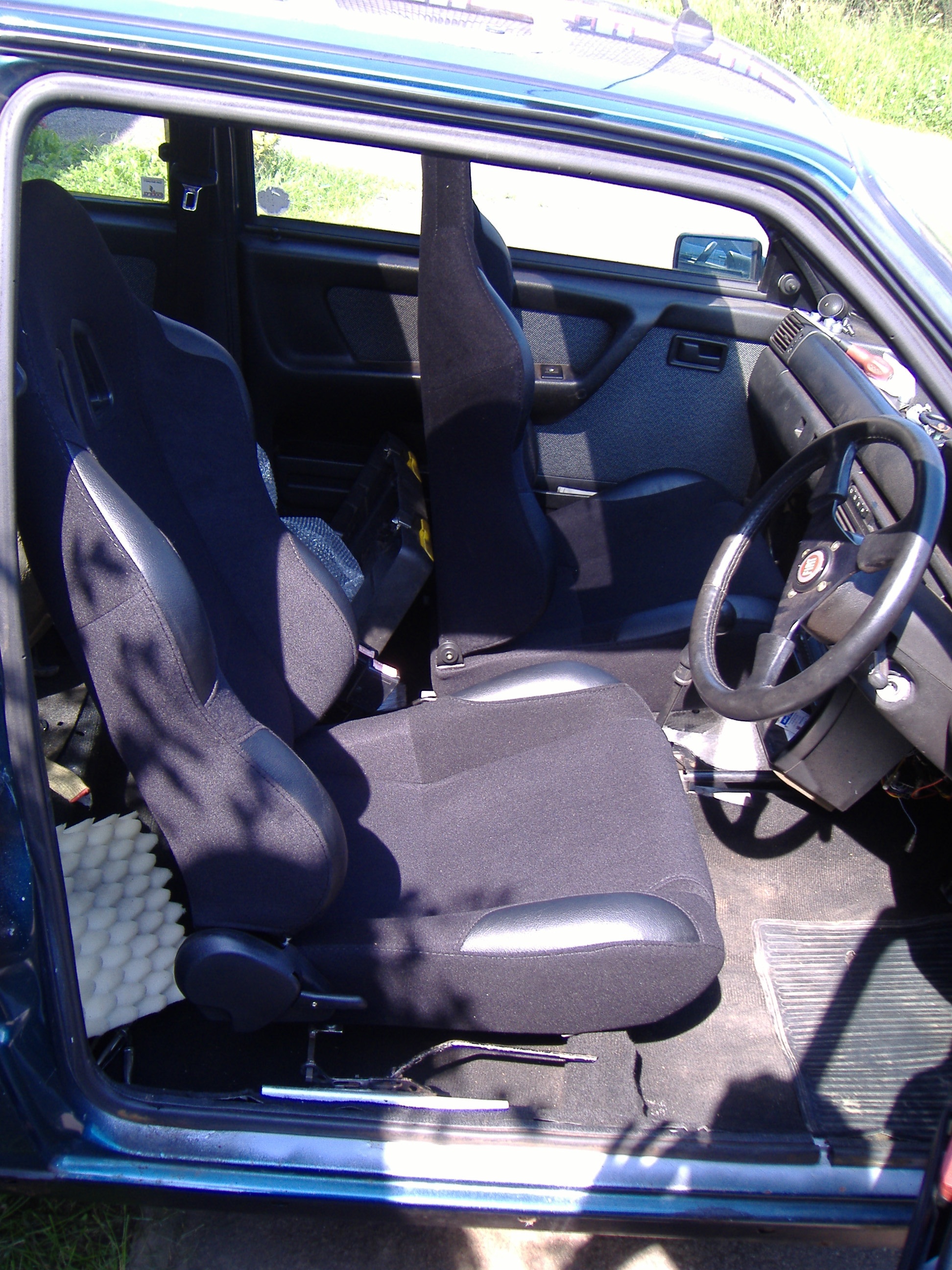

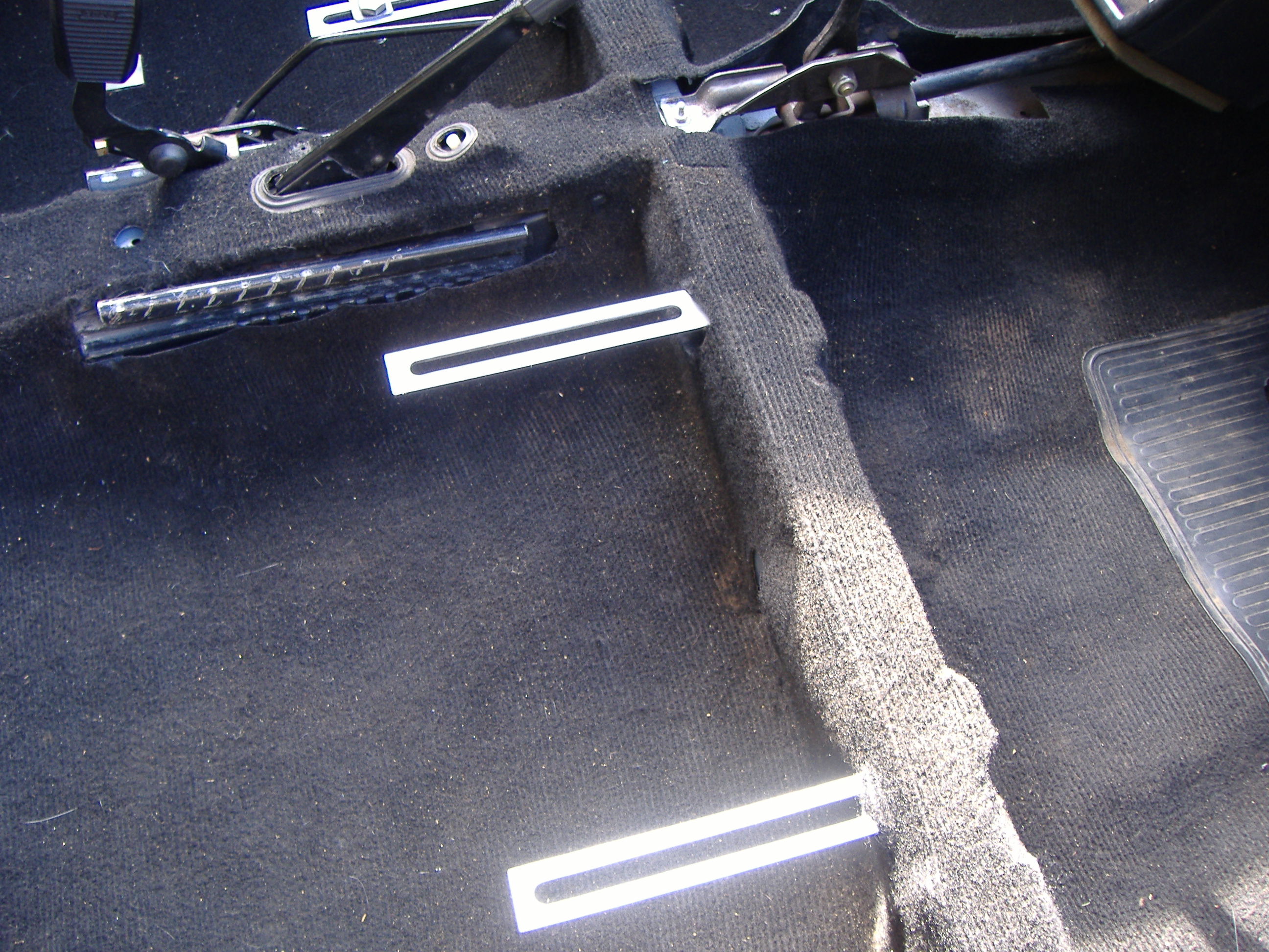

Ok so runners now welded in place, carpet cut to fit, carpet refitted(makes it look like a car again!) and one seat is in place and i have to say is nice and sturdy.. and comfy.. and makes me just want to drive her/it again..
boring pics again and im sure people sick of this thread but there is method in my madness i hope this shows.

Literally just come accross this thread. Mine were the Corbeau jobs that you were originally going to bid on. Shame really because they were top seats and I seriously considered transfering them to my new Panda.
You've put a lot of hard work into this job and that's really admirable and they look good in! Hope they serve you well, what's the quality like?
they're ok actually, i won't say they are perfect because some of the stitching isn't brilliant, and the runners that came with them weren't really worth being bolted on as only one side would lock into place...
Like i said if in the future they wear badly or i get bored my options are now open to anything with some small adjustments!

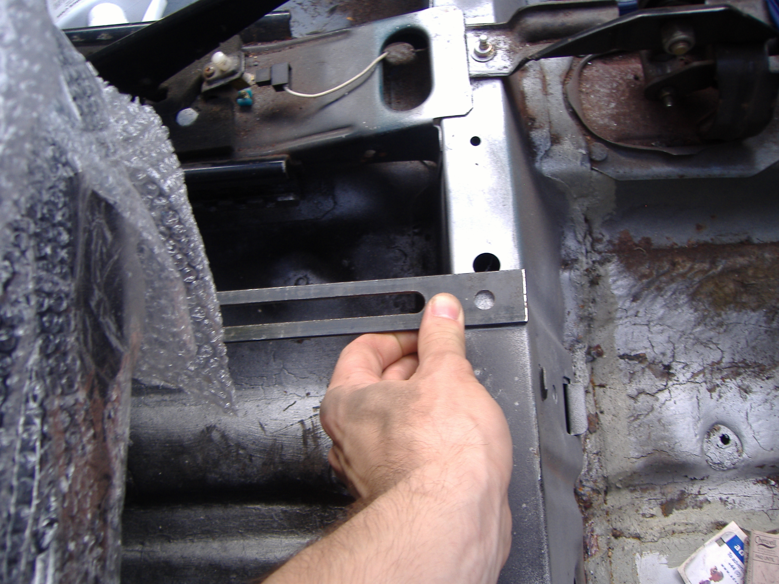

one more attached while its sat in the garage being welded :yum:
