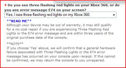

(y)(y) Ive had mine for longer than 3 years and sent it abck I'm sure :)
