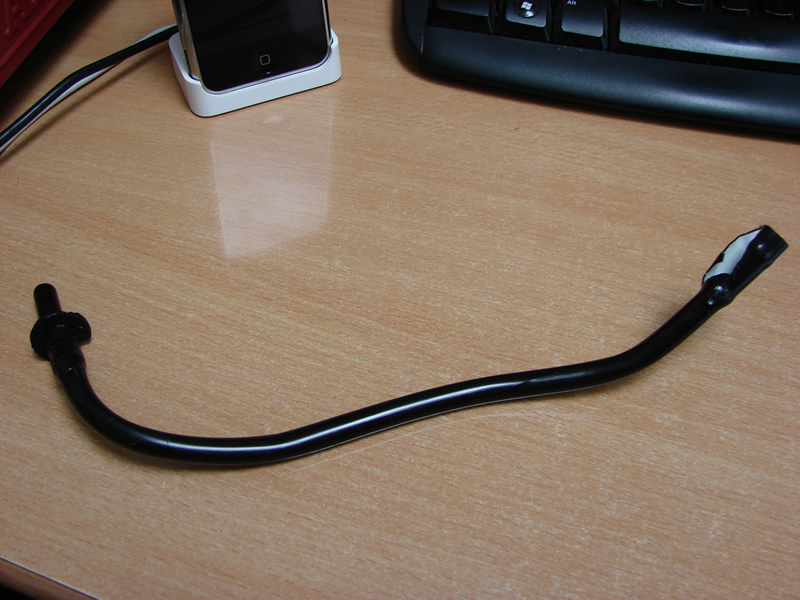

Hi.

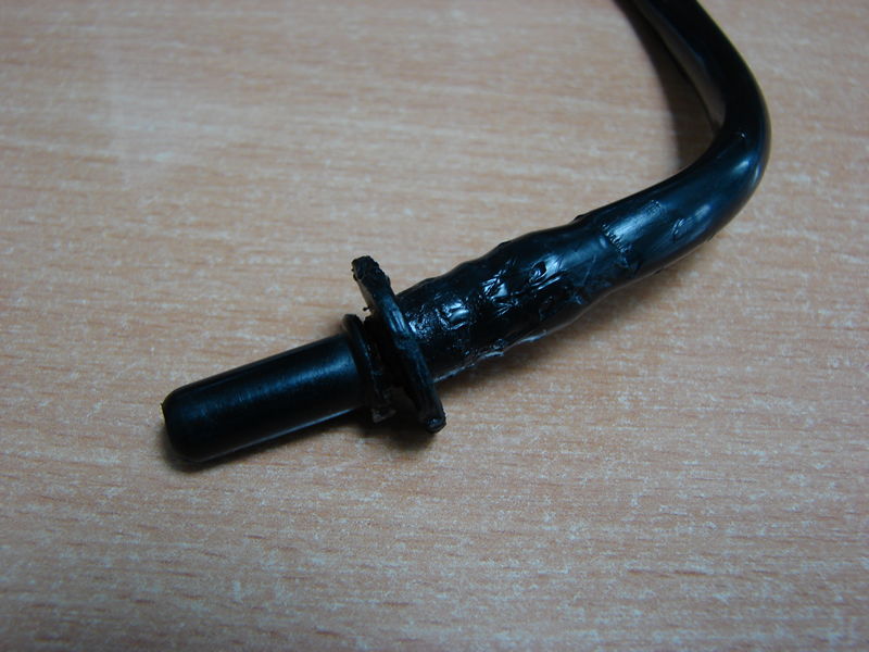

I have a 55 plate Fiat Multipla JTD 1.9 Diesel.
I've been having a problem with, I think, the injectors which are getting clogged and are causing a loss of power to the accelerator, particulary when starting the vehicle from cold.
A friend offered to help fix it, advising me to put injector cleaner directly in the fuel filter as adding it to the fuel was a waste of time. Perhaps this was/is bad advice - that's irrelevant now anyway.
In the process of unscrewing the top of the black plastic housing, which hold my filter, he broke off the top hose which has a little black plastic washer/nozzle connector to the fuel filter housing and runs about 15"-20" down to the fuel pipe (see attached image).
I've been, for 14 days now, trying to order a replacement for this part and received parts:
51761974 - £28.14 (inc vat)
51761973 - £22.56 (inc vat)
...from Border Cars Ltd (Dumfries) both of which were incorrect.
They're now suggesting that I actually need part 51762084 at a cost of around £90.00 (plus vat!) but I'm struggling to believe that because it's only a 15"-20" hose with a washer/nozzle connector at one end.
I've been trying to find a picture of part 51762084 to confirm that it's the part I need, and to check the price obviously, but can find nothing online.
Firstly, has anyone had any trouble with the fuel filter or fuel filter housing and had to replace this part? If so, can you recall what you paid?
Secondly, I've contacted Fiat and a Fiat dealer and neither seemed to be able to tell me which part I need despite me e-mailing them, both, photographs of my engine with arrows clearly pointing to what I need (see attached image). Is this "just the usual" level of service I should expect from Fiat? :mad:
I'd appreciate any advice that could be offered. Thanks.

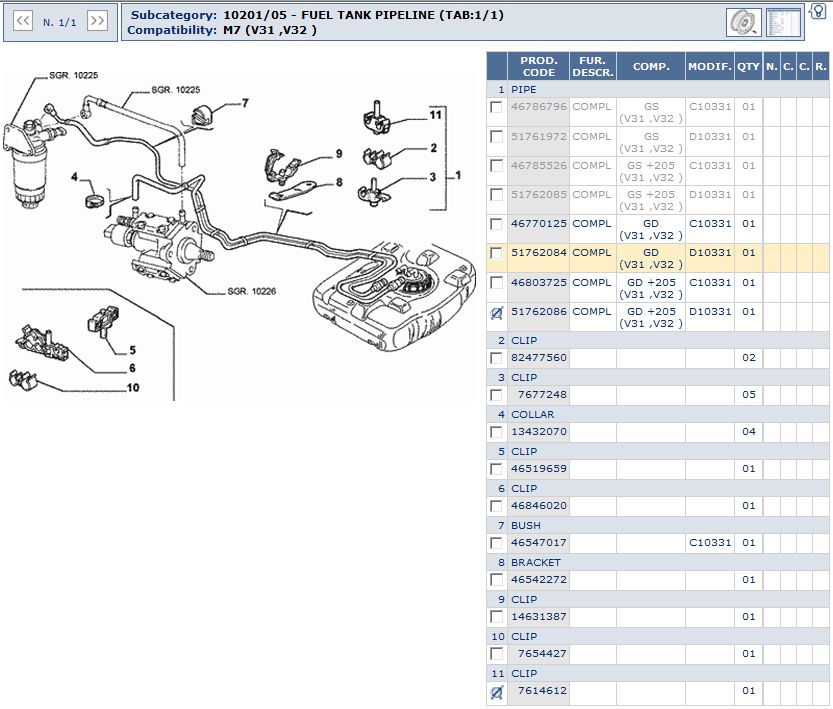

Hi, Welcome to the FF.
This is the parts diagram for a 55 plate Multi. It doesn't show any plastic pipes that fit into metal pipes.
If you want to PM me your VIN, I may be able to check it further for you.

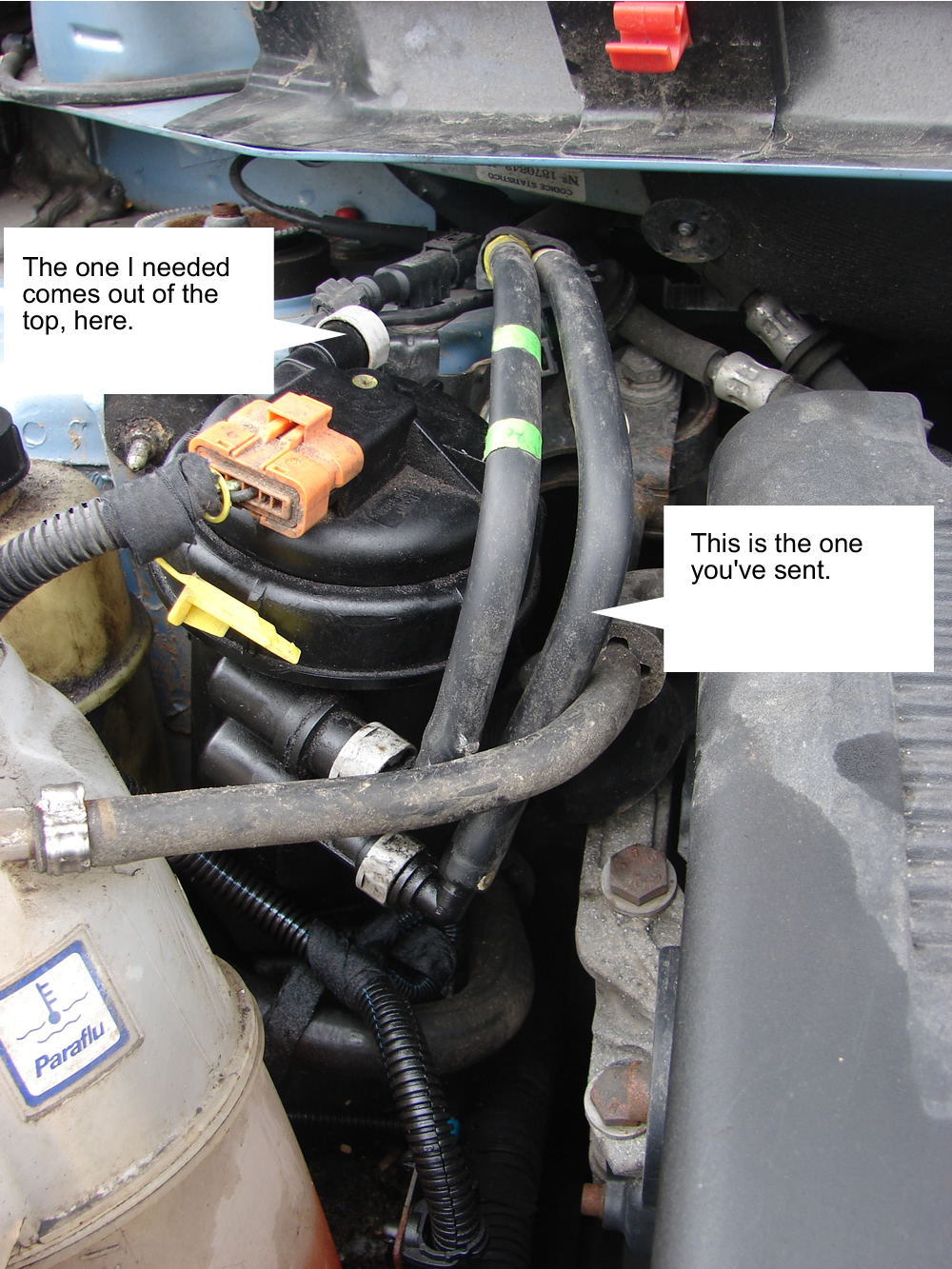

Hi Davren,
That's the picture the dealer sent me (by courier because they don't have any e-mail facility but could, however, receive e-mails!). :confused:
As you can see in that diagram, it looks nothing like the filter that's in my Multipla! Here's my fuel filter from another angle (attached).
In the diagram you've provided it looks more like a canister, but you can clearly see from my photo that mine's held in this black pastic housing with a screw top.

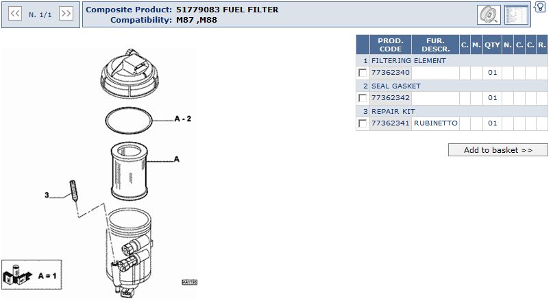

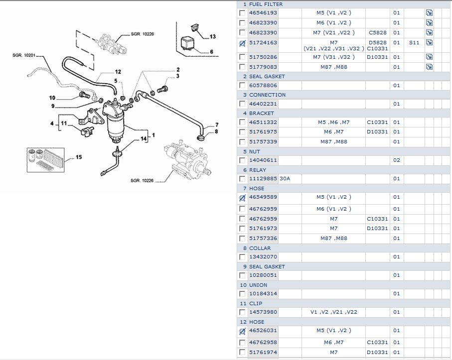

Found the diagram for your filter but it doesn't show the pipes for it. This filter is for the M87 engine (115hp for Belgium) and M88 engine (120hp except Belgium).
From my previous diagram at #2, there is only 1 pipe listed that goes to the top of the filter for the M88 engine i.e. part number 51757336. I think that is the pipe you need. Fiat price at 01/05/2010 is £20.20 +VAT.
The 2 wrong pipes you have (51761973 and 51761974) are for the M7 engine that has a different filter to yours.
The other part number you mention (51762084) is a complete set of fixed pipes for a RHD vehicle with the M7 engine, from the fuel tank to the engine compartment, as in this second diagram. Fiat price £87.96 +VAT.

Very strange...... according to the VIN you PM'd me, your vehicle has the M7 engine and the 2 pipes (51761973 and 51761974) should, therefore, be correct, but those 2 pipes are not correct for the type of filter you posted the picture of.
Only thing I can suggest is, that you suggest the dealer gets pipe 51757336 to try.
Is there any possibility that the engine and filter has been changed during the vihicle's history?
The diagrams are from ePER (the Fiat parts catalogue). If you want your dealer to see them, you could direct them to the thread at:

Can you post close up pictures of both ends of the broken black plastic pipe in your first picture.

The two parts I've already received, 51761974 and 51761973, attach to the side of the fuel filter. If you look at your diagram, you'll see the two connectors for those parts on the bottom right side.
At the top of that diagram though, almost hidden from view, is the connector for the hose I need.
Considering the car is only 5 years old, why does there appear to be so much confusion over this part? Is this what I should expect from Fiat? Tomorrow will mark 14 days since my first enquiry to the dealer, and Fiat, and I still have a dead Multipla on my drive.

I've attached a close up of the part that I need. Please note that this was in a thick black rubber sheath, but that was been removed by the fella that tried to help me fix it. Does this look like part 51757336?
Thanks again.
Nath.

It's very unlikely that the engine has been changed, I'm just 'clutching at straws' now. The confusion arises because the type of filter on your car is only listed for the M87 & M88 engines whereas it seems your engine should be the M7.
The right hand end of the black pipe in your picture doesn't look as though it has a removeable fitting on it. This would suggest that it's only supplied complete, and already fitted to, the long metal pipe that goes under the car to the tank. If that's the case, then that would be part of part number 51762084.
Sorry, I don't know what part 51757336 looks like, I only have the ePER diagrams to go by and ePER diagrams are seldom very accurate.

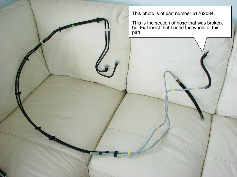

Part number 51762084 turned up today, from the dealer, and it's definitely the correct part. It's a bitter-sweet revelation though, because it's £87.96 +VAT!
My question now is, how easy would it be to find this part second hand? Any advice on where to look?
Also, is this part something I could fit myself? I'm no mechanic, and it's also fuel related, so I don't want to bite off more than I can chew and end up in even more of a mess.

Part number 51762084 should be a complete set of fixed pipes that go from the fuel tank to the engine compartment and fuel filter, as in the second diagram at #4 above. It looks as though the fuel tank may need to be removed or lowered to fit them. Most of the work will be under the car so you would need axle stands or a ramp to do the job.
So it'll have to go into a garage then. What a doze.
Could be close to a £150 mistake this! :eek:
Thanks again Davren.
Nath.
Here's a photo of part 51762084. As you can see, my friend only broke the very top section yet Fiat insist that I need the entire part. :confused:
