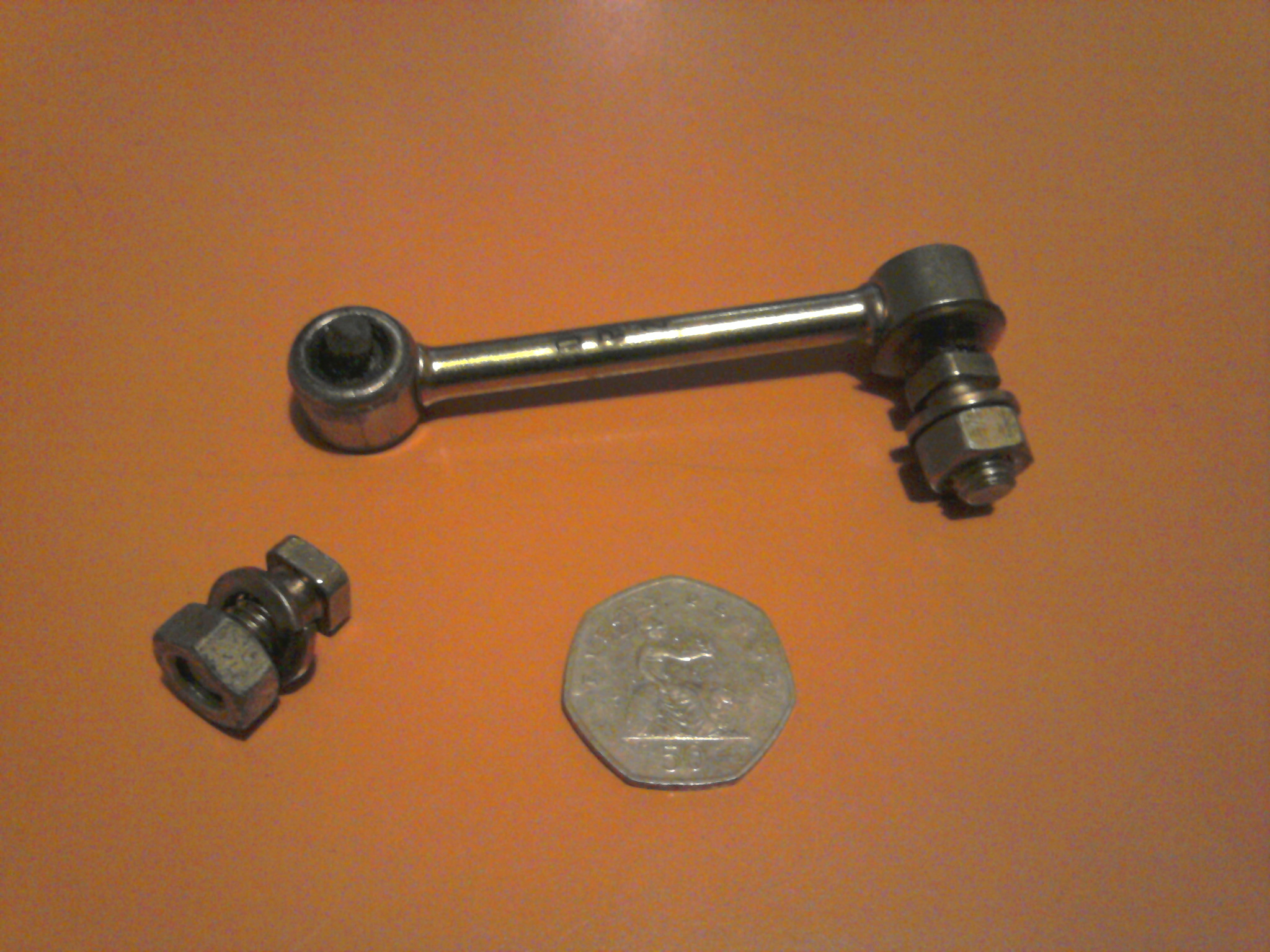

I have a 02 Seicento 1.1 Sporting (the newer rounded body type) and the clutch pedal is down to the floor. On inspection it is not the clutch cable that has broken but the 4 inch rod that connects directly to the pedal to a hinge at the rear of the footwell. The 4 inch rod has a ball joint and threaded bolt on either end and it is one of these bolts that has snapped, leaving the rod hanging down from the top of the pedal. Hopefully I have attached a pic. The broken rod is the blue in the pic.

OK folks I now have my car fixed and back on my driveway. I've driven about 100 miles in it since fixing it on Tuesday and 10 of them in rush hour slow moving traffic so I think I've licked it. I've attached a pic of the old broken rod.
I found the rod on a breakers near by from a Sei S model. There was also another Sei there that had the old style square airbox and I swear the rod was the same on that too. I didn't know where to look to figure the engine type or model. It was persisting it down at the time and I wanted to get on with the job.
It took 10 minutes to take the old one off and fit the new one. I did have an attractive assistant with small hands to help (it's very crowded at the back of those pedals).
Thanks go to "fingers99" and "Fluffy the Impaler" for all the information given. It was a great help.
@cc1 "Fluffy the Imapler's" parts list said that the part was different too but I'm not so sure. I can't see how the engine size would dictate this part. Although I am a home car mechanic newbie. He quoted £70 new from Fiat but I prefered £5 from a breakers as long as I took it off myself.
