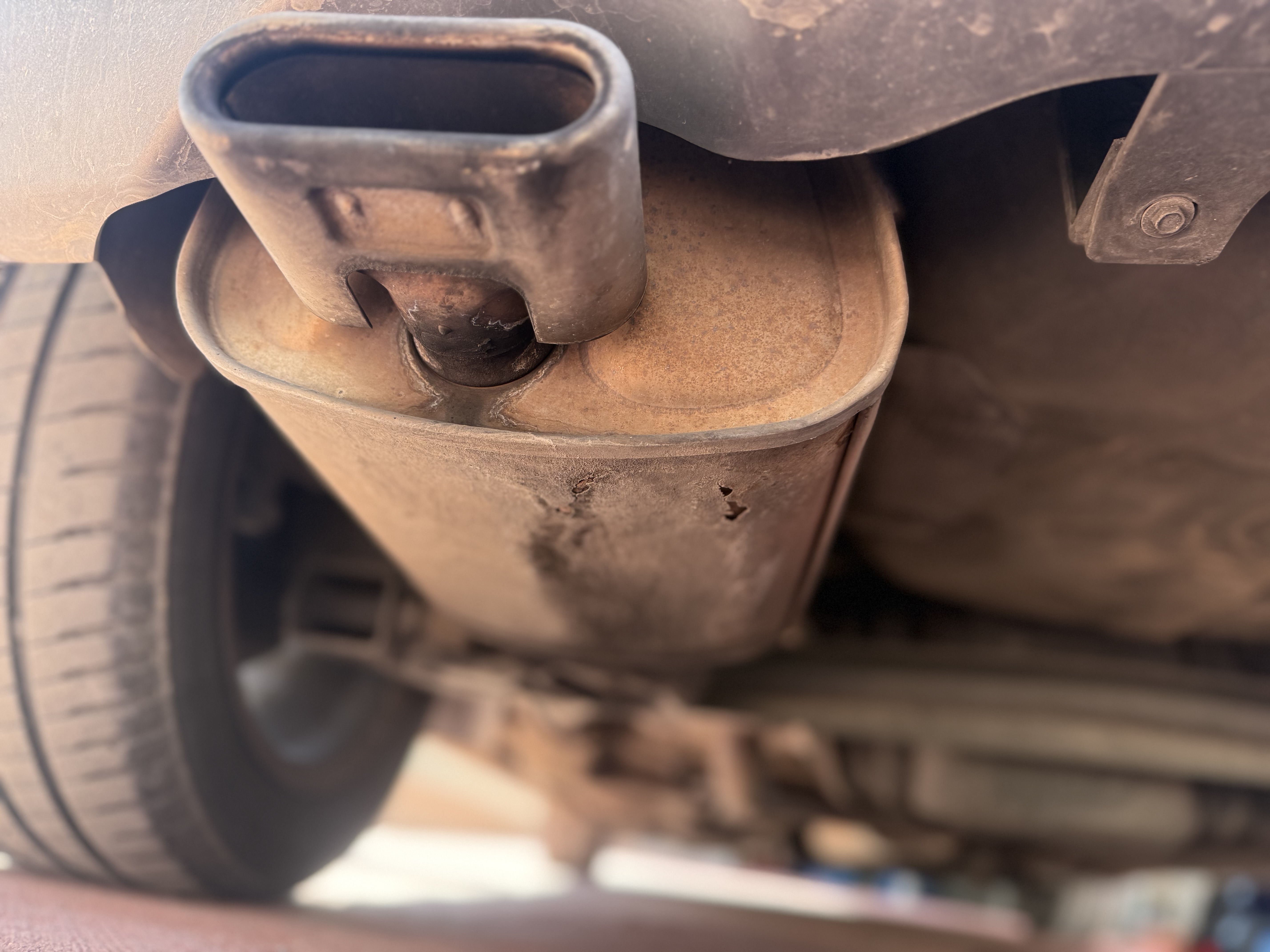

Oh dear it’s getting so noisy now at speed that my ears are hurting so I had to do something about it ! Went to fiat they want 415 euros for a brand new airbox so I’ll just do that. I had a good look at the exhaust in case it was that but other than some rust I can’t see anything terribly wrong with it

To positively confirm its the air box before spending lots, remove it completely, now drive the car on a short run, is the noise present in any way or totally gone?
You have a point but the airbox is completely broken so I’d have to fix it anyway :) I went to several mechanics (all Fiat specialists ) for different opinions they all said the same thing.
I can drive the car fine it’s just the noise that’s annoying I’m driving the car normally and my ears ring after a while!
