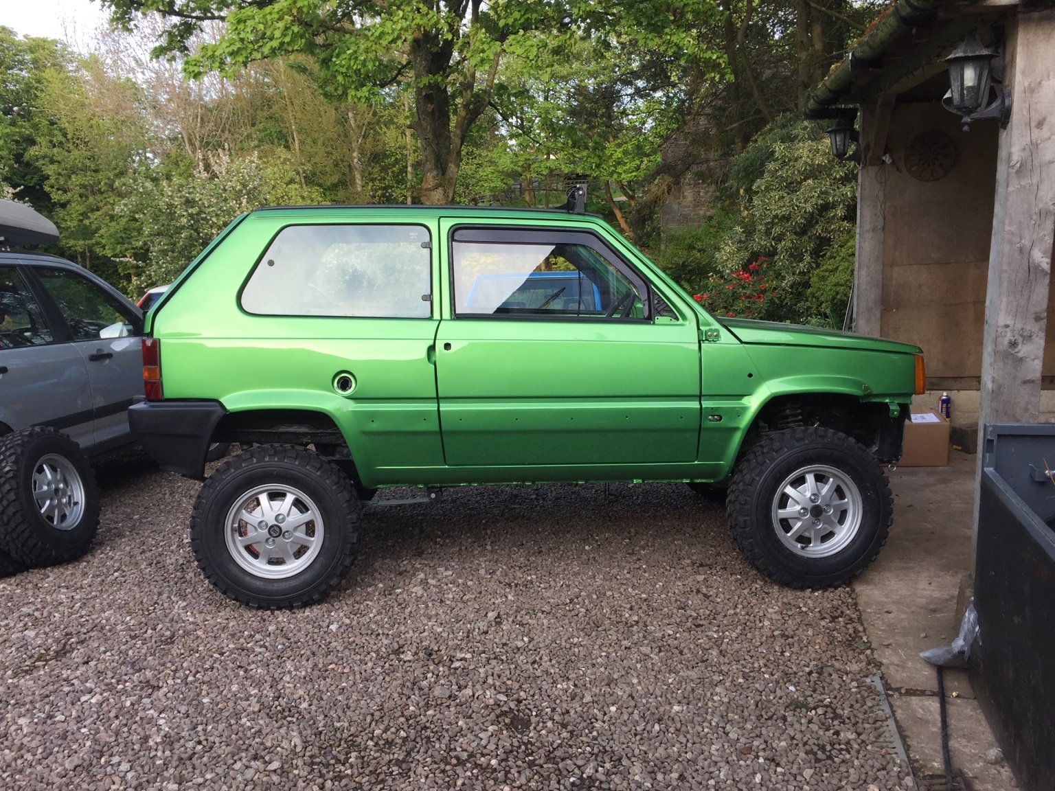

General Brian the BFP (Big Friendly Panda)- 1988 Sisley 4X4
Teaser...

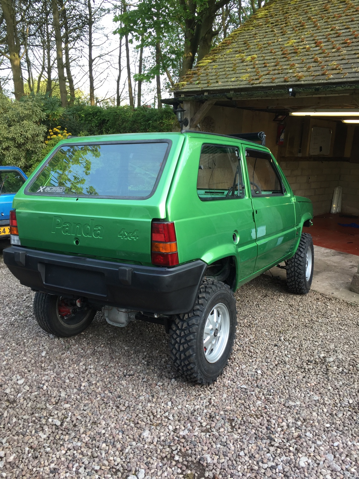

This little panda started broken and just a short ride from the breakers yard. A glance at eBay then rash purchase of 3 for £600
Has transformed it into a
Monster that Cannot be tamed every time a plan is made it somehow get larger or bigger or better just because " what if maybe if and why dont we ? "
Who only know where will it all end maybe in a new name !!!

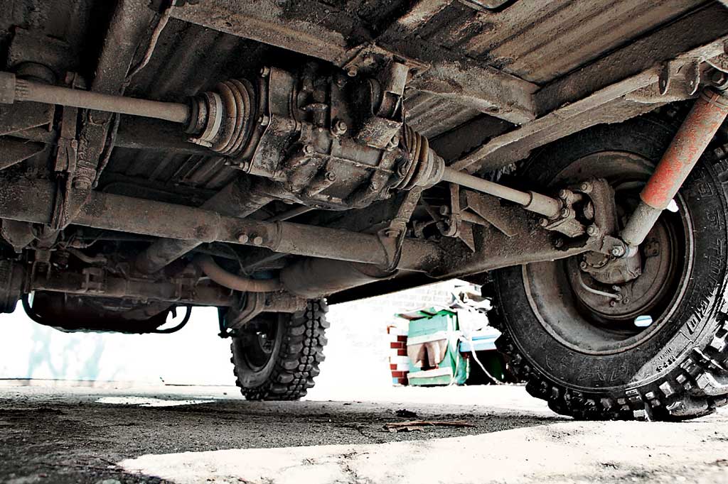

You need some of these portal axle hubs, at least for the rear as the solid axle ruins all. But you might strugle to find LUAZ 969 in UK.
How much of front and rear wheel arch will be cut-off?

Well how about mid engines dual I s front and rear 3 diff s with twin lockers say 1.4 16 6 speed punto laterally mounted using the drive shaft to front and rear ,
A guy near us has a full independent machine which has four wheel steer and hydraulic lift on all wheels that crabs at 50.% incline all indipendant brakes and selectable wheel drive. How far should we go ??next best just use the fiat stuff and keep the faith !!!

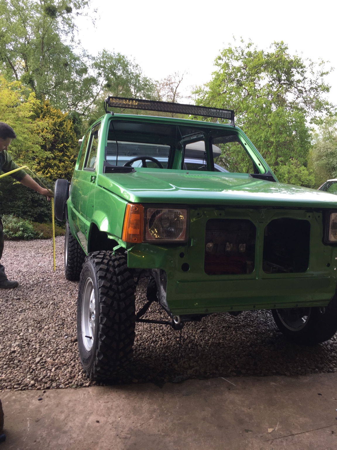

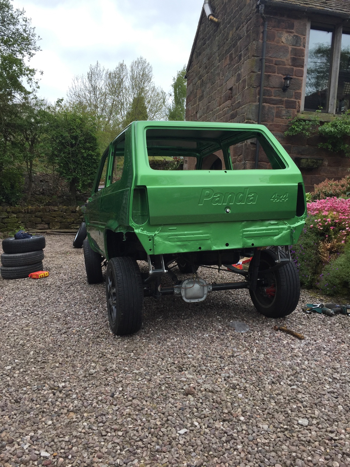

After all the work with lifting the car, the diff is the major problem. Thankfully the larger tires provide the needed clearance. 76mm over the standard 155/60..
No cutting is expected. 30mm movement of the rear axle provides clearance on the rear and the plan is to shorten the tie rods. Modified control arms push the front wheels further forward to provide needed clearance on the front. Exact distance to be clarified.
Cutting of the plastic bumpers is only expected to be necessary.
Can only really tell when it is dynamic though so we have to see [emoji1360][emoji1360][emoji1360]
