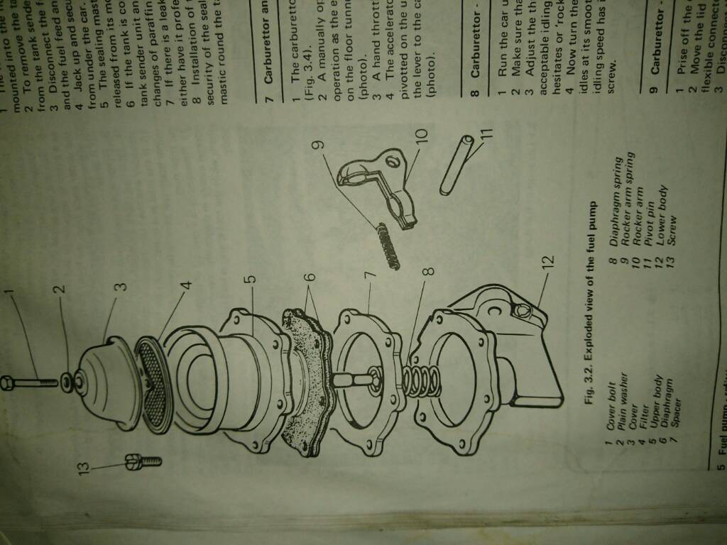

Stripped fuel pump and reassembled, doesn't appear to be damaged but very dirty, tested before reinstalling and there was no suction. Refitted and no joy. Do I have to do anything to prime it or refit to pump lifter in a particular way ? I think I will buy a replacement as try are so cheap ! There appears to be 3 different sizes in flange seal, .3 / .7 / 1.2 ! Will it make any difference ? Is there any point in replacing the lifter ? Does the lifter just pull out ?
The seals are for ensuring the pump rod projects the correct amount. Too much and it will break the pump, too little and it won't pump enough. Picture of instructions below

Thanks paolo, any chance of the top half of that page !
Non problemo. Its from a 126 manual so for a 650 engine. Same principles
