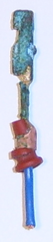

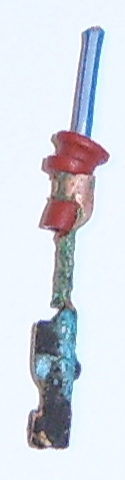

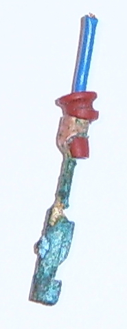

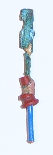

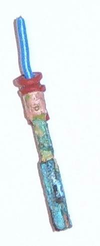

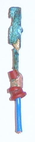

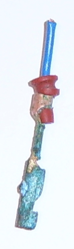

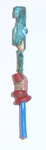

This is what happened to my Bravo:
On 12.01.2010 while I was driving at about 100km/h, suddenly, I sensed that I can not speed-up although I was keep pressing the gas-pedal. I took a look at the multifunction display and I saw the following messages on it:”ESP unavailable, ASR disconnected, Hill Holder unavailable, Check engine”. Meanwhile, the ESP warning light on the instrument panel comes on with fixed light. Also did the engine warning light.
On 12.01.2010 while I was driving at about 100km/h, suddenly, I sensed that I can not speed-up although I was keep pressing the gas-pedal. I took a look at the multifunction display and I saw the following messages on it:”ESP unavailable, ASR disconnected, Hill Holder unavailable, Check engine”. Meantime, the ESP warning light on the instrument panel comes on with fixed light. Also did the engine warning light.
Oh no, ****! It happened again today! Tommorrow I'll go to the service!
Well, finally my Bravo is alive again. I don't know for how long. I hope that it will be for good. The electric engineer has said: "The problem were from a connector wich has oxidized and this greenish oxide has made a short-circuit with the nearest connector. This short-circuit was made on the 5V circuit and has caused a drop down in voltage of around 1.3V. ABS, ESP, ASR, Hill Holder and air conditioning compressor are working on 5V circuit. Because of this drop down in voltage, everything related to this circuit run amok. This connector can be found in the area between right fog light and the air filter". Can you believe it? I attached some photos with the oxidized connector.
