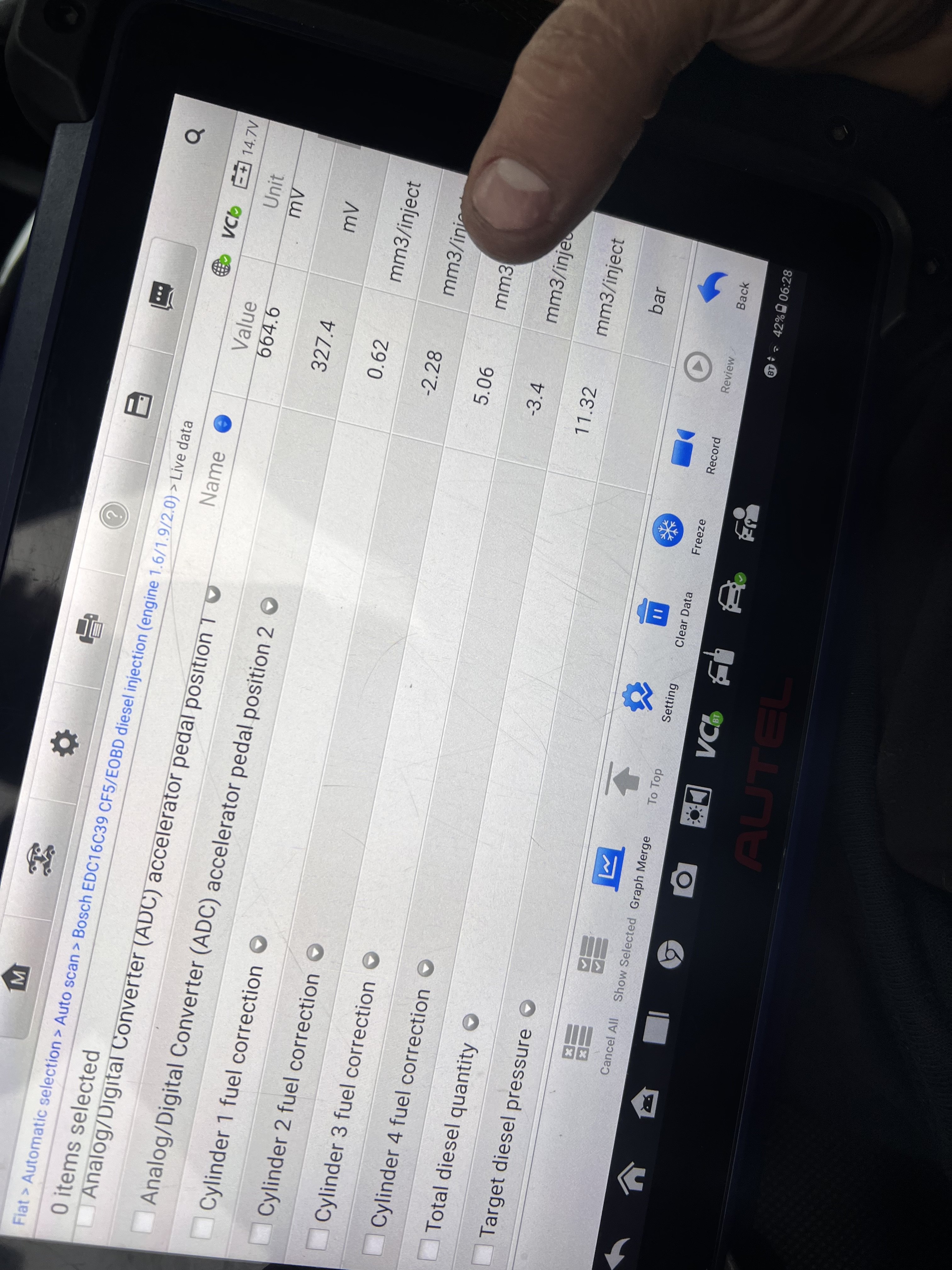

A Armelind Member Joined Mar 31, 2024 Messages 19 Points 86 Location Tiane Feb 27, 2025 #1 Hello, i test on autel injectors and these values i have. Car works lil bit hard on cold start. After temp goes near 70-80 celcius the rough idle seems to be quiet 80%. Model Fiat Bravo 1.6 multijet Year 2010 Mileage 228 Attachments IMG_8328.jpeg 1.6 MB · Views: 158
The Panda Nut Nutty about Pandas Infected by Panda virus and OPD Parked in the garage Written 5 guides Uploaded 10+ resources/downloads Written 10+ reviews Joined Jan 7, 2012 Messages 11,061 Points 4,458 Location East Feb 27, 2025 #2 If it were my car, I would have the injectors serviced with variations like that.
OP OP A Armelind Member Joined Mar 31, 2024 Messages 19 Points 86 Location Tiane Feb 27, 2025 #3 The Panda Nut said: If it were my car, I would have the injectors serviced with variations like that. Click to expand... So do you think they are good?
C ceecff Member Joined Mar 14, 2025 Messages 86 Points 69 Location Spain Mar 14, 2025 #4 Real bad corrections even if cold, it need to repair, anyway you could try injector cleaner in fuel, sometimes work.
