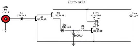

If you have blue and me you can't have an usb and the aux in at the same time working.
To have both working there is some electronic interface to be added in order to disable the usb from the blue and me to be disabled when there something plugged in the aux input.
It's something that someone with some experience in Electronic assembling can do perfectly although the wires coming from the blue and me interface must be cut in order to connect the Electronic interface which comutes between the aux input and the usb.
Another way is to connect the wires from the 3,5 femeal aux input directly to the wires in the radio conector and have a blank mp3 file loaded in the usb pendrive in order to activate media option.

I did a small Electronic circuit with 3 transistors 2 diodes, a resistor, a condensator and a relay and so far so good.
I'm sorry but I can't tell you where to buy the complete kit.
I used this diagram attached.
No problem, and cheers for the diagram! I've done a bit of electrical engineering as part of my degree so I'm sure I can figure it out.
