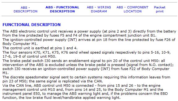

I've had that exactly same thing when power cable to the ABS controler had broken (worn against a metal edge) Strip, solder, insulate, protect and all went fine again :-D
Blown fuse would do the same I guess ...
