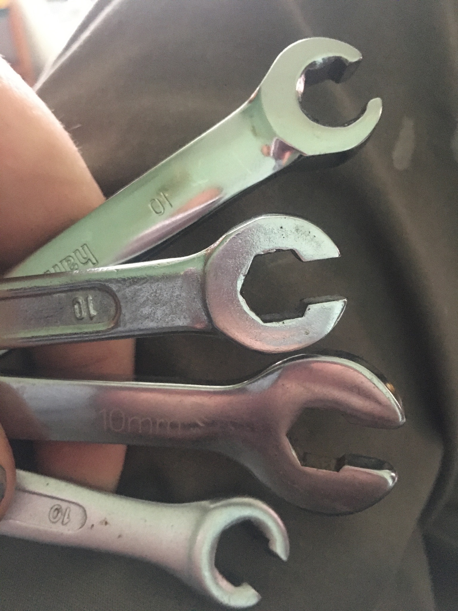

Some of these are rubbish
The Laser one fits the best. Could just be the luck of the draw.

My 12 mm was a online order from Halfords by the way. Rubbish, over size and a sloppy fit. Just happen to have in front of me and it measures 12.25 mm I nearly sent it back. It’s the only Halfords tool I have ever been disappointed with. Of course it could be just bad luck
They are all slightly over size but the better fit ones are 0.1mm or less doesn’t sound a lot of difference but you are much more likely to round off the fitting. It is noticeable in the amount of free wiggle
I have only two Laser spanner’s a 14 mm combo and a 10/11 mm brake flare both are good on size and finish, again could just be the luck of the draw as it’s only a sample size of two
