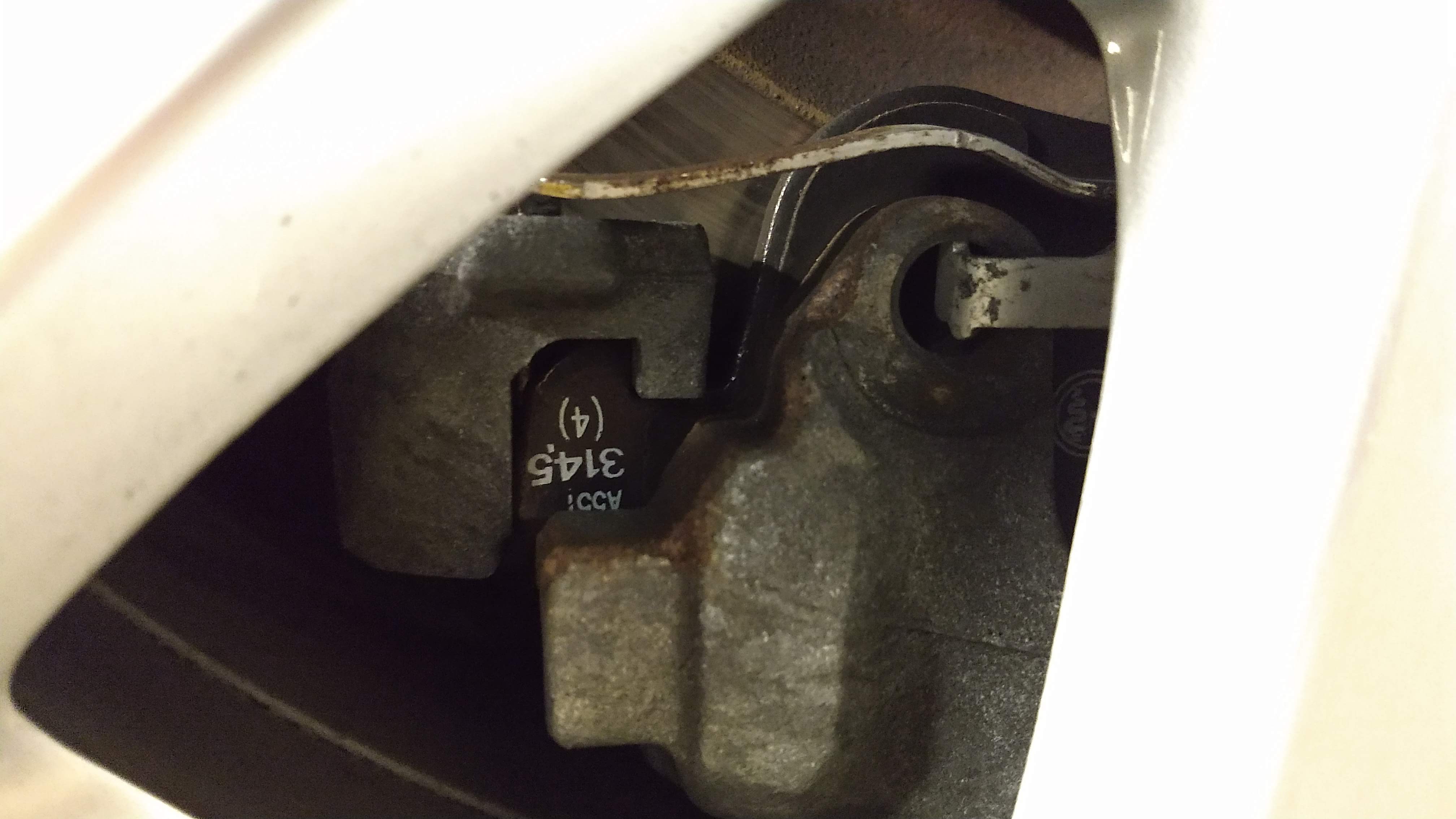

Hi, my van is a 2017 Fiat Doblo XL. It is a conversion camper van.
The brake power is bit of weak when doing emergency brake sometime, so want to have an upgrade. The current pad is the stock FIAT pad from new car, with 284mm disk and stock single pot caliper. Wondering any improvement if I upgrade to this Brembo pad?
Brembo P23137, WVA No: 23708-23709
Also attached the brake pad photos on my van
Thanks!

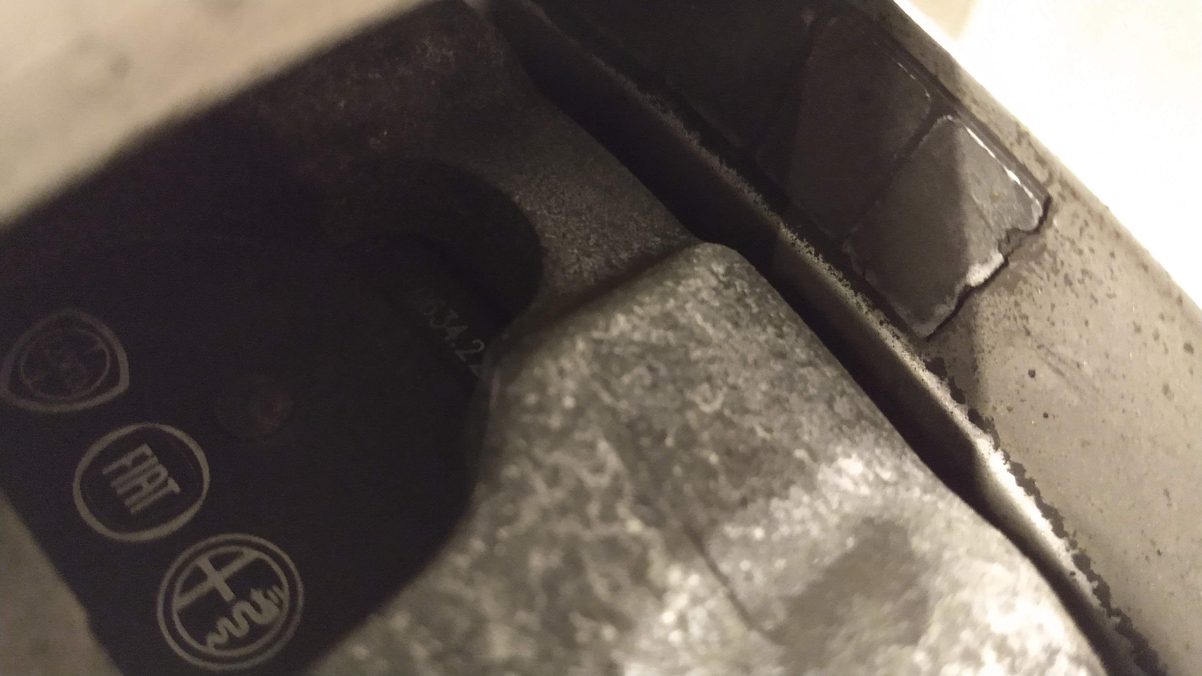

Finally I bought this one from Amazon
Ferodo FDB1467 Brake Pad Set, disc brake - (set of 4): Amazon.co.uk: Car & Motorbike
And take it to my garage and hopefully get a fitting, but my garage just told me it doesn't match the shape of my brake.
Here are the photo from my brake, any idea what is the manufacture of it (Bosch, ATE, etc?) and any idea about the OEM number of the pad? I can confirm the disk size is 284mm
I told my VIN number to the CS in https://www.autodoc.co.uk and the CS say they didn't find a record (strange)
and if I search Doblo 1.6 120ps here are many different pad
Thank you in advance.

the backing plate of the FIAT pads looks brand new.. if that set of pads fit..
Cross reference that part number..
But the manufacturer is normally cast into the caliper housing.
Bendix or Bosch.. as examples.
Generally the silhouette : profile of the pads backing plate is quite different:individual..
That is how I got correct pads 1st attempt for my panda
