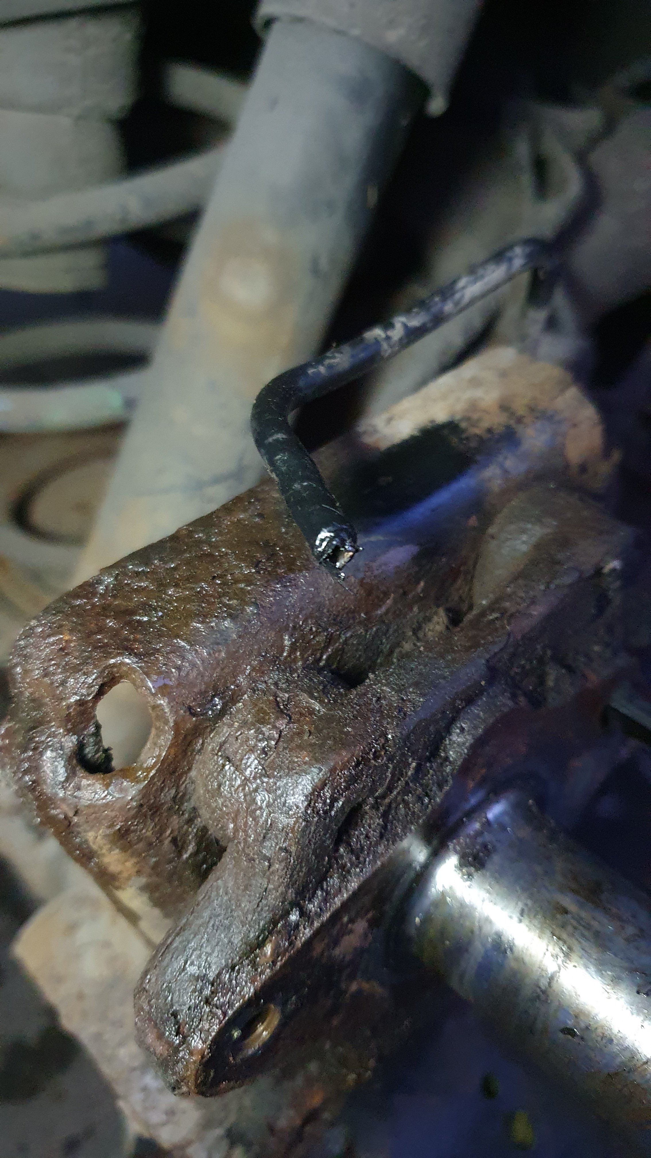

Hello, I finally got on to doing the driver's side rear brake, after having done the passenger's side back in November. But this time I snapped off the brake line while turning the flare nut of the brake cylinder (please see photos). What are my options please? Thanks for any help.

Fairly typical, which is why it's best to hold the nut still and twist off the wheel cylinder
Too late now but no big deal
Carefully undo the other end at the flexi (hopefully)
And either make a new pipe or take the old to a motor factors and they will make a new one up
The very worse case there is another joint half way down the car but this will require two ridged and one flexi
