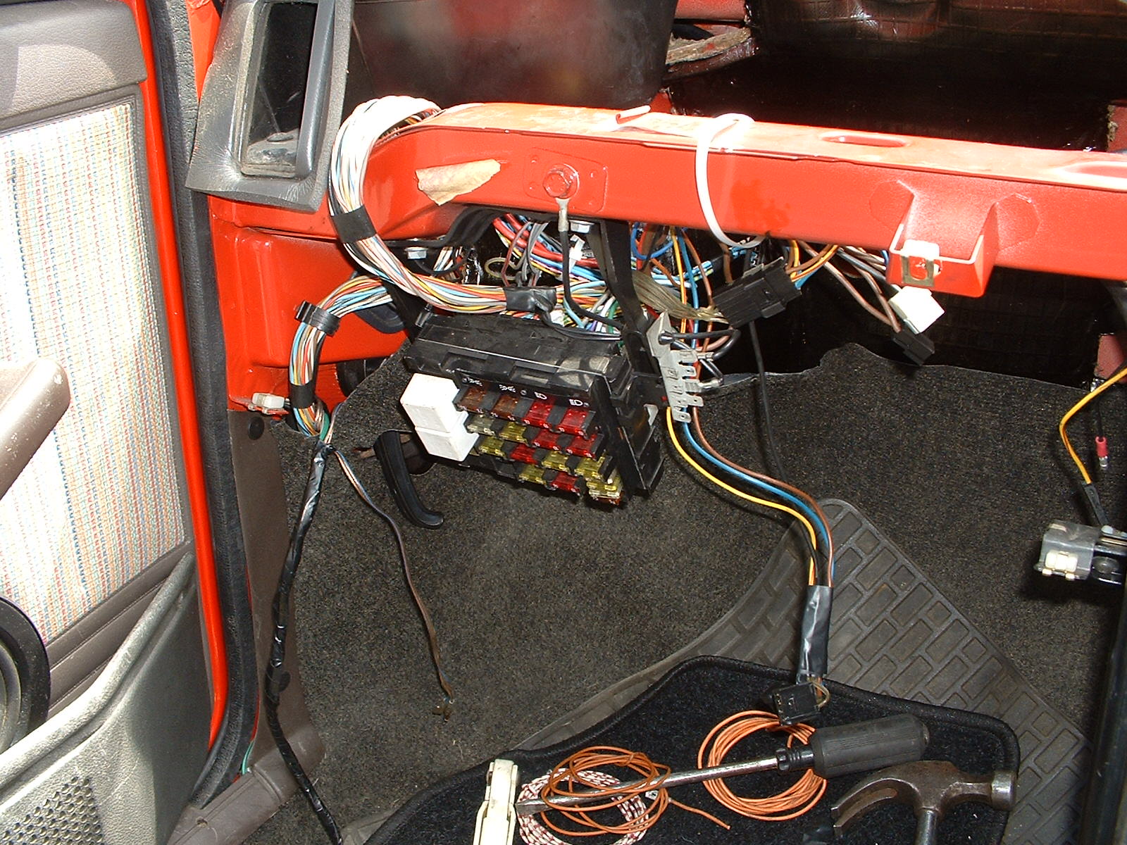

Are you sure you're not getting mixed up with the relays? :confused:
Pic of the fuse box in my 45S mk1 below (n.b. dashboard removed!)
Well if you can see the fuses then just check if any are blown o.0
They should be pretty much see through, if you can't see through them then just take one out at a time, have a look to see if it';s blown and if not then put it back, you could also check the bulbs and yes it is a posibility that the brake light switch on your peddle has broken, mine did, it takes about 20-30 mins to fit it and is just plug in, cost me about £7-9 so you can check to see if it is the switch first by dissconnecting the plug from it and bridging the connection with a paper clip or wire.
