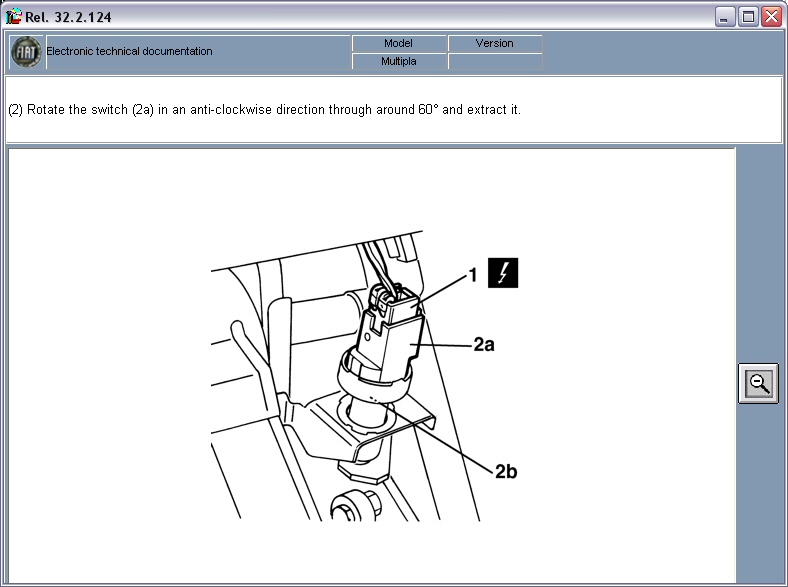

Many thanks for that, I was looking on the hydraulics, so shows how long since I've done this. I found the switch without a problem (one of the easiest dashboards I've grovelled under), and it was indeed causing the problem. But for the life of me I cannot remove the darn thing, it seems to be a bayonet type fitting with a raised locking lug; any pointers please.
This attached image is from the workshop CD. It says to use a spanner on the flats on the switch to rotate the whole thing through about 60 degrees.
hth

Once you've twisted the switch out, hopefully without breaking too many of the lugs, you can dismantle the switch , IIRC by unclipping the 'lid' of the switch (and catch all the springs and plates if they fall out). Then you can clean up the contacts/plunger and put it all back together:D. Well, it worked for me on my 53 plate.
