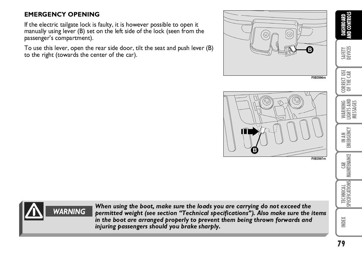

recently received my 2005 eleganza from fiat dealer for service and they stated, a needed replacement of a front wishbone at £350> Now boot not opening. dealer says probably microswitch and would cost £80 with a warning that panel damage might be caused because they would have to open the boot closed ? Help ?
Hi James, Welcome to the FF.
There shouldn't be any panel damage. According to the owners handbook, there's an emergency tailgate opening lever on the lock.
Dave.

Thanks for the Pic Davren. It's an old post but without it I couldn't have opened the boot.
Now I know I can do that I'll wait untill it is less snowy to hang about taking the microswitch apart!
