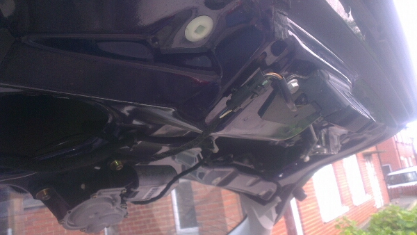

Also the tailgate release switch doesn't work with the individual boot menu switched to OFF
. Checked fuse and its fine not blown , so looks like electronic latch??

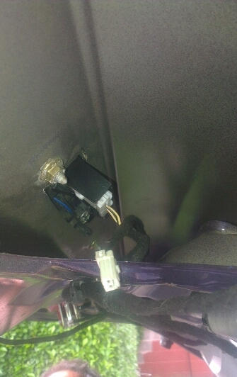

Found a cable loose inside the boot door which i have no idea where it goes to as there is no empty connects :confused:
Second picture just shows the there is a cable going to the boot latch

This cable for Multiwagon
