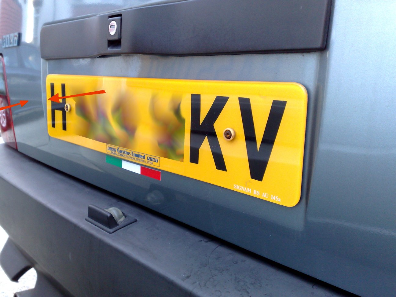

Theres a very slight horizontal fold 1/2 way down the number plate, its easily put in to a flat sheet.
You can then cut out the original plate indentation (so its no heavier than original).
