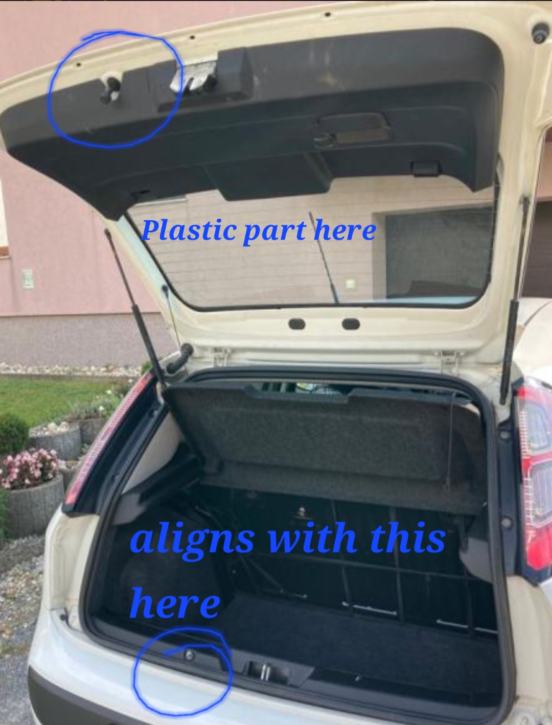

I could be way off the mark here but I once had this issue where my Punto's boot wasn't latching and it was having to be slammed shut and then hard to open and it turned out to be this plastic part pictured, it was really loose, once tightened, all the problems stopped.
I could be way off the mark here but I once had this issue where my Punto's boot wasn't latching and it was having to be slammed shut and then hard to open and it turned out to be this plastic part pictured, it was really loose, once tightened, all the problems stopped.View attachment 473957
Thanks for the reply, I wish that was the problem haha. I checked and I’m pretty sure it aligns, the knob thing is tight too.
