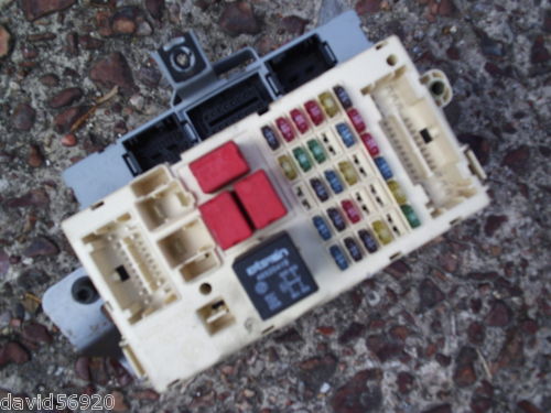

Can anybody please tell me where the body control module is on a 2006 Stilo JTD? Would i be right in presumming that it is actually the fuse box behind the battery or is there another module somewhere?
Thanks in advance.
Mick
It's the grey box on the back of the dashboard fuse box.

Cheers for that. I will pull it out this weekend an have a look. It appears I have a communication fault between the dash, engine ecu and body module. Not sure where to start really but the body control module sounds like a good place to start.
