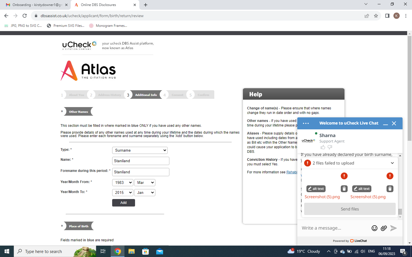

Hi Farrah,
I am trying to update blue & me as it won't find my phone I have a redmi note 11 pro 5g. My car is a Fiat 500 reg is LG59 XCE if that helps. i also have a Samsung Galaxy A14 for work that won't connect either. I got the files from this site for the update and it said on the instructions to just plug into the usb port on the car turn ignition to MAR and it would automatically update.
Would it be possible to email me what I have done wrong as I'm out at work all day and don't see notifications on her, if that's ok. (i'm a 1:1 teaching assistant so don't stay in one place).
