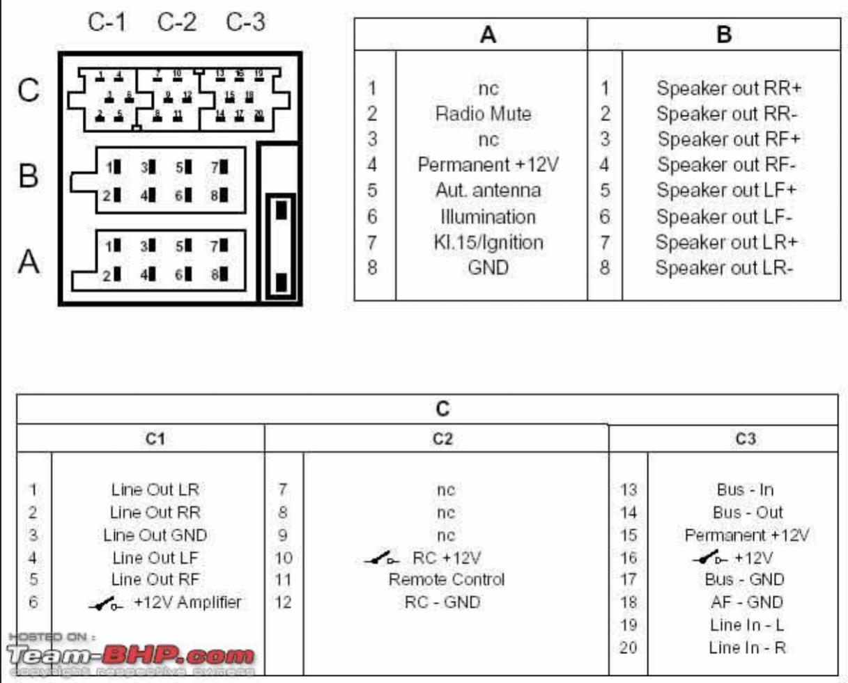

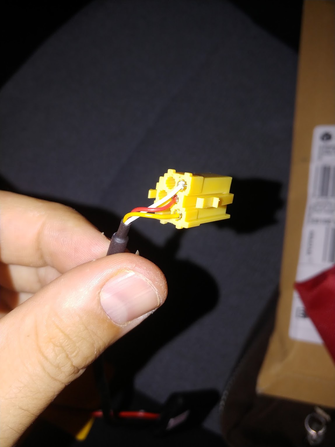

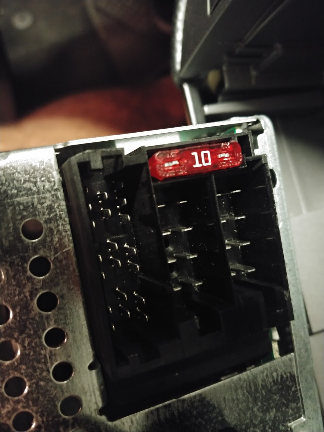

I attach five photos to this post: the adapter, its yellow connector, the inputs of the autoradio, the cables of the ISO connector, and the electric diagram (assuming it is the correct one).
1) The audio issue
Since the cd charger uses 8 pins, I can plug the 6-pin yellow connector of the adapter only either on the "line-out" or the "option" input. However, if I plug it to the "option" input, the bluetooth adapter works and I can listen the music coming from my phone via bluetooth, but the autoradio is stuck on the "phone" source and I cannot switch to radio! On the other hand, if I attach it on the "line-out", I can select "CD", "radio" or "AUX" as sources, but the audio of my phone does not pass through when the radio is on "AUX" (despite it is connected).

I joined the red little cable of the adapter first to the red-green cable shown in the photo and then also to the yellow cable: in both cases the adapter receives electricity but also when the car key is not inserted. How can I power the adapter so that it switches on only when the car key is inserted?
A solution that comes to mind is to buy a 8 pin connector and add the red and black cable within such a connector, but I am not sure it would work. Does anyone have suggestions?
