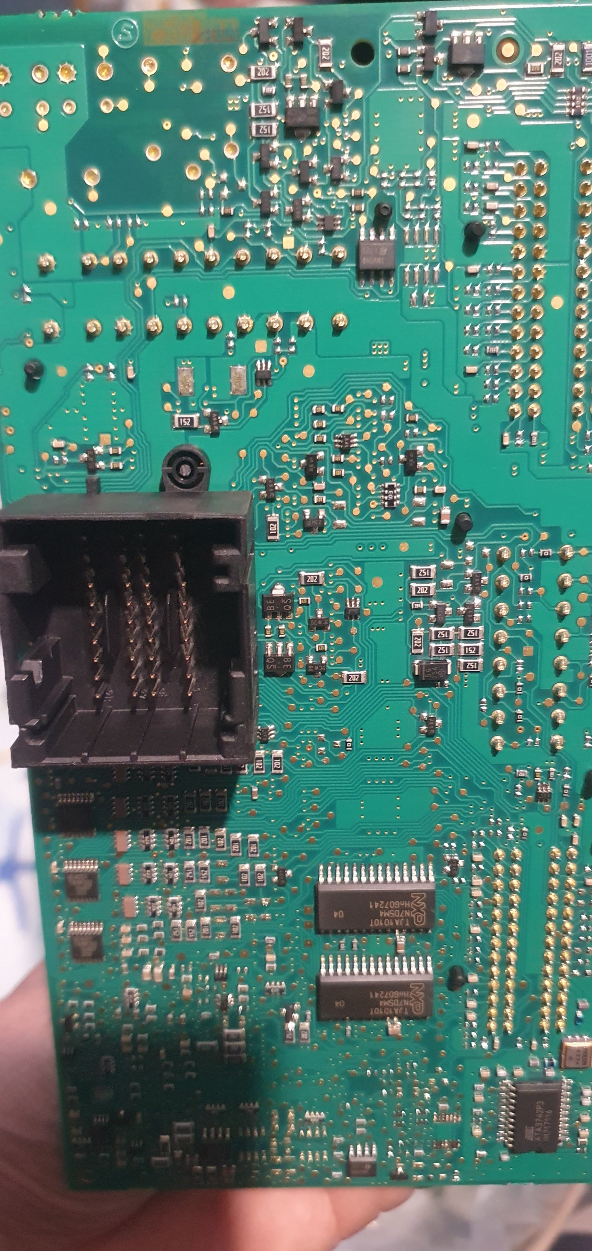

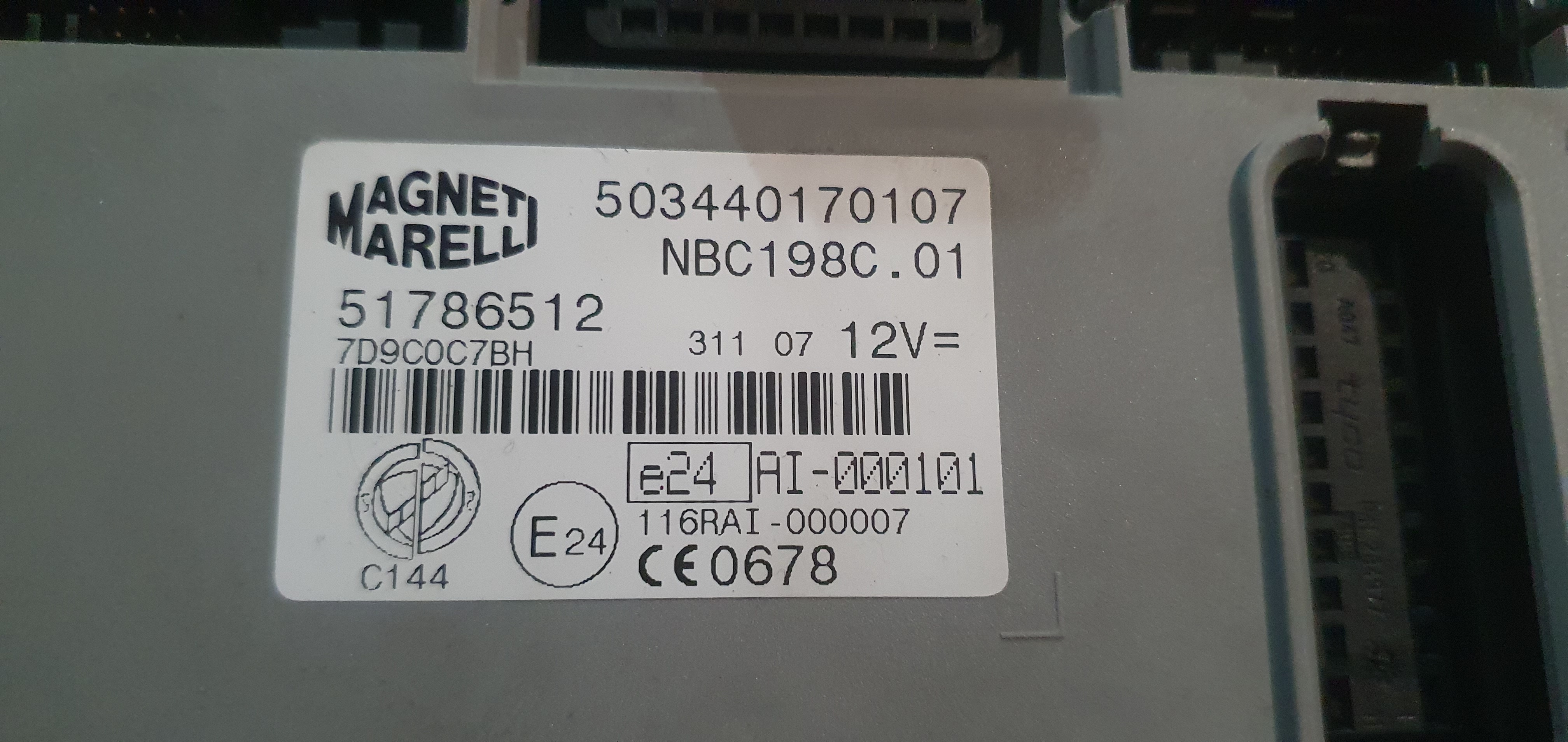

I have a 2008 Fiat Bravo with Magneti Marelli BCM and after changing the immo data the fuel light started flashing and the car won't start. Does anyone know how to revive it? If I program the eeprom will it work again? And which eeprom has the immo data.
I'm attaching photos. I appreciate your help.

Depend on what did Autel... it could have damaged engine ecu or body. First check engine ecu connection and immo status with Multiecuscan, if all ok then you could need rewrite body eeprom 95160 with donor to check if connect again and after try recode, virgin etc.

You writed mod file, do you have the ori eeprom backup 2kb? You can restore now. If not backup then check ecu tuning sites with your BCM p/n, in worst case buy full BCM unlocked (could need virgin engine ecu).
