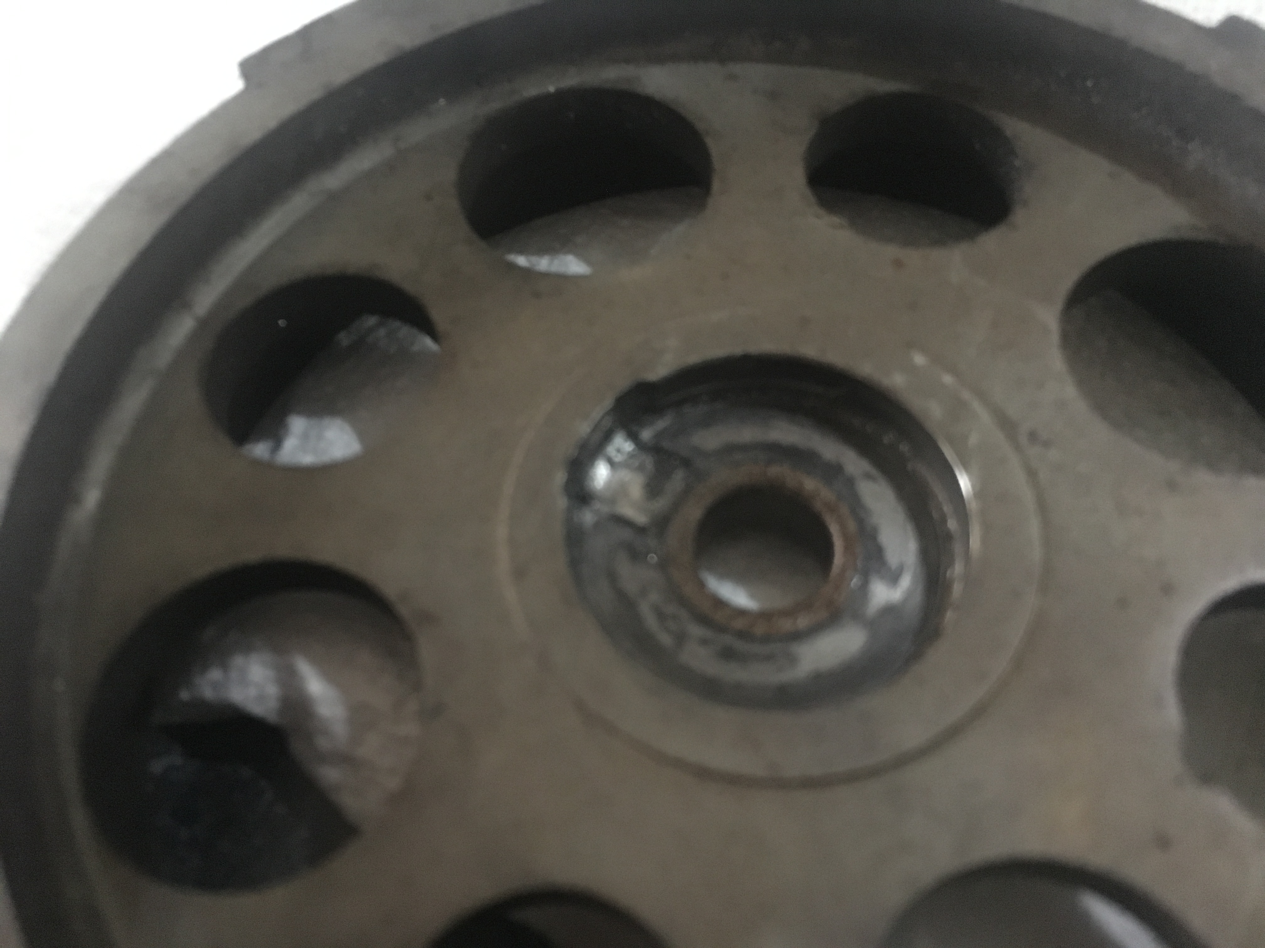

I might just have got away with it..... took head off... while doing so had a feel of the cam belt it was loose... looked at the top pully it was hanging off the bolt was out about 8mm i undid the bolt with my fingers... and top pully fell off in my hand.. the last owner (ive done around 500 miles in it) did have it in the garage to have the cam fitted... so it looks like it's either not been tightened up correctly or it's come loose.... its spun the key pip off the top pully and its just been spinning not turning the cam at all....... so had head off and not one mark on any valve or piston.... so im going fit new head gasket set/ pully and cam belt.... what do you reckon ? Thanks Ade

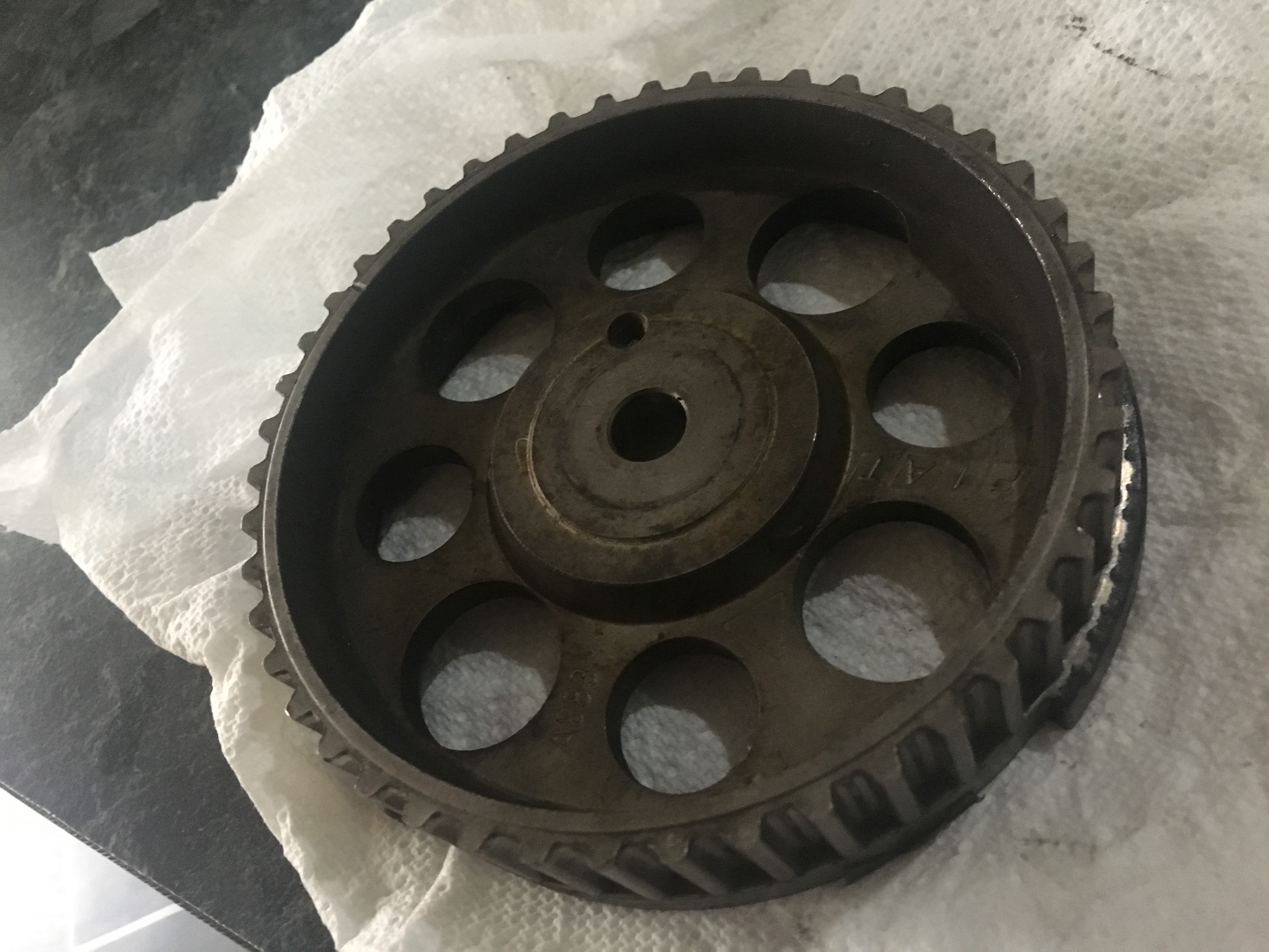

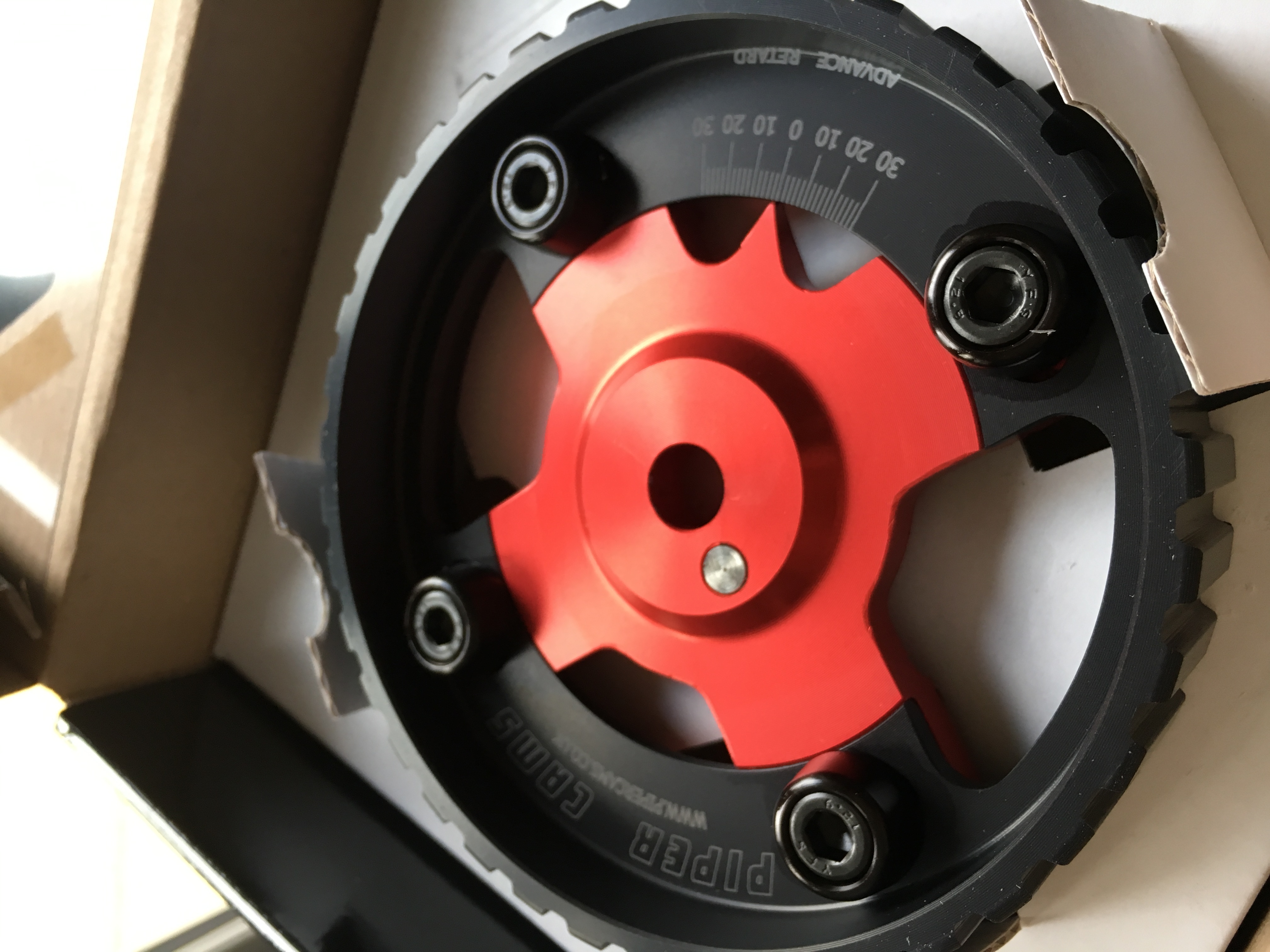

Quick Question .... I have a Vernier Pulley (bought brand new) from Piper... but the belt and pulley wheels on my car is wrong it's a 2002 mk2 punto 1.2 8v mpi engine..... can i fit the right cam sprocket to the crank and the correct cam belt to suit ? or im i talking rubbish ? ... is it the older kit i need or the 1100cc ?.. thanks chaps

old cam pulley and the new one i would like to fit ..

So leave that side of things standard then ? ... Ordered another Cam pulley... all the bits to rebuild will be here by Friday... have Fri Sat and Sun off work so it should be up and running this weekend.

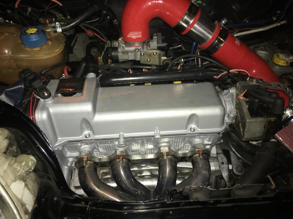

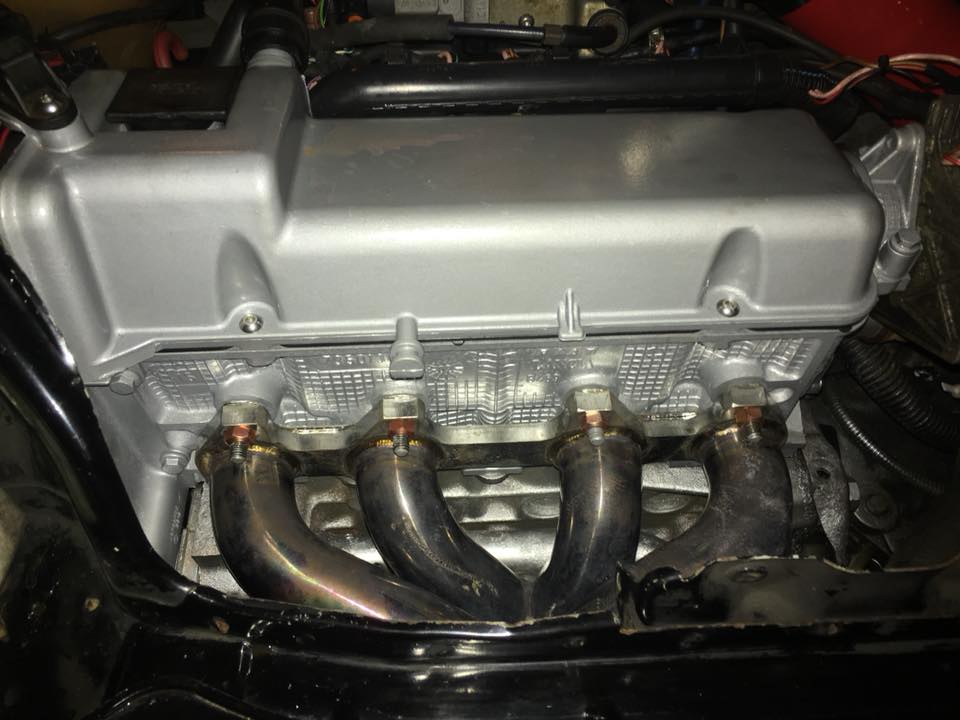

Left it as standard... new cam pulley came today, had head skimmed to max, put it back together today.. all is well well coat me £100 ish inc new studs.. painted a few bits... spant all day nice and steady doing the work.. car is ace again !
