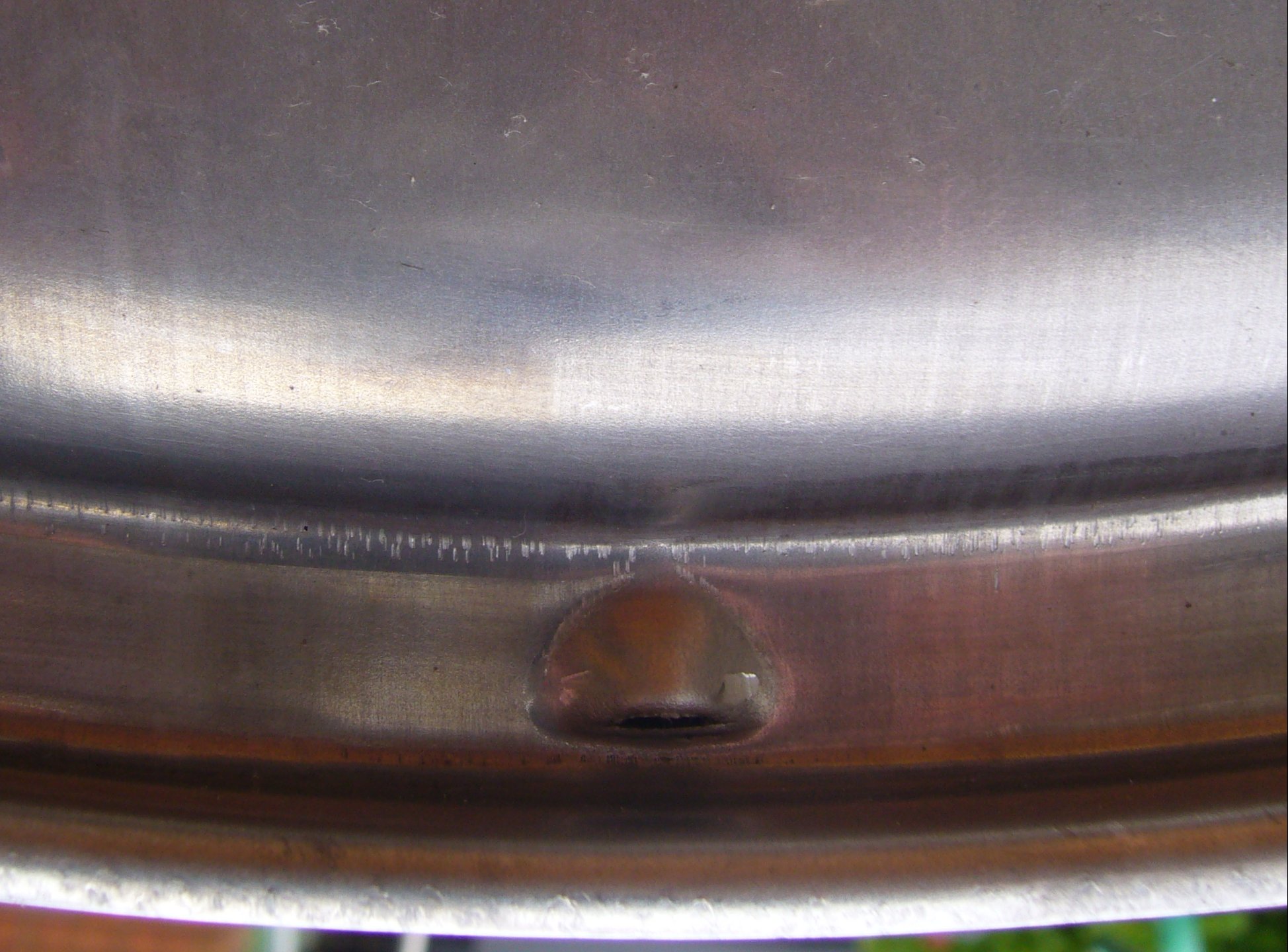

Hi my twin air long middle box has two drain holes at either end and both are sootes uplike in the pic mine pops farts all day a bit like a briggs and straton mower..
Most exhausts have drain holes these days, and they generally collect quite a bit of soot; it can fool some folks into thinking there's a fault with the system when there isn't.
Here is a picture of a drain hole, from this thread.
