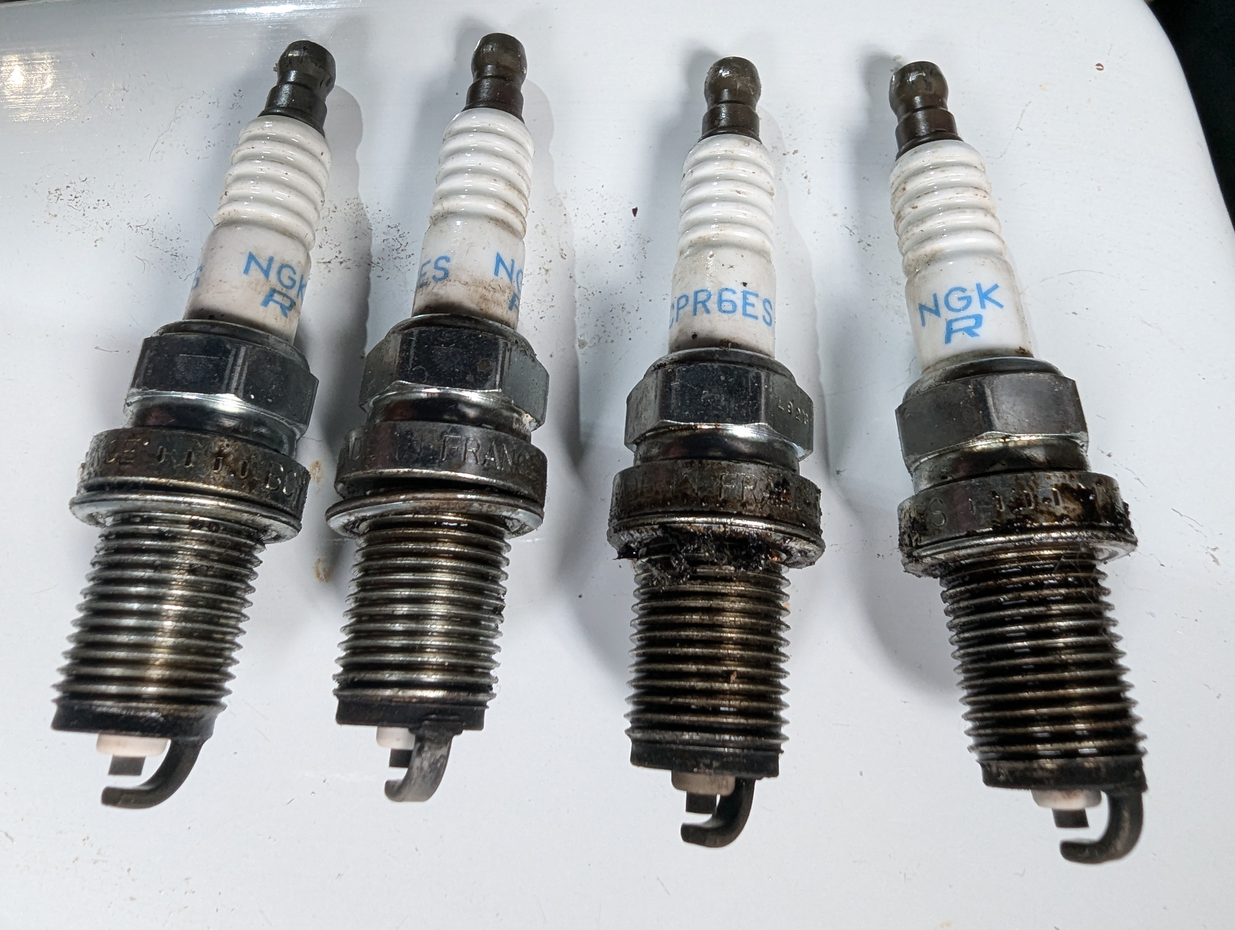

But just before we got home the car was loosing power and it gave a puff of black smoke and it just stopped. Since then I replaced the sparkplugs and checked the fuel lines if something was blocked. The fuel lines where working. While changing the sparkplugs I noticed that the was a bit of oil on them and that they where sort of black. When I try to start it, it sometimes manages to sort of start but stops after 10 seconds and it doesn't sound like it supposed to. So fuel goes through it seems like there is ignition but it won't really start. Does anyone have suggestions.

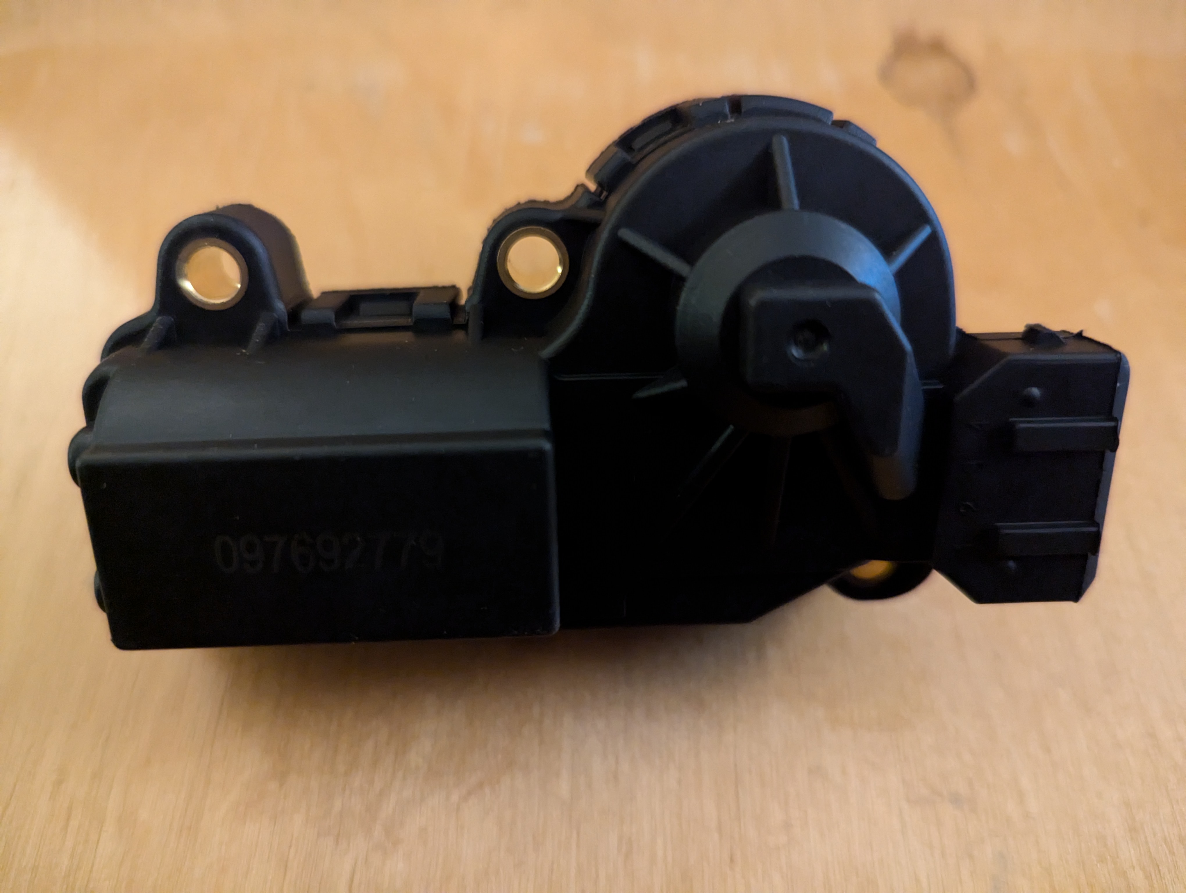

Wow thanks for the feedback. So it's this part I need to replace: https://www.ricambio.co.uk/throttle-body-stepper-motor-classic-fiat-panda-uno-lancia-y10
it looks to be correct. though the 2 part numbers differ on both styles of throttle bodies (one is 9945024 and one is 9942142) they both appear to be the same electric motor.
my advice would be to examine which throttle body looks most like the one you have, and go with the part number to that one.
it looks like you should be able to tell them apart by the place the vacuum lines plug into it. one has 2 outlets, and one has 3.
hope this helps!
also if you take your motor apart you will see it will be all burned out inside.. my one was. this is caused by the little switch on the end of the plunger that presses on the throttle cable winder. the switch fails making the motor keep twitching or trying to return back and never turning off so it stays on trying to return back when its already at the end of its travel.

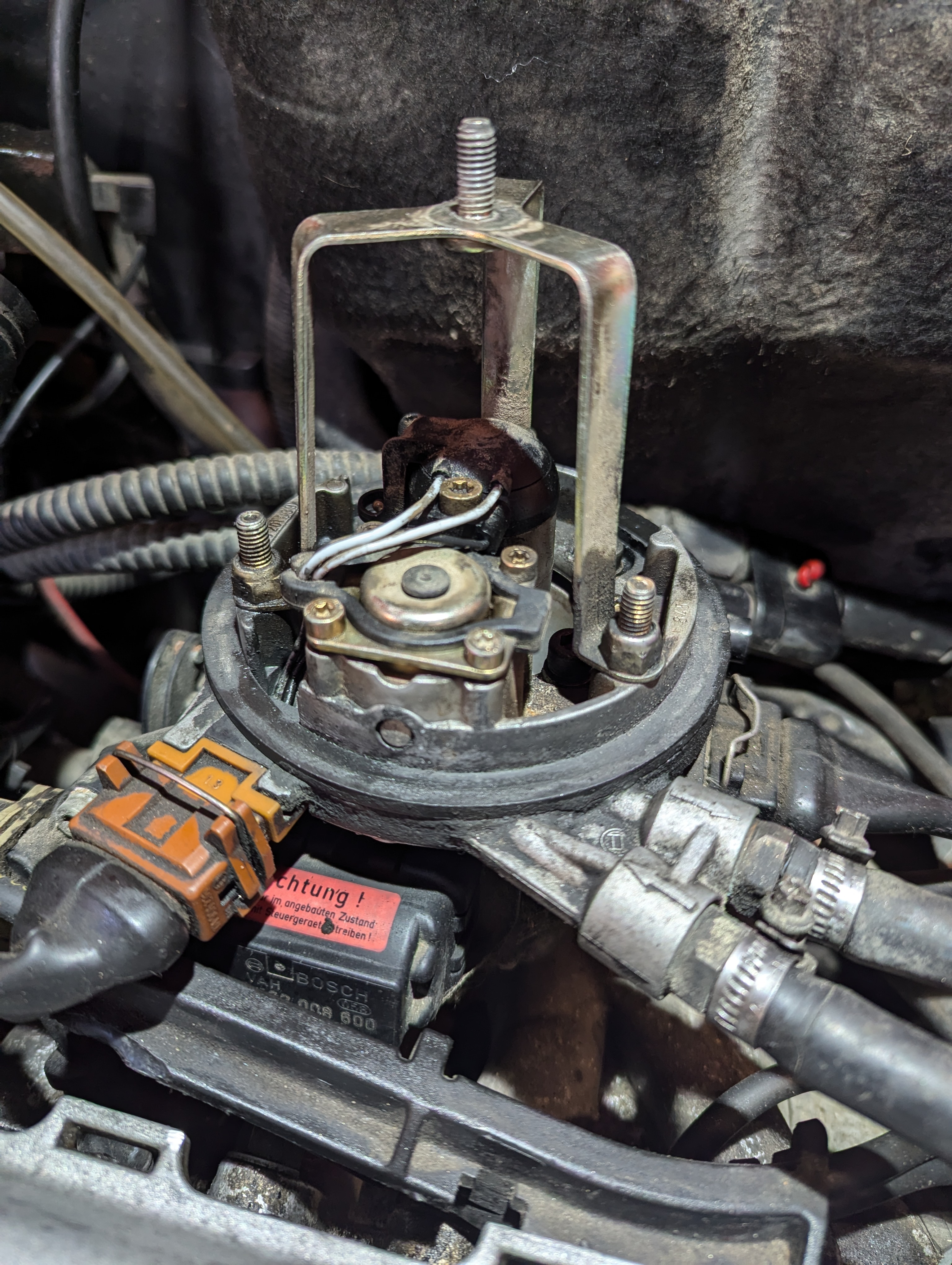

So I checked out the throttle body and now it seems I have the one one the second parts pdf you send me. So I googled the electric motor and I think I found the one I need. https://www.ebay.co.uk/itm/276515474795 Do you think so too? If so I'm going to order it and maybe also change the lambda sensor because that one also is involved in the air fuel mixture. And I'm going to change the rocker cover gasket to prevent oil leaking into the sparkplug holes. I'm not a seasoned mechanic, so wish me luck 😁

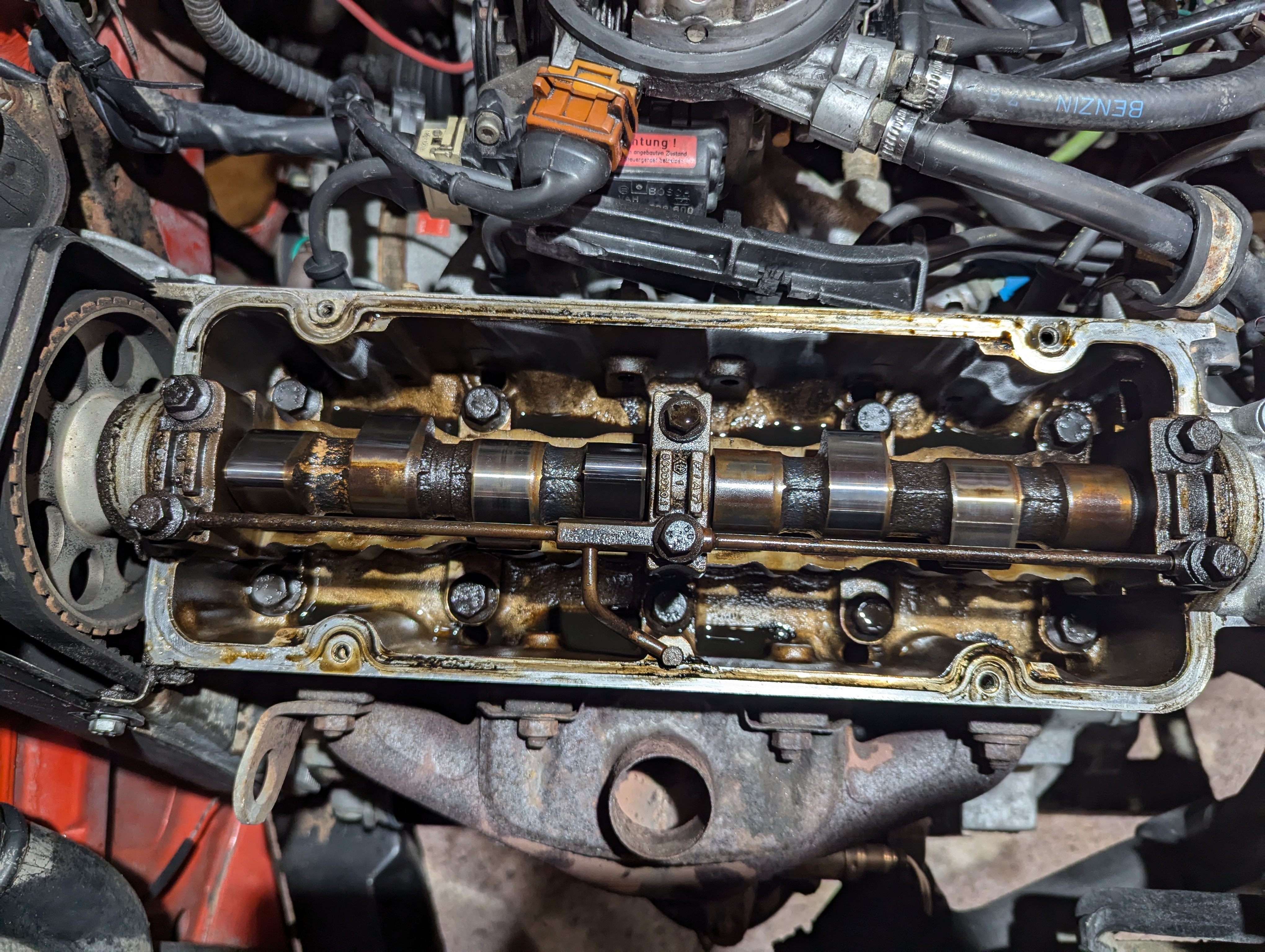

Hi I'm replacing the valve cover gasket. The engine block was black and greasy. And the sparkplugs were also black, maybe from oil leaking to in the holes.
I just cleaned the whole engine bay. I figured that I would be easier to see if the gasket would leak again. It's my first time replacing a gasket. But it seemed a simple task. So I just took te cover of and I was just wondering if this is the way it supposed to look down there.
