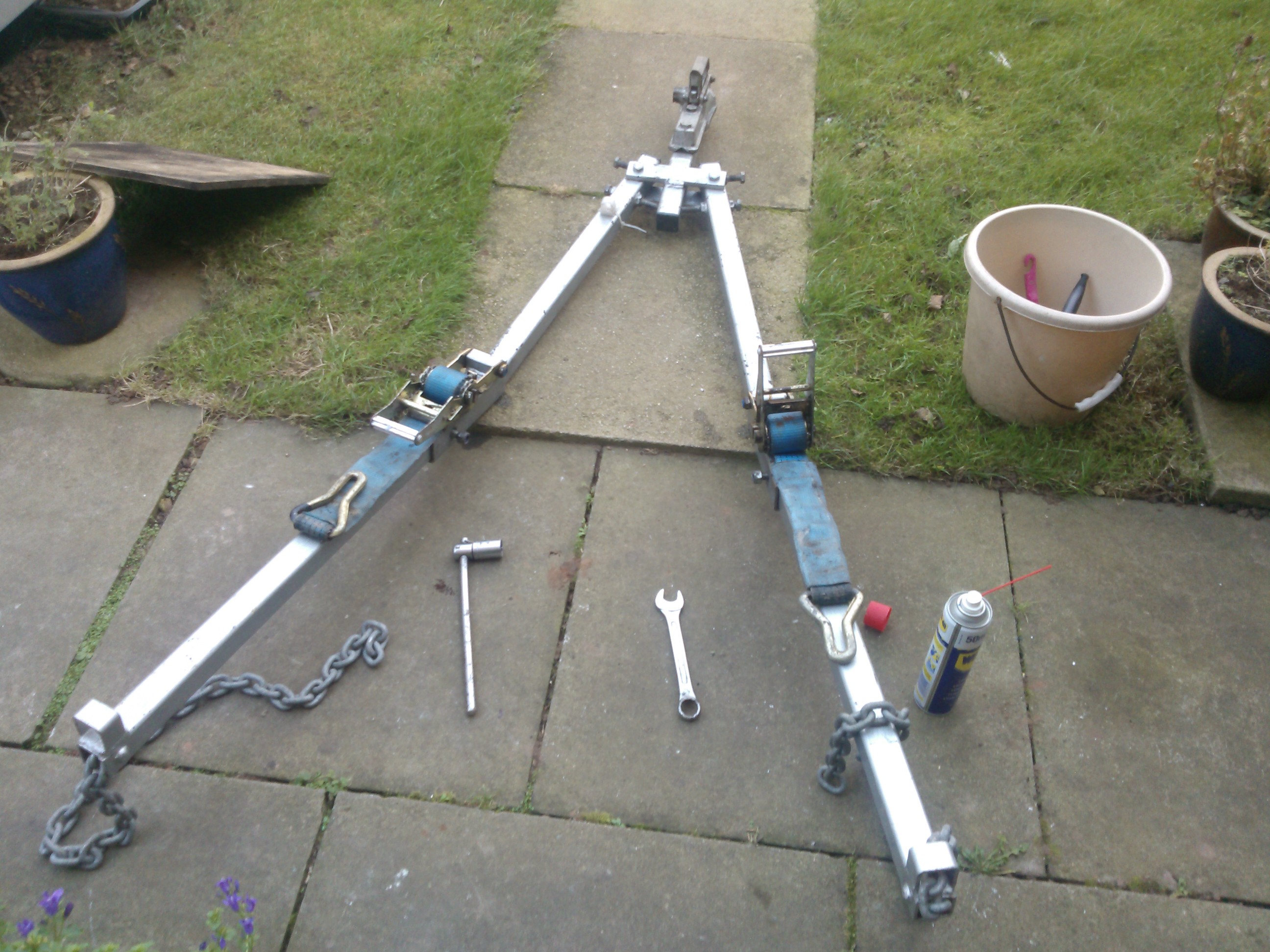

let me know height of your tow hitch - mine quite high on motor van
The highest point at the top of the "ball" is 18 inches above the ground level, is the frame any good at that height?

I'll check height of my hitch - if hitch is too high it could cause problems as arms won't go under and will be trying to lift front of car. You may need a dropper plate.

lightweightmick - I'll give a go with A frame if you will be that kind and have a look for the arms and straps, is the hinch high fine then?
Don't worry about the frame return to you, I'm more than a sure that i'll be traveling down along the M1 soonner or later to pick some bits.
Please let me know if you will be strugling to find the missing bits.
Bearing in mind my drive is uneven I get 14-15" to top of ball. Might be an idea to get a dropper plate just in case. (need 2 extra bolts then s well, but I may have some spare bolts)
Got arms out now and will make sure all necessary bolts are present.
You'll need a 19mm spanner to adjust the frame - though if I get time I'll set it up to correct Panda width for you - but it's going to fit in your car better without the arms - so the spanner will be needed once you get there.
PM me with details and I'll give you my phone no.
cheers
mick
:) - correction to above - 2*19mm (1 has to be open-ended for locknuts at hitch end). It's probably set too wide as shown here. Best place for chains is around inner end of track control arms. It took me about 15 mins to attach when I fetched Ruth. I stopped a few times to make sure ratchets were still nice and tight (and a good chance to make sure all lights are still working on tow board) (y)
