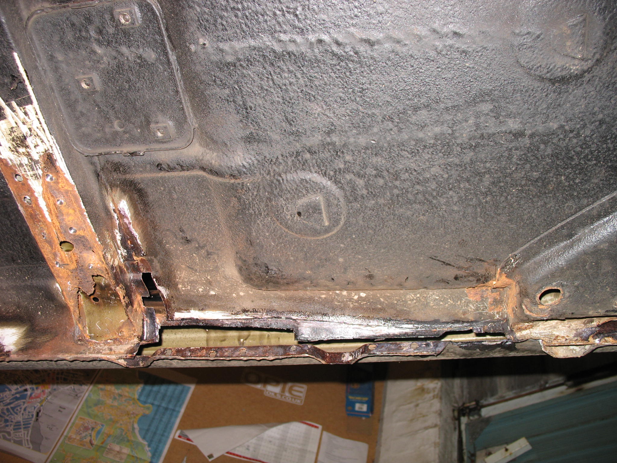

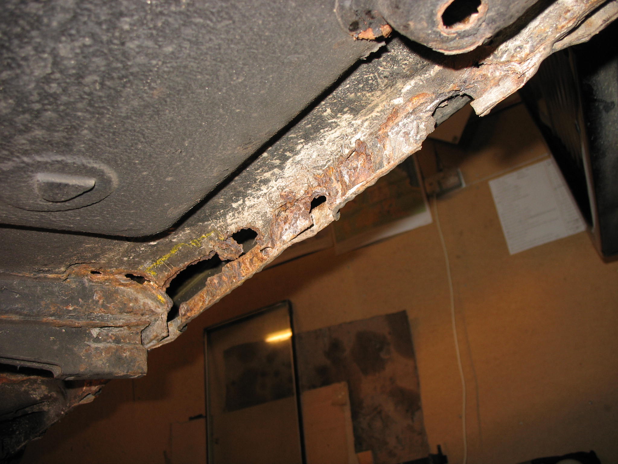

On the last MOT test this June I've been told by the tester that there is small rust hole at the inner sill/ floor recognized as an advisory.
So, lets have a closer look....
At that time I was aware of small (20mm) outer sill bottom edge flange missing, but I was wrong as that was not the only one rust point.

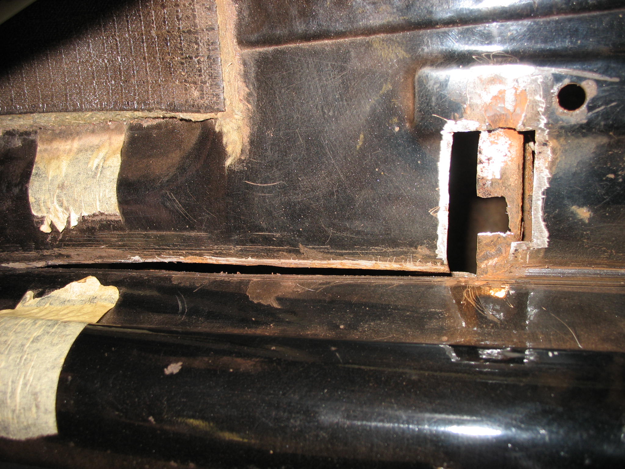

Thats how it looked like, the hole was enlarge by only using my fingers - yellow marking is still visible. After having a play with screwdriver and angle grinder - situation seams to be under control.
No, it's not.

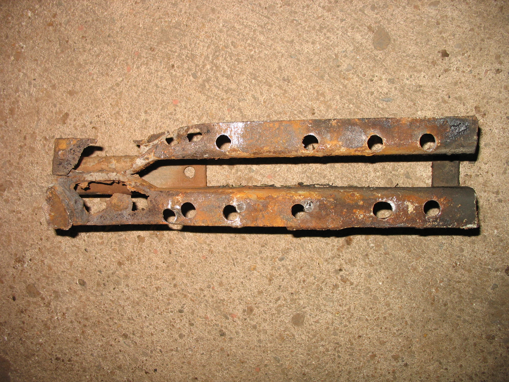

As you can see there is a right mess under the jacking point, and the far end of jacking point itself is badly corroded same as the cross membrane.
And the jacking point

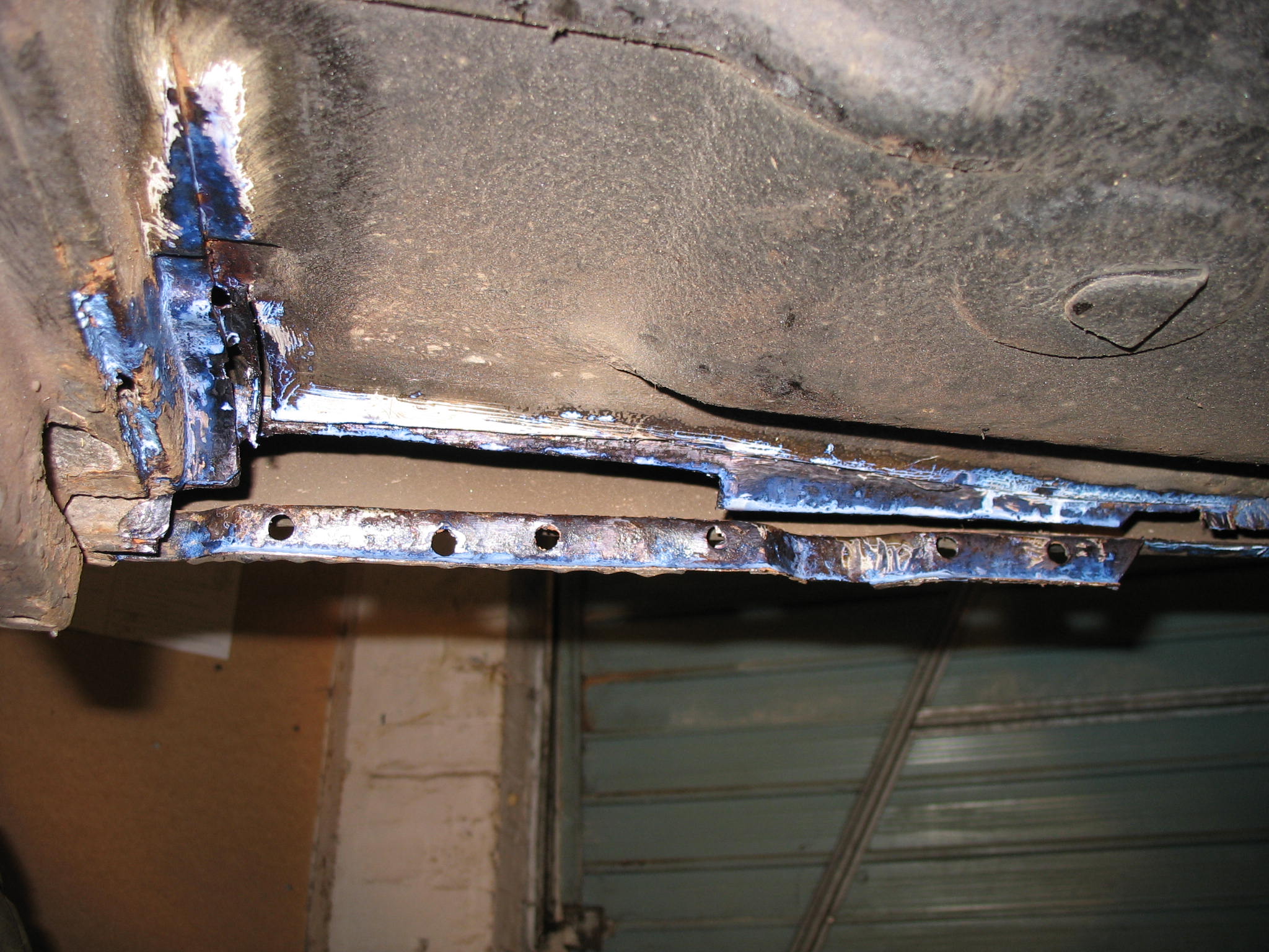

The following plan for is :
- cut the and of the membrane, to gain clear access to the floor and inner sill,
- repair floor and inner sill section under the membrane,
- weld in the rest of the floor and inner sill cut out,
- fabricate cross membrane section and weld it back in to original position,
- repair jacking point using 3mm thick steel,
- spot weld jacking point back to ori position,
- prepare surrounding area for stone chip paint, closed profile conservation, etc...
Now I'm after some 1.5mm steel sheet for the membrane rebuild, and 1-1.2mm for floor/sill.
Any suggestions, tips&trics are welcome.

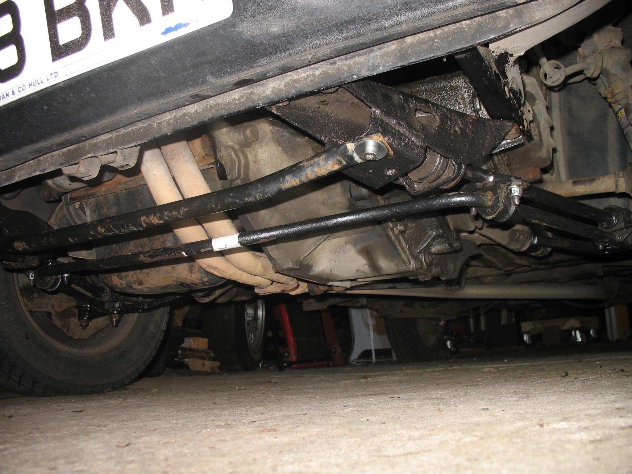

ARB is fitted and road tested, it does make massive difference. 45mph through tight shicane with marginal body roll. I love it.
It was part of parts hoard, and there is one more but no tie-rods.
Do you have the tie-rods John, all the other clamps can be sourced, bushes are universal but tie-rod are no longer available of Fiat and unique.

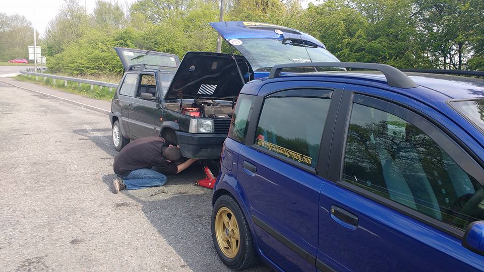

35miles to the destination so odd hight pitch noise suddennly started, no power loss, no misfire, noise was going quiet with cluch in - so my firs tought was - thrust bearing - I was still able to change gears and there was no hard soulder ( thanks to smart motorways) so i've decided to continue for two miles and stop just after leaving M42 at J3 towards A453. Midway to the traffic lights on the slip way engine staled.
Did not restart and from the sound of it it was more then a sure - Cam belt has gone!!
Still rolling i've manage to stop on the werge/hard shoulder just befor the red light - that was it - Sat morning, 200 miles away with nasty breakdown cover which would probably caused more stress and even more expensess.
So I've rung Jeni, to inform her that I'm not able to collect the parts, but me being 20 miles away from her place, had more lucky then ever.
Manage to push the car just round the corner to nearest lay-bay. After 40min Jeni arrived with hydraulick jack, set of tools for cambelt change and a brand new OE cam belt still in Fiat box. 15 minutes later both of us were on the way to pick the stuff. I was the luckies panda driver in UK at that time for sure.

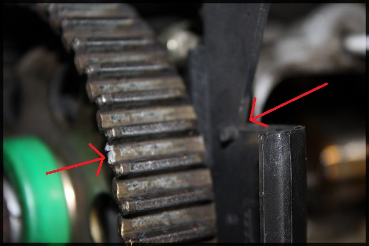

Just to add what was the reason behind the noise and resulting in such a fatal results?
The plastic mounting lug of the inspection flap was broken for some time.
I've tried to pack that up with washer to help the flap but this time the flap did let go and due to heat it became half open. It was probably just a matter of time for the bolt becoming lose. For so odd reason the bolt, spring washer and flat washer dropped in the cam belt cover down to crank pulley. Old cam belt had really rough edge and was 6mm narrower vs. new one.

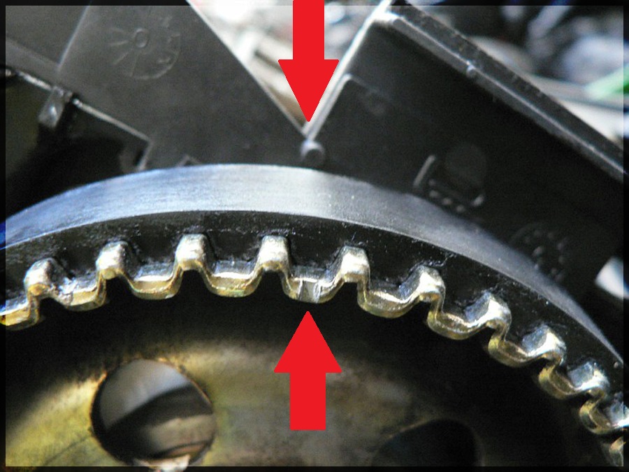

Ooooh yes please (y) Its not the fitting that worries me, its the making sure the timing it set correctly, all this line the marks up stuff, there's too many marks, which ones do I line up! :cry: :rolleyes:
Look I don't even own a Panda anymore and I'm still here asking for help and throwing threads off topic since 2012. You're welcome ;)

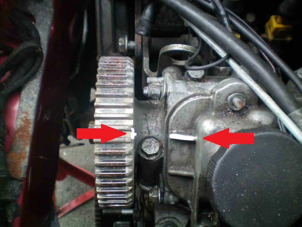

To keep the spirit of going off topic alive then...
turn with crank till these line up

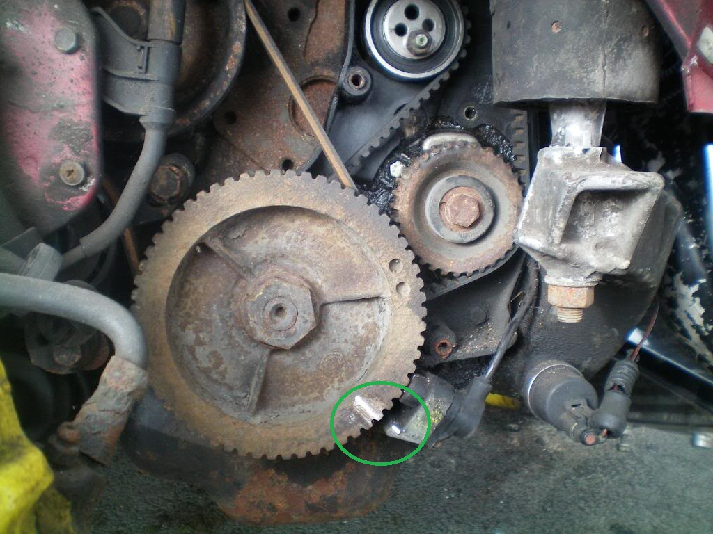

At the cam its should now be lined up like this

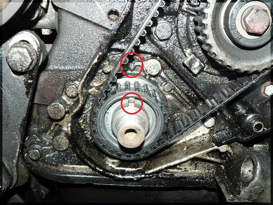

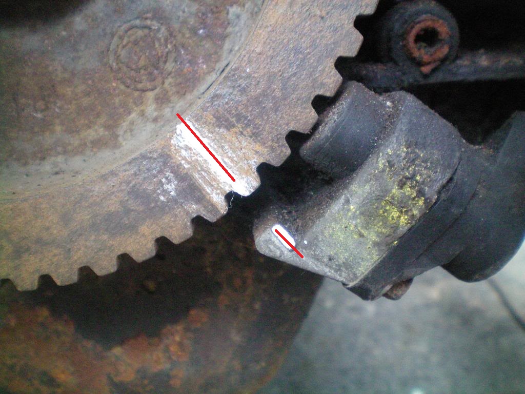

And if that bit of plastic has been removed then by these
Take off the crank pulley and these marks should be aligned
