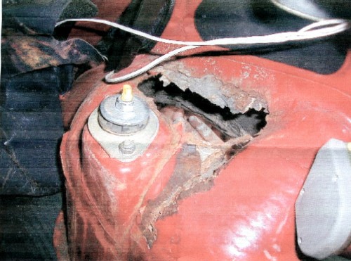

The most annoying thing is suspension strut towers are sooooooo immaculate! (pic below)
Where theres rust:
Sills
Front panel (Head lights mount onto, rad mounts onto, etc, etc)
Passenger floor has a hole in it! (pic below)
the rest of the car is not know yet but i still cant get hold of my mate who has had it for the last 7 years

That rust doesn't look too bad. You could see daylight through the arch on my old Mk1.
