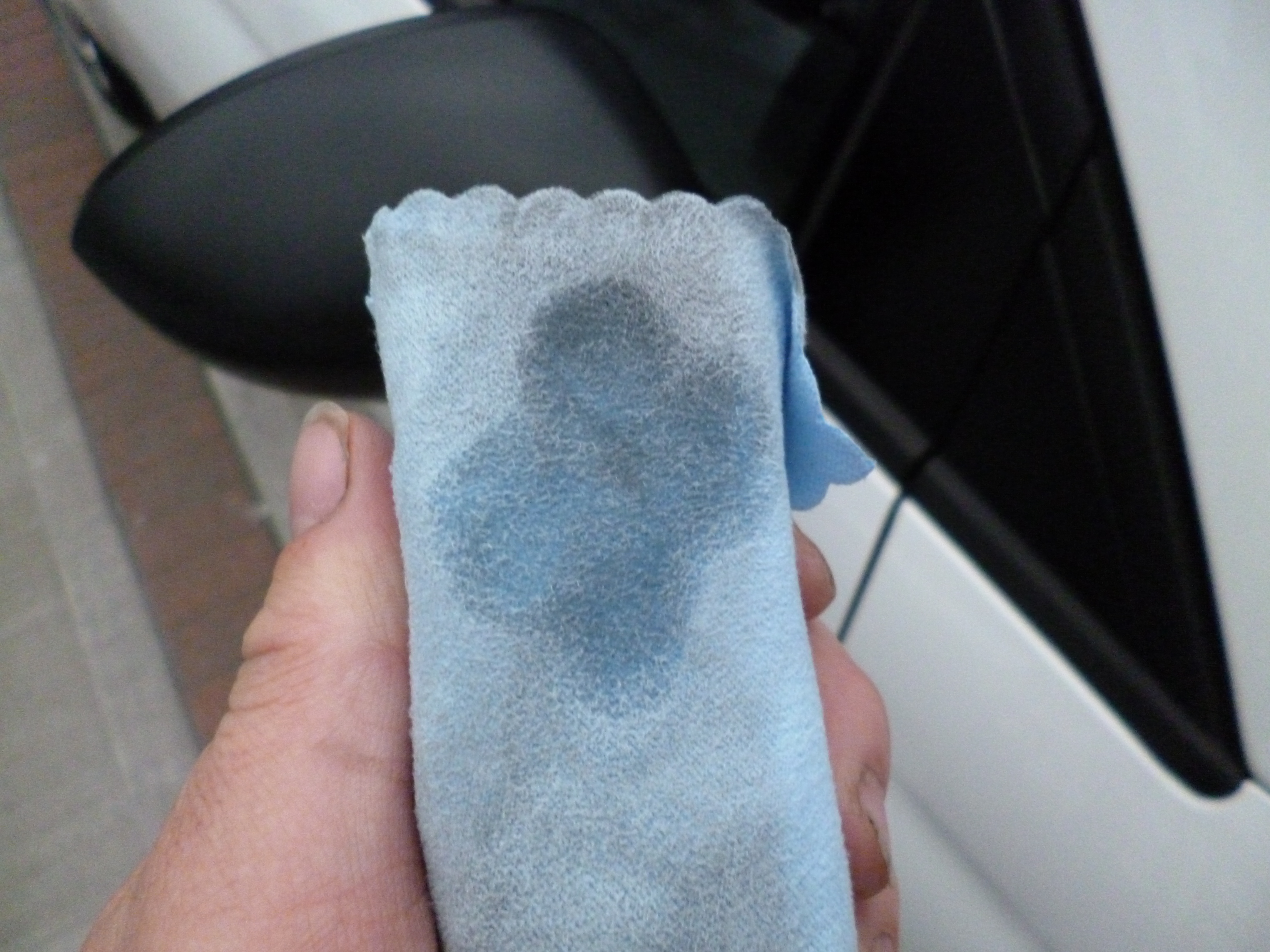

Now for buffing off its a strange product it depends on ambient temperature and humidity so a test swipe is needed the product should just turn tacky so it grabs the Microfibre cloth as you buff off the excess if its not tacky you will just re-spread it.. should only need a light buff.... times vary between 1 -10 mins dependent.... avoid contact with paintwork if you do buff it off immediately... And keep off glass at all costs...
once "dry" buff with a short pile microfibre to remove excess ((again bin it once you have finished))

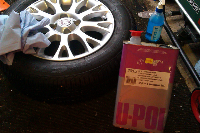

Then as an extra fail safe to ensure all remaing sealent was removed used a body shop solvent wipe and lots of blue roll do a small area then throw away so not to move the dissolved sealant round... (and polish residue if used)
Now the wheels should be squeaky clean
A wipe down with carpro Eraser

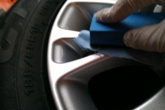

Now back on with the Nitrile gloves and out with the DLUX
Add a few drops to the applicator suede
and get applying might need to use the suede off the block for the intricate bits....
once applied leave for it to cure as with the plastic once it becomes grippy its time to buff it off lightly using a short piled microfibre cloth....
Now keep the alloy dry for one hour after one hour apply a thin coat of RELOAD and buff to a shine..

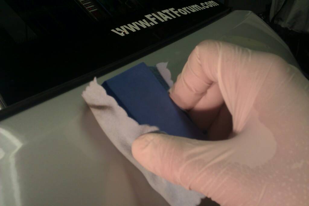

Its important once the buffing cloth has done several panels BIN IT as the buffed off residue builds up and can cause scratching as the remaining solvent turns to glass....
once all done check for any smears....
then wait one hour and apply reload..
then the car MUST be kept dry for 24 hours and no detergents used on the car for one week to allow the coating to fully cure and bond.......

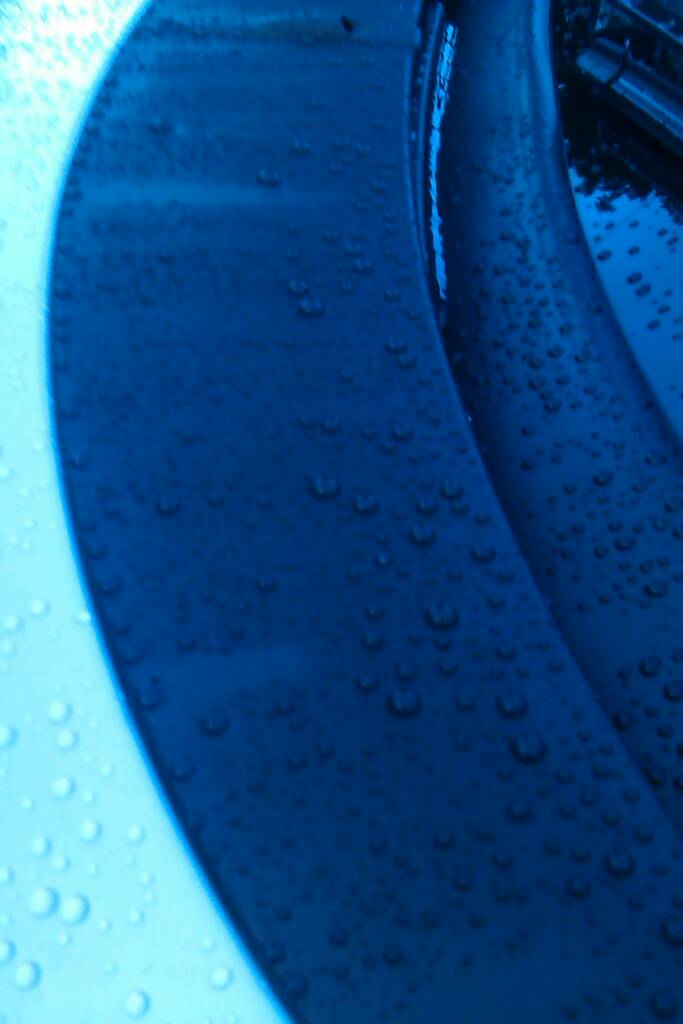

Well today i decided the coating is dead........
water just sat flat on the paintwork
black plastic trim gone the same dull gray it was before...
Im a tad disappointed for the cost of the stuff i expected more :( .

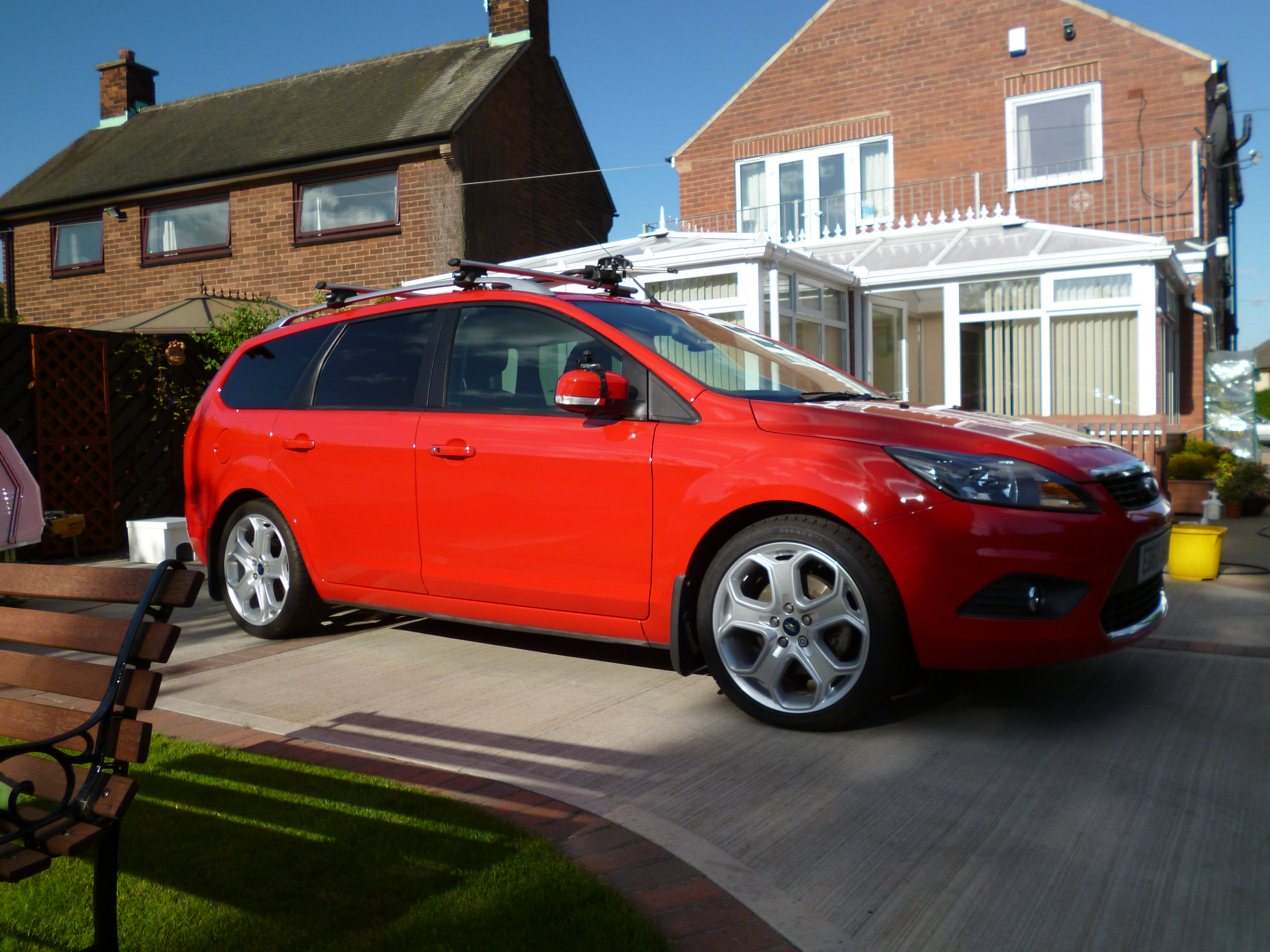

Dads Big RED focus with BIG alloys
which is holding up ok ish but it lives one week in the garage one week out as he car shares
