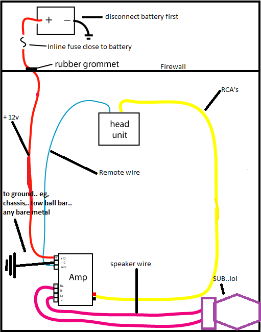

have you given it a switched live signal?
sorry i am really not technical like that haha, how would you do it? we checked that there was power using that device thing (lit up telling us there was power)
As Andy has said
Yes they may be a full circuit of power for the sub
However - they need a ""wake up / turn on / power up "" signal from the HU
Without this - the sub will stay idle
Also is it just a light tester? A multi-meter would be better it'd tell you if it was a decent signal or not
