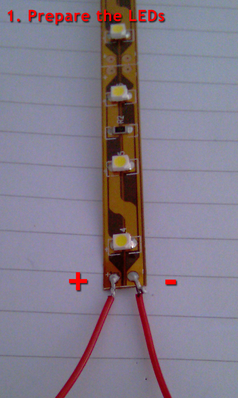

1. Prepare the LED Strips
These LED strips need to be soldered to the wire. You only need to do it at one end but they're quite small and fiddly to do. Each section comes pre-punched with small holes but they're not big enough to fit a wire through so I stuck a sewing needle through to make the hole wider and then soldered the wire on.
You'll need to attach around 3.2m of wire to each contact on the LED strip for the left of the car and 30cm to each contact on the LED strip for the right. (I'll show where the wire is routed further down so you can measure and make your own estimations).

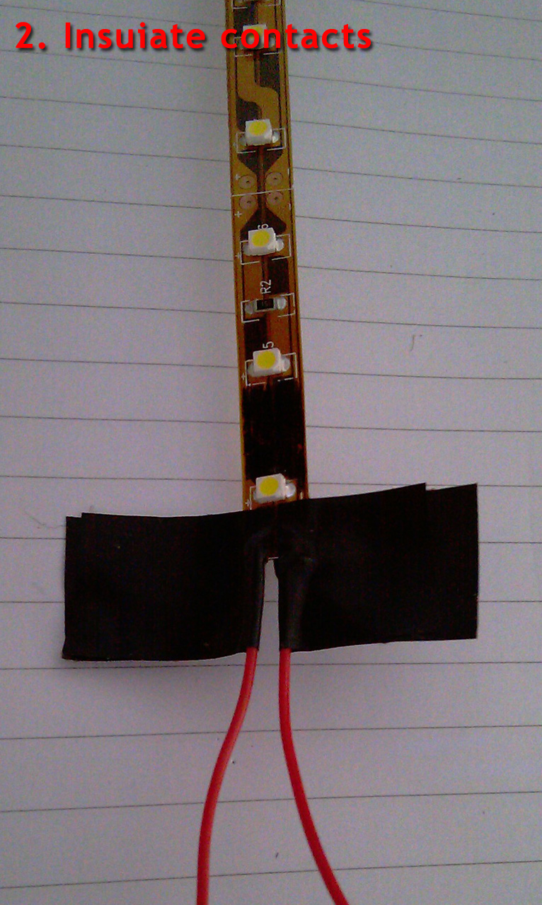

2. Insulate LED contacts
I then covered each side with insulation tape. Make a note of the + and - so you know which is live and ground (although with LEDs you're allowed a bit of trial and error because they don't die if you wire it up wrong).

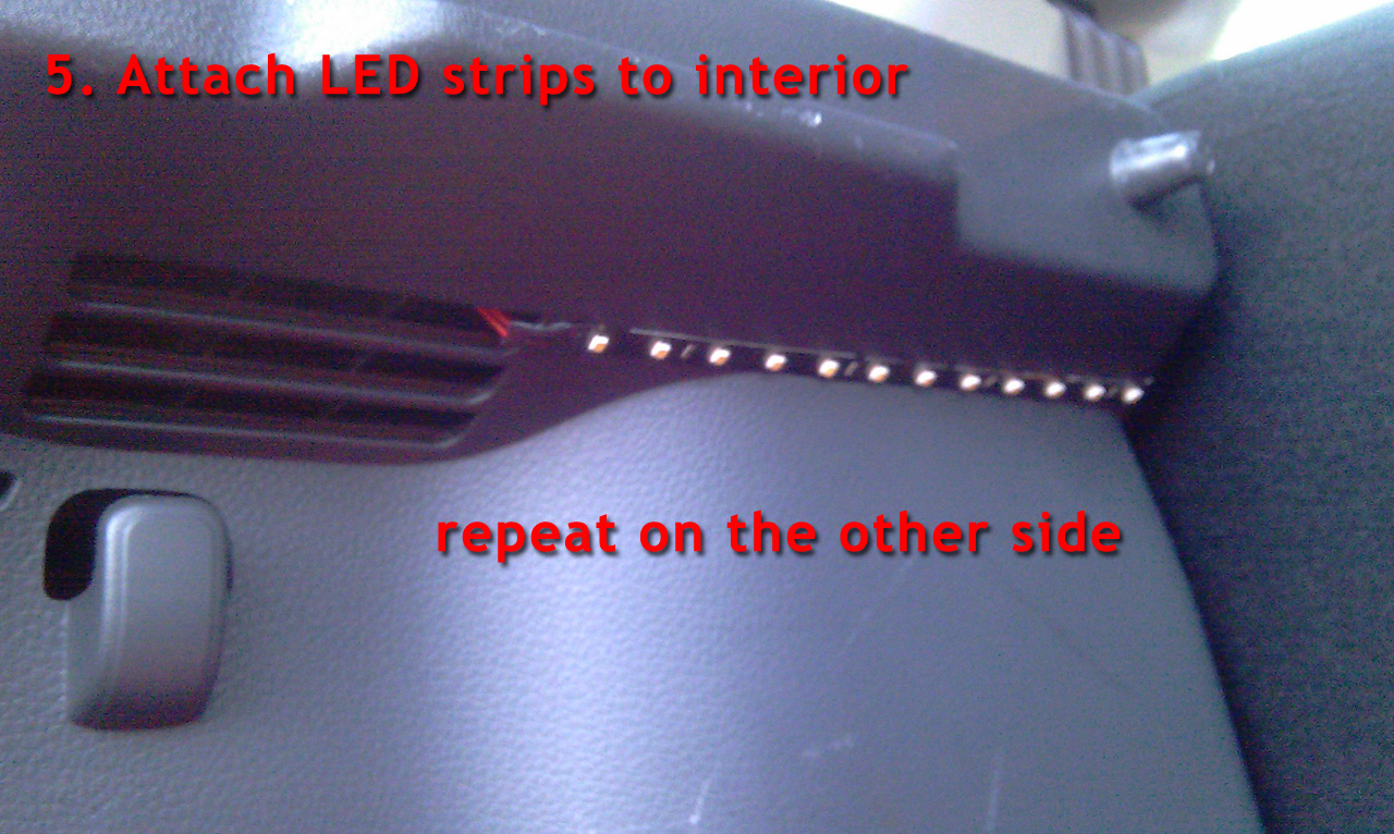

5. Stick both strips to the lip under the parcel shelf
I found two convenient places for the LED strips on a panel underneath the parcel shelf. Good for two reasons; when you're standing up the strip is out of sight, and it's in close proximity to some 'air vents' where you can route the wiring.

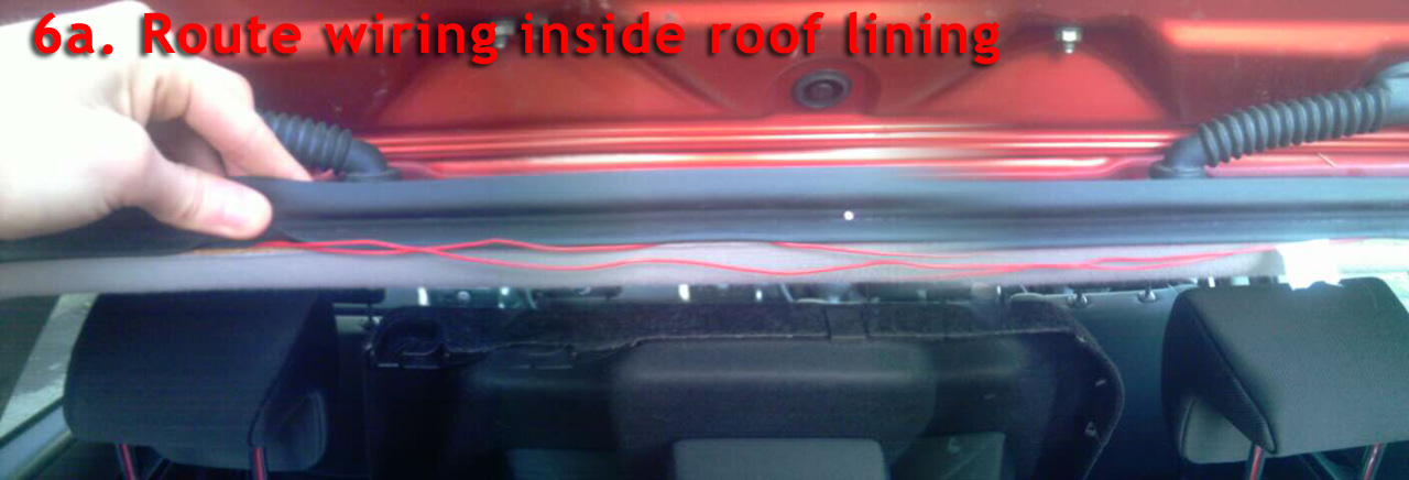

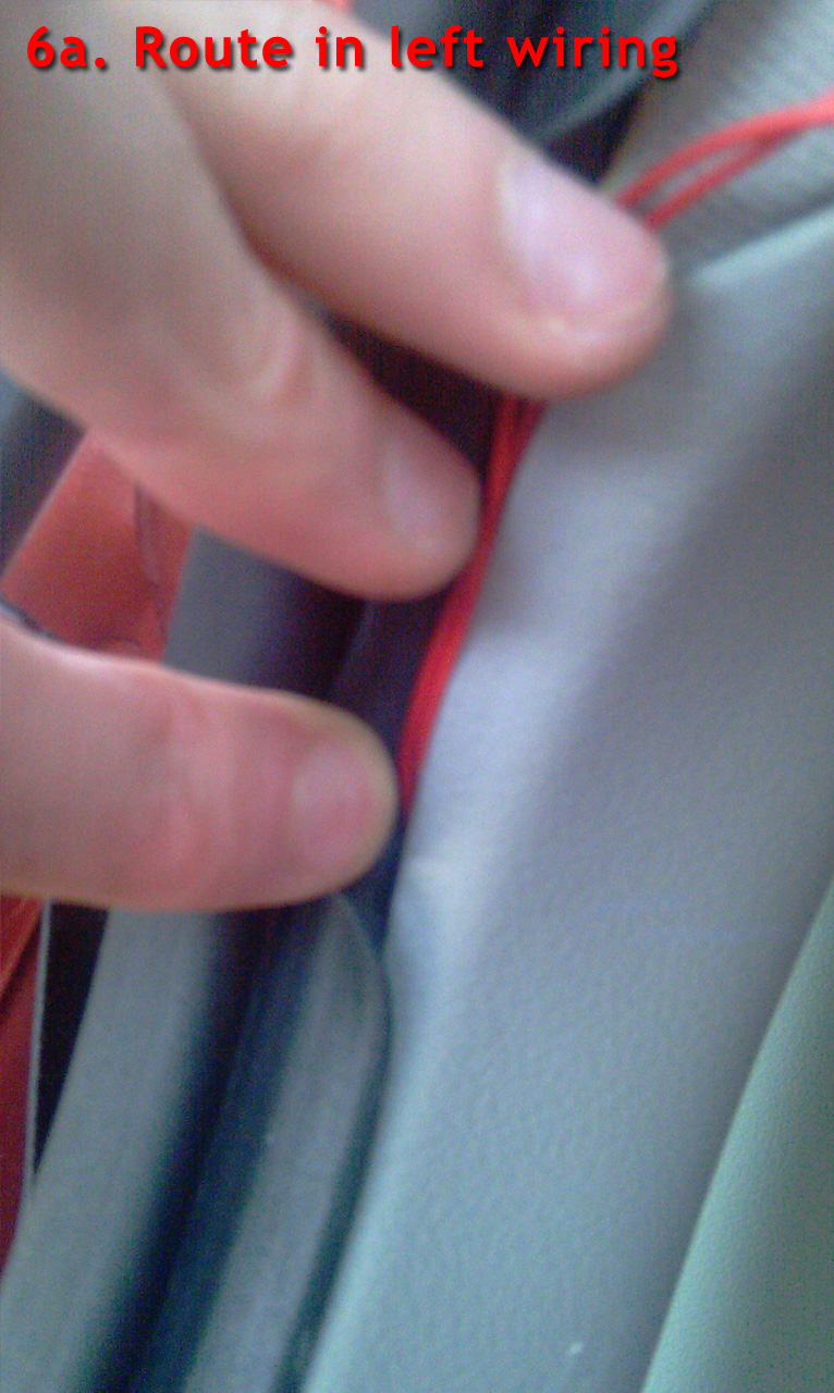

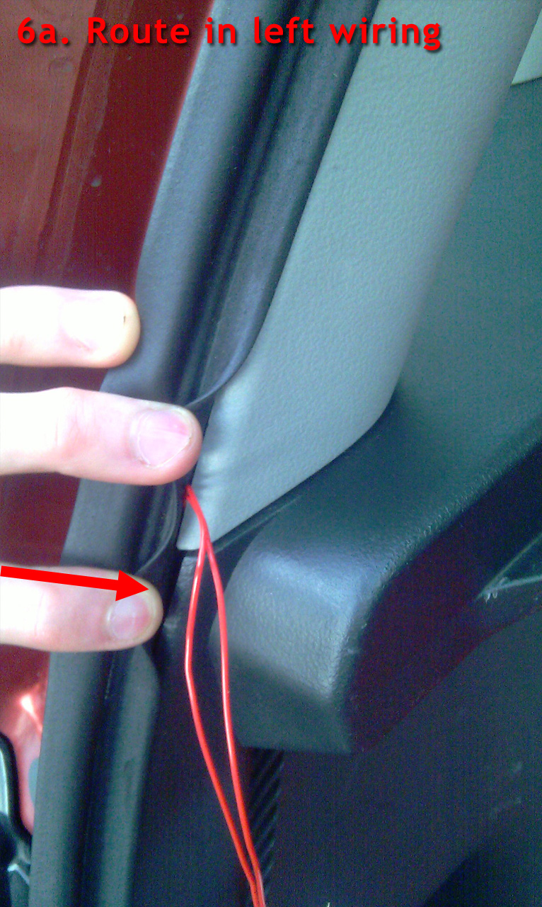

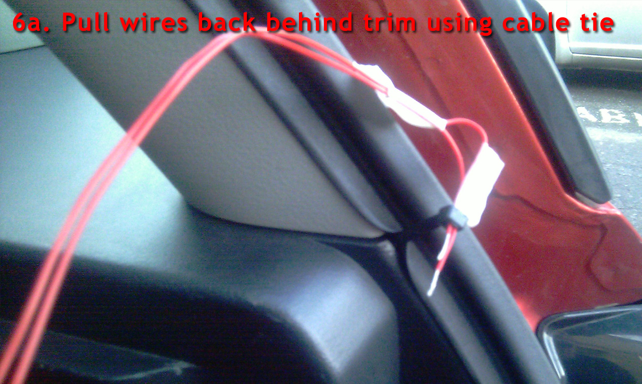

6a. Route in the left hand side wiring
I saw a few ways to get the wiring over to the right but the easiest and least destructive seems to be going around the top of the boot.
I stuck a rather large cable tie in through a gap in the trim and managed to get it to poke out the air vent. I attached the ends of the wires and pulled them through.
I then pushed the wires around the back of the cream panel, across the top behind the roof lining, back down behind the right side cream panel, and then reversed the cable tie process to get the wires into the back of the boot light area.
Be careful again with the interior plastic and make sure you put the rubber flaps back where they should be otherwise the boot might lose some water resistance. More importantly it makes it look crap.

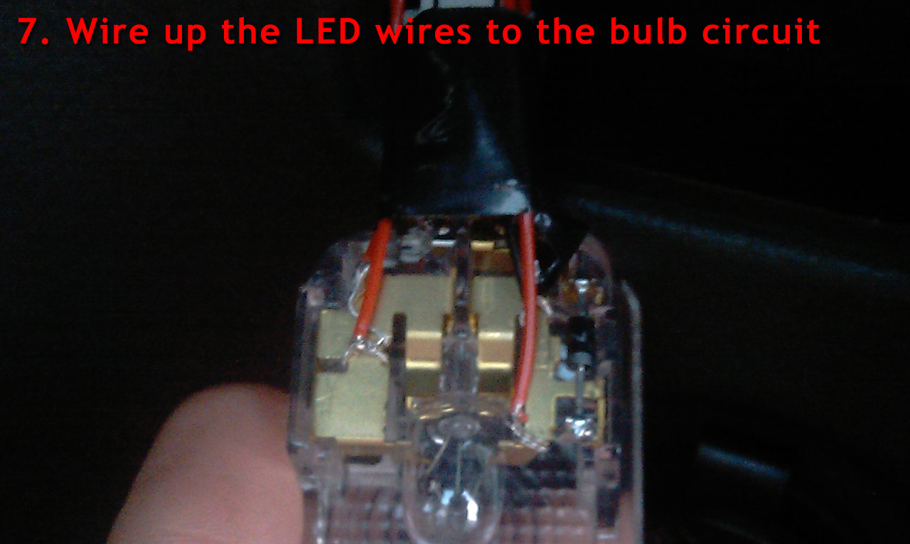

7. Attach the wiring to the boot light circuit
I did this in a few attempts so you'll be able to do it a lot tidier than me, but I essentially wrapped the ends around the contacts on each side of the bulb and insulation taped up. I'd have liked to solder them in properly but I don't have a portable one and I still see this as a trial so I can still easily rip it all out.
I attached the wires so that the LED circuit included the little switch for the boot light. This way you'll be able to switch off all the boot lighting with that switch.

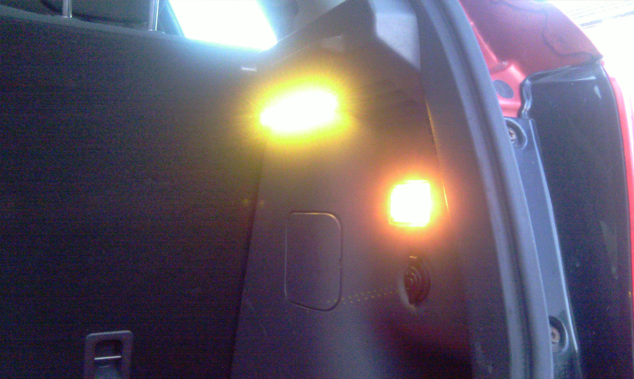

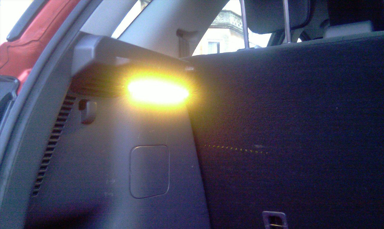

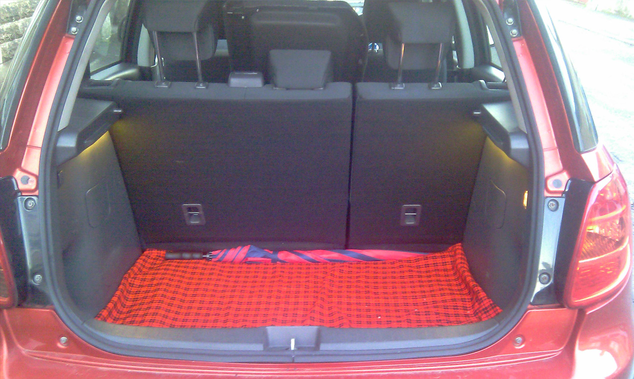

8. Stand back and admire your creation!
Thought i'd document this just incase someone else fancies doing it. I makes a lot of difference, especially if you do both sides.
Let me know what you think! Enjoy the Sedici Hack! Pictures attached!

Excellant work cmm (y) I was only thinking tonight as I loaded the wifes up about the poor light output.......
One thing though - that Boot is far too tidy lol
Thanks guys! Let's not get into my unhealthy obsession with things being tidy and if possible, all at right angles! Luckily I don't need to carry much around day to day and for work i use peli cases so it stays fairly clutter free. It only get's wrecked on beach weekends. There's a lot of sand in that boot!
Have just looked back at the install and think i've been quite conservative with the number of LEDs. Reckon you could squeeze a few more in on each side, but even as it is makes a noticeable but not garish difference.
Let me know if you decide to do it!
